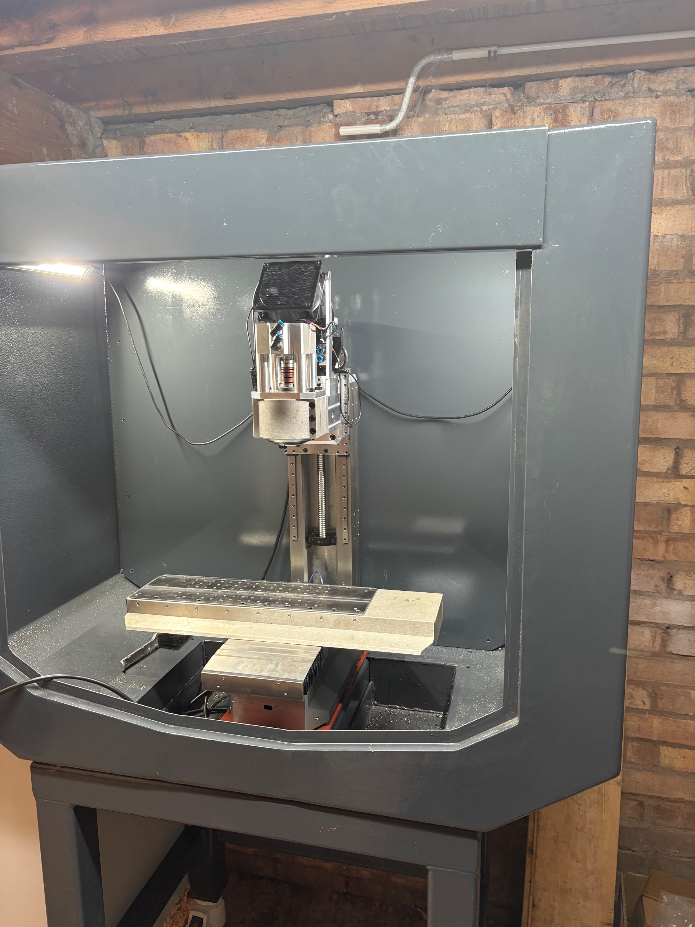

Hi all,For context: I'm currently building the control system for a Samurai 120 CNC machine (please see the attached photo).Machine electronic hardware configuration:

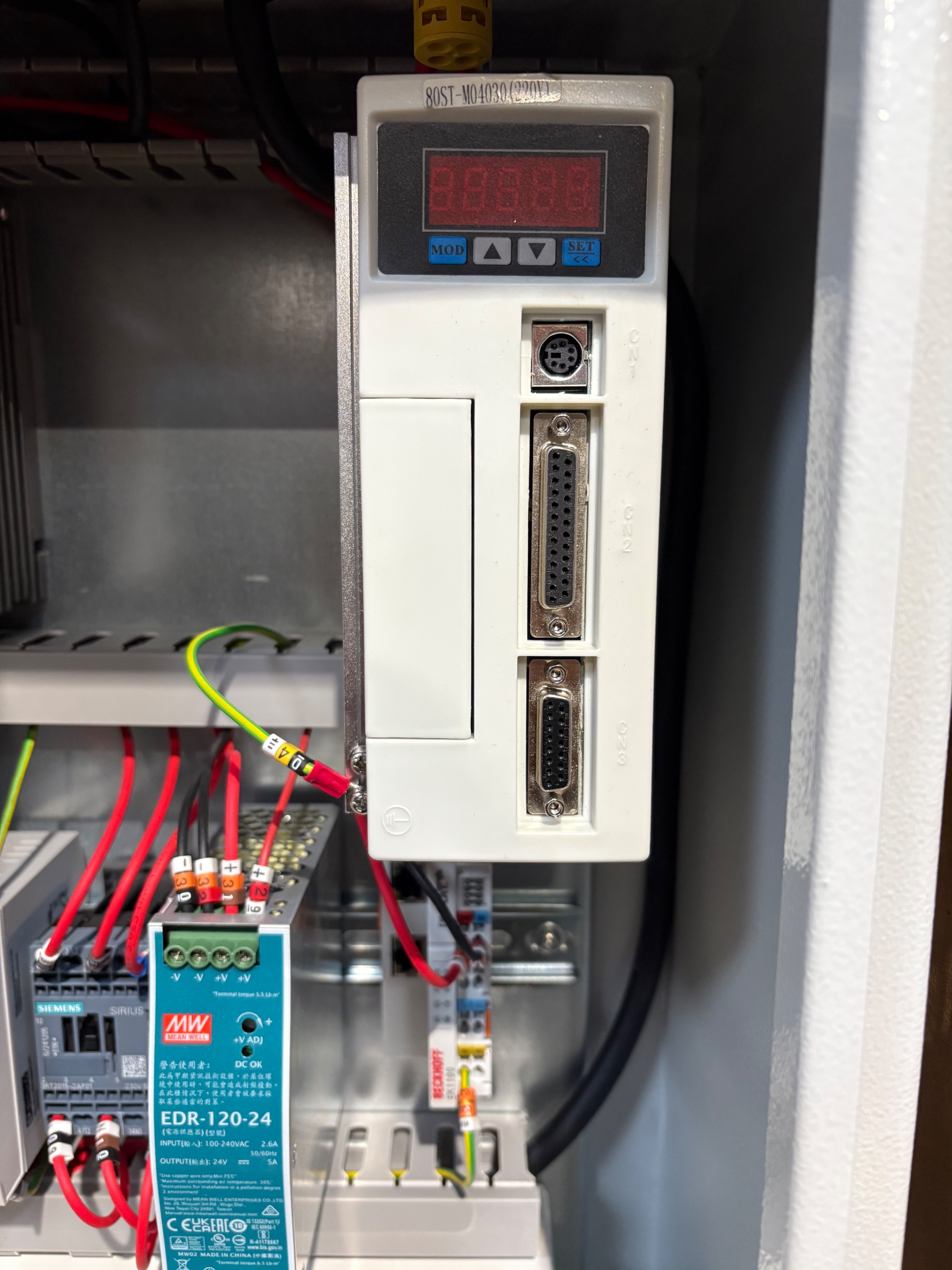

Hi Shemj,Thank you so much for your help with getting the EtherCAT drives set up! Following your guide, I’ve successfully managed to connect all three drives, and they’re now running with the Probe Basic interface. The only step left is calibrating them to get the correct mm/rev on each axis.I’d really appreciate some suggestions on how to connect the spindle drive:
  • Current setup:
    • The machine’s three axes are using EtherCAT, connected through a daisy chain of Ethernet cables.
    • The spindle came with a 1.2 kW generic Chinese servo motor and drive, which has a 15-pin RS-232 serial connector.
  • Questions/options I’m exploring:
    1. Using Beckhoff hardware:
      • I have a Beckhoff EK1100. Could this be used with the appropriate module to control the spindle servo drive?
    2. Using a Mesa board:
      • Would connecting a Mesa board to the Pi via a USB-to-Ethernet adapter work, or would that introduce unnecessary complications?
    3. Alternative hardware setup:
      • Replace the Pi 5 with something like an Odroid H4 (dual Ethernet ports). That way one port could handle the Mesa board and the other the EtherCAT drives.
    4. Replacing the spindle drive:
      • The supplied spindle drive is an XCSD-20A from cncservocontrol.com. Are there any EtherCAT-compatible alternatives that would work with my motor?
  • Motor details:
    • Model: 80ST-M04030LBP
    • Power: 1.2 kW
    • Current: 5.2 A
    • Voltage: 220 V
    • Torque: 4.0 N·m
    • Speed: 3000 rpm
    • Encoder: 2500 PPR
If anyone has advice or suggestions on the best approach to integrate the spindle motor/drive, I’d be very grateful!

12 Sep 2025 08:34 #334870 by Hakan
I used a servo motor and that type of servo drive for the spindle motor of my lathe.
It is not ideal. The thing is that linuxcnc just sets a spindle speed and the servo motor
does a really quick acceleration to get to that speed. There is no ramping up/ramping down
like an axis motion.  Someone of course solved that, just didn't know about it forum.linuxcnc.org/10-advanced-configura...op-on-m-stop-command
Controlled by analog +- 10V, Beckhoff has many EtherCAT modules for that, EL4xxx series.
Mesa and EtherCAT works well together on different network adapters. Not USB network adapter, USB isn't real-time.
There are many N150 with multiple adapters, and the Odroid H4 plus isn't a bad choice either. If you can choose, choose an Intel network adapter.
EL4xx or Mesa + other computer or EtherCAT servo drive.
Your motor is a very common motor so any EtherCAT servo drive of the right size should in principle work. Ask seller though.
You do want a drive with the PV mode (Profile Velocity). That way the drive will be able to ramp up and down
the rotational speed in a controlled way.

Thank you for the suggestions on what to use for the spindle motor. For now, I’ve replaced the spindle motor with another servo motor that is CiA402 compliant. I haven’t set it up yet, as I’ve been building an enclosure to suit and recently started back at university. Disclaimer: The machine has been set up using the instructions kindly shared by Shemj. Probe Basic Machine Interface Issues 1. Unable to home the machine
When I try to use the on-screen buttons to either home the machine or move to the work zero position, nothing happens. Is there something I might be missing in the setup?
this could be to do with the always_homed  and  homecomp files ? 2. Machine losing position after power-off
When I power off the controller and machine, I expect it to retain its position thanks to the battery backup on the drives. However, when I power it back on, each axis resets to zero instead of remembering its last position. Could this be related to the homing module setup?
3. Lack of continuous jogging in Probe Basic
In other interfaces, there’s an option to jog either continuously or incrementally. Does Probe Basic only support incremental jogging, or is there a way to enable continuous jogging that I’ve overlooked?
Thanks will
Photo:
Here’s a photo showing the start of the enclosure build — it’s still a work in progress.

Very nice enclosure!
I am also building a Samurai 120 with Leadshine EL8's and LinuxCNC.
My own enclosure is made from aluminium extrusions and is nowhere near as nice as yours.
My solution to the spindle drive problem has been to use a Leadshine EL8-1000 drive and a Leadshine ELM2-1000 motor for the spindle, replacing the original motor and drive. The new drive and motor are 1000W instead of the 1200W of the original Samurai but the motor is a straight drop-in replacement (same mounting holes and hardware, slightly shorter motor overall) and seems both very well built and with a decent overload margin so I suspect the final performance will be very close if not the same, and sticking with EL8's throughout means only one learning curve for manufacturer quirks etc.
When you do that, the same Marco Reps LinuxCNC servo scheme works for driving the spindle, except that the EL8 settings are slightly different to his Metronix spindle settings (for example Leadshine does in PDO idx 1601 a lot of what Metronix does in PDO idx 1600). You also need to factor in the belt ratio from motor to spindle to get the right RPM.
