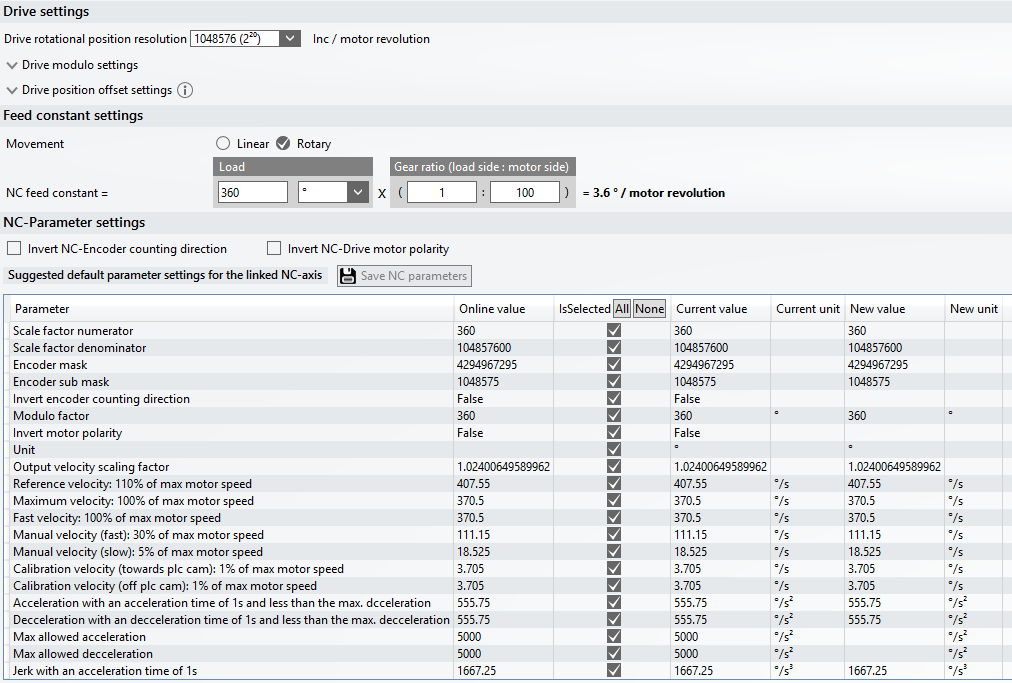

Hi everyone,
I seek help in commissioning a Motor with a Beckhoff Ax5000 series drive within TwinCAT to then transfer that tested setup to linuxcnc-ethercat. I cannot for the life of me get that motor to run over.
Setup:
Motor: HarmonicDrive LynxDrive-20C-100-MEE-AO (reduction 100, MEE Encoder (Heidenhain EQN-1125 Endat 2.2/2.1), motor values are known, commutation unknown)
Driver: Beckhoff AX5206-0000-0203 Fw 1.06
Goal: Be bale to move the drive from NC in Twincat to check for functionality of the setup
What did I try:
- Scan Bus in TwinCat to find devices
- Found the Driver
- Setup of power management, safety (off), set mode for channel 1 to position control
- Setup Channel 1: X11 for encoder connector, selected Heidenhain EQN1125 from list, manually setup the motor with relevant values (pdf: harmonicdrive.de/fileadmin/user_upload/E...8856_08_2018_V04.pdf, page 17)
    When I try to scan for the encoder it identifies as Endat 2.2 without a nameplate. However, when selecting an Endat2.2 from the list of encoders, it does not work. (0xF148: Build drive system: unknown feedback system)
    Question: I assumed that this table takes the values for the motor and not for the output shaft (which is behind the harmonic drive's reduction), correct?

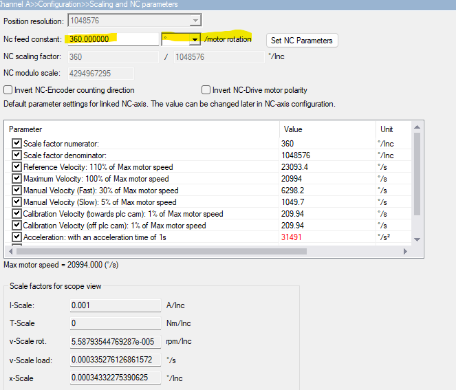

- Setup of scaling
     Question:  Here I am not sure. To me it makes the most sense to set this up for the motor shaft (as this is where the encoder is). I.e. 360°/motor revolution (see screenshot) - correct?

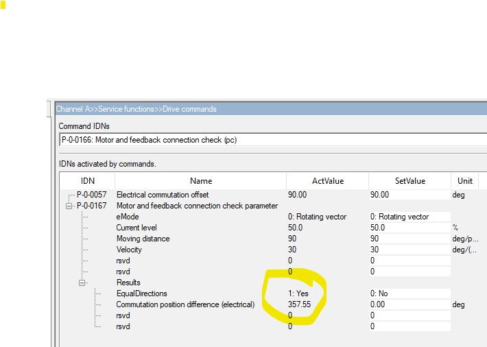

I tried to follow page 168ff using P-0-0166:
I get values after starting the command, with equal directions being "No". Changing U and V accordingly changes direction of the motor, but has no effect. I cannot get a constant value. I keep chasing my tail around.
Note: At this point P-0-0150 Commutation Node is set to 3; Adjustable commutation offset (mechanical) is 0 deg
I then followed chapter
Manual 9.6 list commutation methods (p 201ff)
Accordinglx, P-0-0160 is executed first
Regardless of the actual value of P-0-00578 (Electrical commutation offset) I get a value for the mechanical commutation offset which I enter in P-0-0150 above.
Doing so, an flipping the polarity of UV, I then get the following result for P-0-0166: Equal Directions: yes; Offset: 357.55 deg
I do not understand what way is the correct way. Accordingly, I am not sure if the offset is correct.

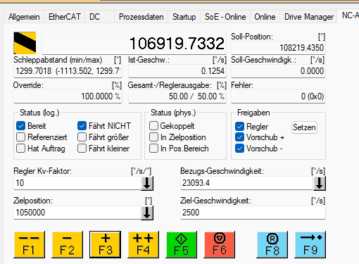

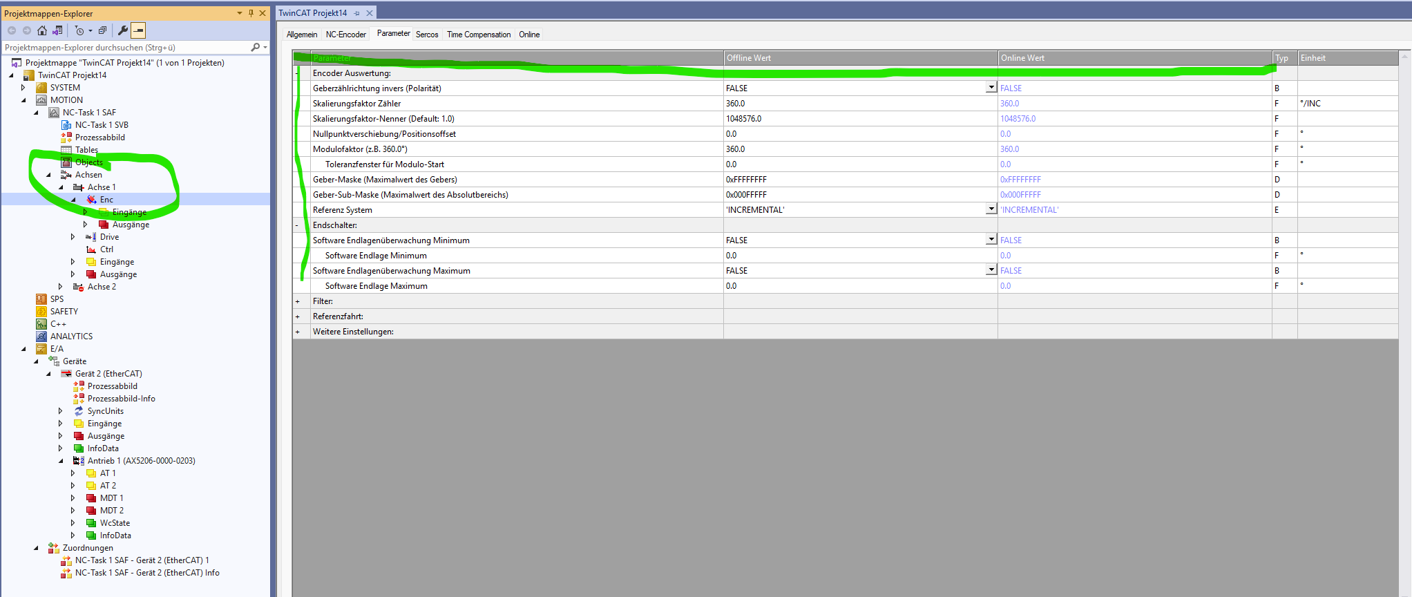

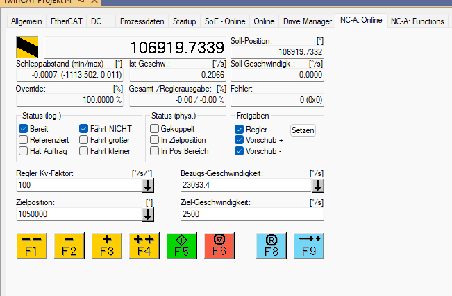

Now I undertand I should be able to move th eaxis using NC-A: Online (image 3)
I can enable the drive and it does start to make light noises and one can feel light vibration on the output shaft.
However, when I send a command using F2/F3 I get an increase in following error and nothing moves. (Image 4).
Parameters of the axis enc are as indicated by image 5.
I assume something in scaling is borked and thus the PID cant work properly. But I cannot find anything that is missing.

22 Jul 2025 09:38 #332165 by endian
If you need startup jogging and you need to tune the servo ... you need to turn off Lag monitor under the  Axis X.. Parameter ... Monitoring: Position Lag Monitor = False ...
If you have reduction factor ... you will determine it in the nominator and denominator rows somewhere in the drive manager ...
Yes one motor revolution == one encoder revolution ..
Yes HD should reverse you motion .. every odd
This setting you generally free enable movement... next tune or you will need firmware update to start autotunnig the servo system ..

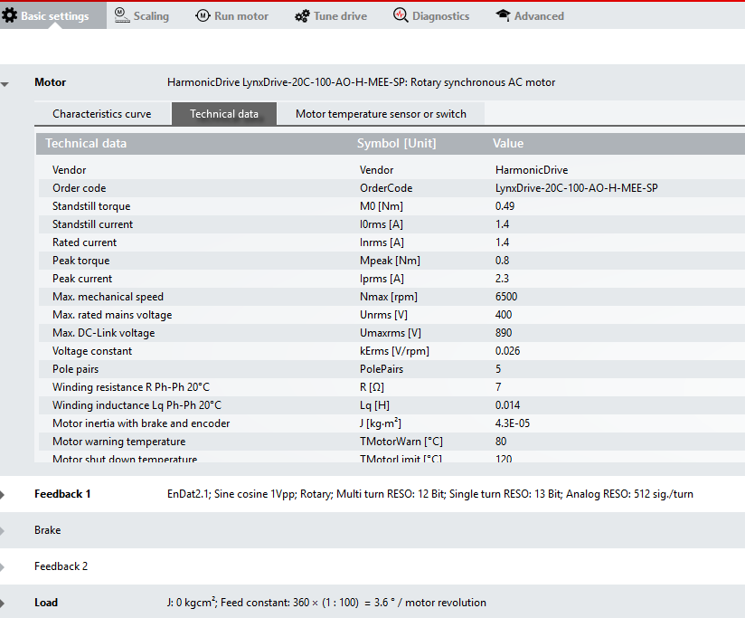

28 Jul 2025 14:20 #332475 by GuiHue
To be honest, I was unable to follow you along. "every odd" ?
I have since made some progress. After moving to Firmware 2.10 and hence Drive Manager 2, I managed to get a setup going, that allows me to enable move CW and CCW. However, scaling is way off.
Sending a move of 5° results in roughly 375-390° on the output side.
Any ideas?

29 Jul 2025 12:41 #332517 by GuiHue
In a rather unfortunate and quite embarrassing turn of events: The actual gearbox section was missing from that drive without anyone noticing. Turns just fine now;).
