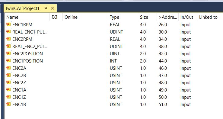

Hi there,
I made a new ethercat slave device, that you can connect any incremental encoder to ethercat network,
you can watch its video;
Everything is ok with Twincat, I can read A B Z pin situations, encoder puls register (s32), encoder rpm value (real)
But in HAL, I cant get ENC2RPM value correctly, it shows irrelevant numbers,
in xml file there is;
Main question;
what should be the halType for a variable that can read successfully in Twincat (REAL)
Slave devices ethercat xml command output is here;
<pdoEntry idx="0006" subIdx="01" bitLen="32" halPin="ENC2RPM" halType="float" />Main question;

Replied by Hakan on topic New EtherCAT Slave Devices REAL data to HAL
halType="float-ieee" matches REAL type
Cool board, is there IO on the board as well?
I see you have this in the ESI fileYou might have a mixup on names, ESI file says ENC2RPM is at 0x0006:03
They are also specified here as UINT32. And you say float (Ethercat REAL type).
This doesn't match.
Make the datatype REAL for this variable, read it as a float in the processor and as float-ieee in hal (gous into a float type hal variable)

13 Aug 2025 09:00 #333335
by emresensoy
Replied by emresensoy on topic New EtherCAT Slave Devices REAL data to HAL
Dear Hakan,
thank you very much,
Now everything is ok, and works good,

14 Aug 2025 13:08 #333432
by emresensoy
I also checked the XML files, they are REAL too,
But output of ethercat xml command, it seems like UINT32, I dont know why,
By the way, I am planning to sell the boards via ebay, and the Turkish local market via n11.com
there is 3. board, it can control 4x RC servo motor, actually it has 4x isolated PWM output,
as you can see, in the twincat ENC1RPM and ENC2RPM is REAL,
They are also specified here as UINT32. And you say float (Ethercat REAL type). This doesn't match. Make the datatype REAL for this variable, read it as a float in the processor and as float-ieee in hal (gous into a float type hal variable)
I would look at the datatypes in the MCU and make sure they are right there.
Linuxcnc reads out this info from the board/mcu.
Can't see from the video but looks like LAN9252 plus mcu.
Then this info comes from the mcu, not the eeprom or esi file.
