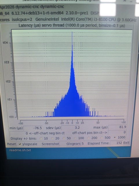

Thought I'd ask here. User has upgraded from Debian 10 to latest Debian 13.3 and 2.10pre RIP config. Now Running grandixximos Ethercat driver but have not set syncToRefClock yet.
He reports:
With the same xml file, i/o and drive configuration, Debian 10 kernel 4.19 with ethercat 1.5.2 works fine, it has no latency at boot and hasn't given any problems. The current system has kernel 6.12 with ethercat 1.6.9 and has synchronization problems at boot, sometimes it doesn't see some drives on the bus, I'm forced to turn it off and on again. Would it be possible to use the current 6.12 kernel and linuxcnc 2.10, with ethercat 1.5.2?
I copied the lcec_conf and lcec.so files into the respective bin and rtailib folders from the Debian 10 version that I have and which works well on my machines, with linuxcnc 2.9.0 pre1 and etherrcat 1.5.2. At boot time, the drives are now seen within 1-2 seconds of booting and are always found on the bus.
This has 5 axis servos and a few Beckhoff modules attached to EK1100
Next step is to add syncToRefClock
It seems odd to me that today's Ethercat hal driver is not performing but rolling back to an older version of it works. It seems to me his problem is the driver, not the version of Ethercat.
Any ideas or advice?

It gets worse and I've been pondering the next step.: "The machine is unusable; the axes shake and make a lot of noise. I tried rebooting and changing the refclock settings from -1 to values of 1 or 1000, but to no avail. The PC has an Intel NIC, but, as I said, the hardware and software are identical to Debian 10. At this point, I don't know what to do. The problem is EtherCAT."
The customer would like to try Ethercat 1.52 from his Debian 10 days but I don't think it will run on later kernels
The current Debian 10 Ethercat version on their repos is 1.62, Debian 12 and Debian 13 is 1.69 with no other earlier versions published. Latency is OK but not great for a 4 core machine
The only thing I can think of is to roll back to Debian 12. Any other ideas?

Good morning everyone. We're running some tests with Rodw on a Debian Trixie system, kernel 6.12.74-rt, and ethercat 1.6.9.
Just to be fair, we're using the same configuration on real machines, so motors connected to lead screws, running Debian 10, kernel 4.19.0-27-rt, ethercat 1.5.2, and linuxcnc 2.9.0-pre1. So, with Debian 10, the machines work without problems. When I first start up, the drives and all ethercat I/O are immediately visible, meaning, for example, the positions of the absolute encoders for the motors appear instantly upon startup.
With Debian Trixie, we're having two problems. A less serious one, that is, at startup, the motor encoders' values appear late, the first drive starting to appear after about a second (x axis), after another second Y appears and after that Z appears. But the most serious problem is that if you run the machine, the axes shake, then they stop shaking, then the vibration comes back and everything gets worse if I move windows on the desktop. Rodw has already attached the latency test on the matter, but I repeat, the PC is always the same and all the i/o and xml files are the same. Now I tried to copy from Debian 10 the bin/lcec_conf and rtlib/lcec.so files into the respective directories of Debian Trixie, without result, same problem. We tried to copy the same files from a version with the Grandixxximo patch, same problem, I also tried to vary the lcec.0.pll-drift pin, with values from 10 to 1000 without solving. Honestly, I don't I know what to do. I'm attaching the XML files I use on Debian 10 and Trixie.
