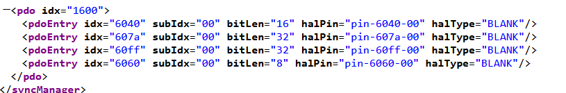

So i have created my XML and a halfile which i think has some problems but i cant seem to get it to load i have attached the report and all my configs

Are you sure that is the correct path to the xml file?
Replied by tommylight on topic Stepperonline Y series/ YAKO YKD2608PE configuration
loadusr -W lcec_conf /home/pi/linuxcnc/configs/sim.qtdragon.qtdragon_multi_joint/ethercat-conf.xmlPlease Log in or Create an account to join the conversation.

Replied by Hakan on topic Stepperonline Y series/ YAKO YKD2608PE configuration
That seems to be ok.
The error message is in the output from the linuxcnc command
And if you look in the ethercat-conf.xml you find the word BLANK
In place of BLANK there should be one of the hal types u32, s32, float-ieee, bit.
Have a look at the ethercat-conf.xml in this example I often refer to
github.com/dbraun1981/hal-cia402/tree/main/example
Modify both the halType and the halPin .
This example also shows how you use the cia402 component to
connect the servo drives to the joints.

Replied by rodw on topic Stepperonline Y series/ YAKO YKD2608PE configuration
the pin names in your XML are what are used in hal. Yours are completely different so it won't work. Bring them into line.

Replied by IndeeSales on topic Stepperonline Y series/ YAKO YKD2608PE configuration
Okay first of all thank you for all your help with this, I am very new to this and have watched countless hours of youtube on ethercat and a having a hard time finding solutions to errors. I have another error
Failed to register PDO entry: No such file or directory
LCEC: master 0 PDO entry registration failed
I want to thank everyone again for the help, I had lost hope on my project until now.
Let's see what the EtherCAT master writes in the syslog when you try to start linuxcnc.
Can you please post the say last 30 lines from syslog? Command "sudo dmesg | tail -30"
Only the ones from EtherCAT are of interest.
