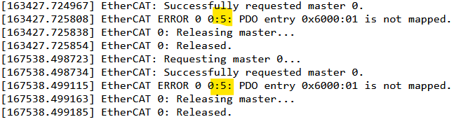

Here is that log

There it is.
The problem is with your slave 5, the EL1014.
Can it be that it is a very old version? They had a different PDO mapping.
Can you temporarily remove or comment out slave idx=5 and see if you
come any further?
We can come back to how to fix it for the EL1014.
Well, it is to run lcec_configgen with the option, "lcec_configgen --typedb=false"
and then take the info for slave 5 from that output.
come any further?
