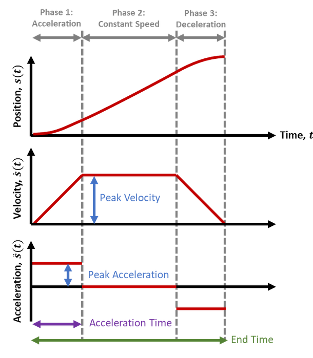

I think you want to use PP (Profile Position) mode.
It's a cia402 op-mode, with some luck your drive supports it.
You need to set Profile Velocity and Profile Accelerations, from that
the drive will move to the position you set with for example halcmd setp pin position
dbraun1981's cia402 component doesn't support pp mode but you can easily add it.
WIthout any detail, these are the steps.
Set controlword to 6, 7, 15 (op-enabled)
Set op-mode to 1 (pp)
Set pp accelerations and velocity
Set pp position
wait (optional check target_reached)
Set new pp position
wait ...
and so on.

I done some investigations, and it seems my driver is simplified as possible and supports only homing and CSP modes.
There are no registers for velocity and acceleration, the driver uses internal default values.
In LinuxCNC xml configuration you can create hal pins for non existent registers and you can write to them, but it not affect the driver.
My bash script is far of dreams, but works.
