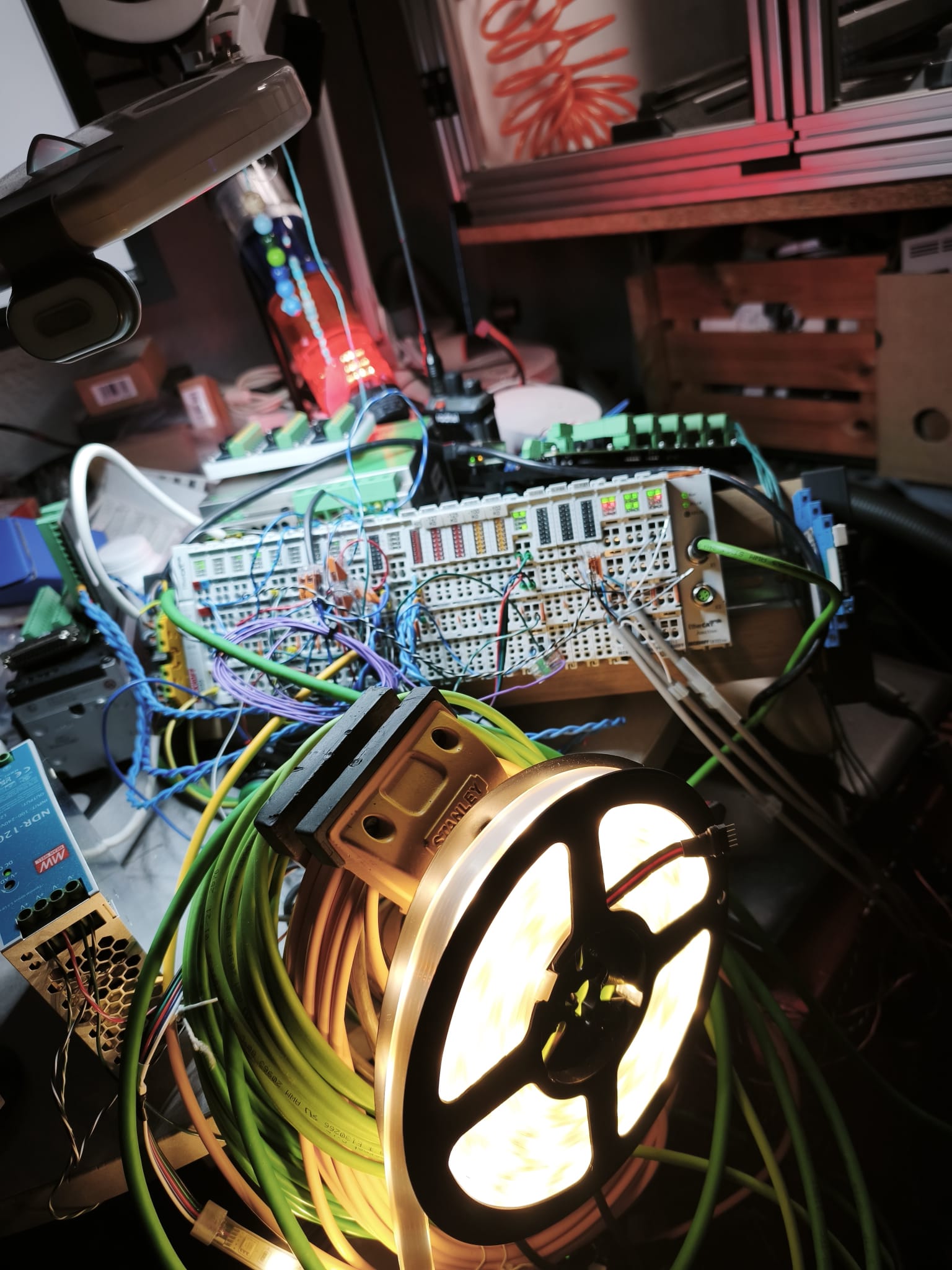

Hi there!
my Raspberry Pi5 died so i needed to setup thing new, but I can´t get it working anymore. It worked before...
I have two Ethercat modules which need "speical care"
1. its the external "EP1809-0021" this is identical to the EL1809, so just replicating the last line in the el1xxx.c with the correct PID, works
2. the EL2564, this is a dedicated "driver" which is copied into the linuxcnc-ethercat/src/devices which gets compiled, works...
LinuxCNC runs in the SIM Modes... also with ProbeBasic
EtherCat works - ethercat master and slave commands...
but LinuxCNC with ProbeBasic and Ethercat doesn´t want to start.
Here you can see my terminal-log when starting LinuxCNC
here you see my Ethercat terminal Outputs...
the EP1809 wasn´t connected...
so what can it be? I followed the "EtherCat installation from repositories" from Rod... i tried multiple images, 2.94~2.98 on Bookworm and Trixie...
thank you
miniwini

LinuxCNC Ethercat crashed with signal 11
-- STACK TRACE START
0 /usr/lib/linuxcnc/modules/lcec.so(+0xfcbc) [0x7f72cb8f3cbc]
1 /lib/x86_64-linux-gnu/libc.so.6(+0x3c050) [0x7f72cc759050]
2 /lib/x86_64-linux-gnu/libethercat.so.1(ecrt_slave_config_pdos+0x2f) [0x7f72cb8b652f]
3 /usr/lib/linuxcnc/modules/lcec.so(rtapi_app_main+0x40a) [0x7f72cb8f4f68]
4 /usr/bin/rtapi_app(+0xbd67) [0x558070fe7d67]
5 /usr/bin/rtapi_app(+0xc6be) [0x558070fe86be]
6 /usr/bin/rtapi_app(+0xccbc) [0x558070fe8cbc]
7 /usr/bin/rtapi_app(+0x7a04) [0x558070fe3a04]
8 /usr/bin/rtapi_app(main+0x70f) [0x558070fe348f]
9 /lib/x86_64-linux-gnu/libc.so.6(+0x2724a) [0x7f72cc74424a]
10 /lib/x86_64-linux-gnu/libc.so.6(__libc_start_main+0x85) [0x7f72cc744305]
11 /usr/bin/rtapi_app(_start+0x21) [0x558070fe38f1]
-- STACK TRACE END
twopass: load_the_modules cmd=<orig_loadrt lcec>
waitpid failed /usr/bin/rtapi_app lcec
/usr/bin/rtapi_app exited without becoming ready
insmod for lcec failed, returned -1Here you can see my terminal-log when starting LinuxCNC

18 Mar 2026 18:23 #344479
by 0x2102
Replied by 0x2102 on topic LinuxCNC 2.98 - Ethercat - ProbeBasic
I had a similar issue. Was running an older linuxcnc-ethercat version - which worked well but when I went to the latest version to address the "random jitter" issue it crashed with signal 11.
forum.linuxcnc.org/ethercat/58103-etherc...-fix?start=60#344310
Try grandixximo's linuxcnc-ethercat repo - which has the "jitter fix" and the "zero-initialized" fix.
Make your custom mods and compile:
github.com/grandixximo/linuxcnc-ethercat
