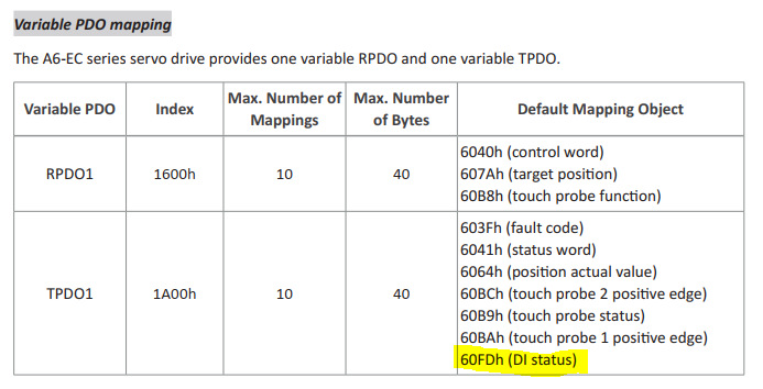

Forgive me for being extremely new at this.
I understand 'add it to the xml file' in general terms, but as I have no experience or context it's hard for me to determine exactly what/how to add something.
My test xml file has what appears to be variable PDOs: "pdo idx=1600" and pdo idx="1A00"
These appear to be variable PDOs, whatever that means, based on the chart taken from the manual:

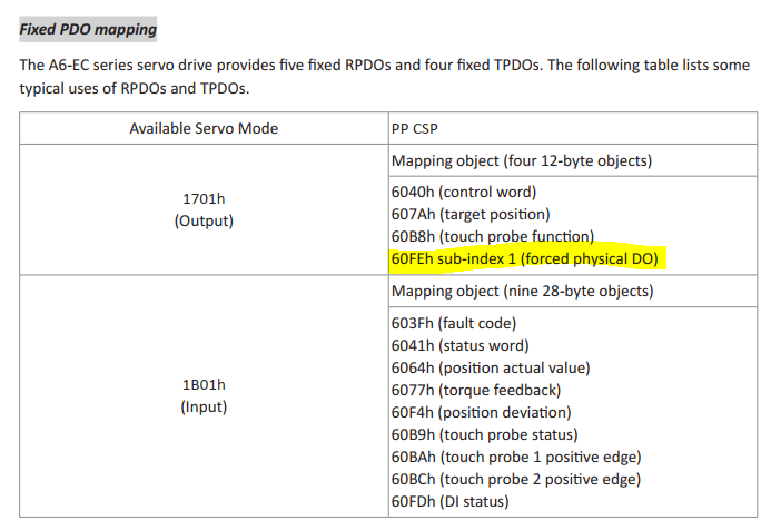

However, the only place where digital outputs appear to be available is in the Fixed PDO section:
Can I add another section in the xml file for fixed PDO's? or do I have to pick one or the other?
Regarding bitslice... am I correct - generally - in that the drive sends a 'word' or string or something to LCNC with address "60FDh", and the value of that word can be interpreted using bitslice as the status of the drive's digital inputs?
If so, using the chart below is the key needed to configure bitslice in to HAL pins?

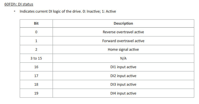

Got the inputs figured out.
1. Program drive so all inputs are 'no function assigned'
2. Change xml input address HAL name:
3. Add bitslice to HAL, using the bit chart from the servo manual:
Now I can press buttons connected to the drive and all five inputs react in halshow. Rather exciting...
Next step is to see if I can fumble through changing the PDOs to 'fixed' and somehow map the outputs.
Anyone have a clue what 'sub-index 1' means?
<pdoEntry idx="60FD" subIdx="00" bitLen="32" halPin="digitalinputs" halType="u32"/>3. Add bitslice to HAL, using the bit chart from the servo manual:
loadrt bitslice count=1 personality=32
addf bitslice.0 servo-thread #DRIVE IO
net DI-X-IN <= lcec.0.A6.digitalinputs
net DI-X-IN => bitslice.0.in
net DI-X-IN-16 <= bitslice.0.out-16
net DI-X-IN-17 <= bitslice.0.out-17
net DI-X-IN-18 <= bitslice.0.out-18
net DI-X-IN-19 <= bitslice.0.out-19
net DI-X-IN-20 <= bitslice.0.out-20Now I can press buttons connected to the drive and all five inputs react in halshow. Rather exciting...
- Posts: 11910
- Thank you received: 4051
25 May 2026 21:47 #346626
Replied by rodw on topic A6 Ethercat - digital IO mapping?
You don't need bitslice, just do it in the xml NOte there are some unused bits in this example
<pdoEntry idx="60FD" subIdx="0" bitLen="32" halType="complex">
<complexEntry bitLen="1" halPin="CW-limit" halType="bit"/>
<complexEntry bitLen="1" halPin="CCW-limit" halType="bit"/>
<complexEntry bitLen="1" halPin="in-home" halType="bit"/>
<complexEntry bitLen="13"/>
<complexEntry bitLen="1" halPin="in-1" halType="bit"/>
<complexEntry bitLen="1" halPin="in-2" halType="bit"/>
<complexEntry bitLen="1" halPin="in-3" halType="bit"/>
<complexEntry bitLen="1" halPin="in-4" halType="bit"/>
<complexEntry bitLen="1" halPin="in-5" halType="bit"/>
<complexEntry bitLen="1" halPin="in-6" halType="bit"/>
<complexEntry bitLen="10"/>
</pdoEntry>

25 May 2026 22:12 #346628
by spumco
Replied by spumco on topic A6 Ethercat - digital IO mapping?
Thanks Rod, I found another example - which pointed me to your GH example. I've now got the XML and HAL configured like your example, and evern figured out how to use the "sub-index" stuff.
Remaining problem is that the manual is missing the bit values for digital outputs.
There's no corresponding chart or description for index 60FE like there is for the inputs.
I can 'talk' to the 60FEh address and write values - and see them change in the tuning software - but I've no idea what values turn on/off the outputs.
Based on the two output-related sub-indexes I'm also wondering if there's some requirement to first enable the outputs, then activate them.
I checked the OEM servo manufacturer's manual and no luck (JSS servos - JSS715N).
I tried bits 1 & 2, as well as bits 16 & 17 - based on the now-obsolete T7/leadshine servos. Wild chance, but no dice.
Also tried turning both sub-indexes on, still no joy.
I've emailed Stepperonline, no response yet.
Anyone have a suggestion?
- Posts: 11910
25 May 2026 22:34 - 25 May 2026 22:36 #346629
type:
ethercat pdos > pdos.txt
ethercat sdos > sdos.txt
and share the output here.
Probably something like
<pdoEntry idx="60FE" subIdx="1" bitLen="16" halType="complex">
<complexEntry bitLen="1" halPin="out-1" halType="bit"/>
<complexEntry bitLen="1" halPin="out-2" halType="bit"/>
<complexEntry bitLen="14"/>
</pdoEntry>
also adapted from my GitHub example
