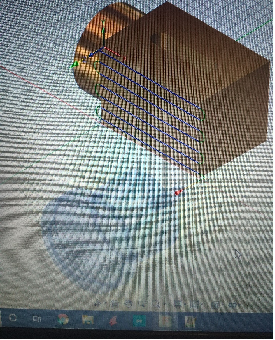

hi
i'm a new Fusion360 user
i've a destop mill with 4th axis located on the table in the X direction (A)
i've try to face an object using rotary axis...
the toolpath simulation is ok but when i postprocess the gcode return a code like i have the rotary axis in the milling head...
my postprocessor line to set the 4th axes:
var aAxis = createAxis({coordinate:0,table:true, axis:[1, 0, 0], range:[-360, 360], preference:0});
and the gcode generated:

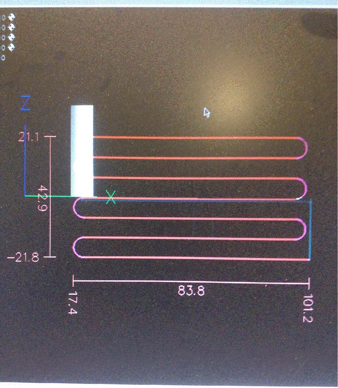

seem like the option table:true don't work on my configuration
in attachment the model with the toolpath generated and the toolpath on linuxcnc
thanks

It's that last line you need to change as well. The last line in that initialization routine where createAxis is. Optimizenachineangles() or something similar. You set it to 1 if it is 0, or the opposite. I am not at the computer right now, but i hope you can find it from this vague description.

The preview of the toolpath with an A axis will not be very good. But that G-code you have there isn't right.
Here is my initialization
Then when you get this working you will see some jerky movements. Here is what I did to that
There is a link to my modified post processor in the video description.

i've dowloaded an upgraded postprocessor from hsmposts and the 4th axis work fine
probabily the postprocessor in the installation files is corrupted or not complitely working
here the gcode from new postprocessor
