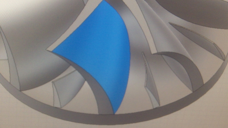

hi i managed to get a construct on Freecad and upload it to Fusion cam
can somone help me on generating a toolpath for TCP on fusion for this part
WHAT operation is used to get the tool side to the curve paddle
i atached the STP file
the cutter is a 6mm Ball with a 15mm cut length (12mm depth per path max in g-code) and a 80mm length to the holder total L=100mm ER11
the mashine got 0,0,0 Center Rotation no ofsetts i look for a C200deg +- and A a max of 75deg +-
Material is Ureol so 2500mm/min XYZ and AC on 2000deg/min

I think it should be the "swarf" multi-axis operation. Haven't done it myself though.
Tried you step file. The little I know about this is there need to be an upper contour and a lower contour.
It kind of degenerates when the contour is a triangle like in your case.
