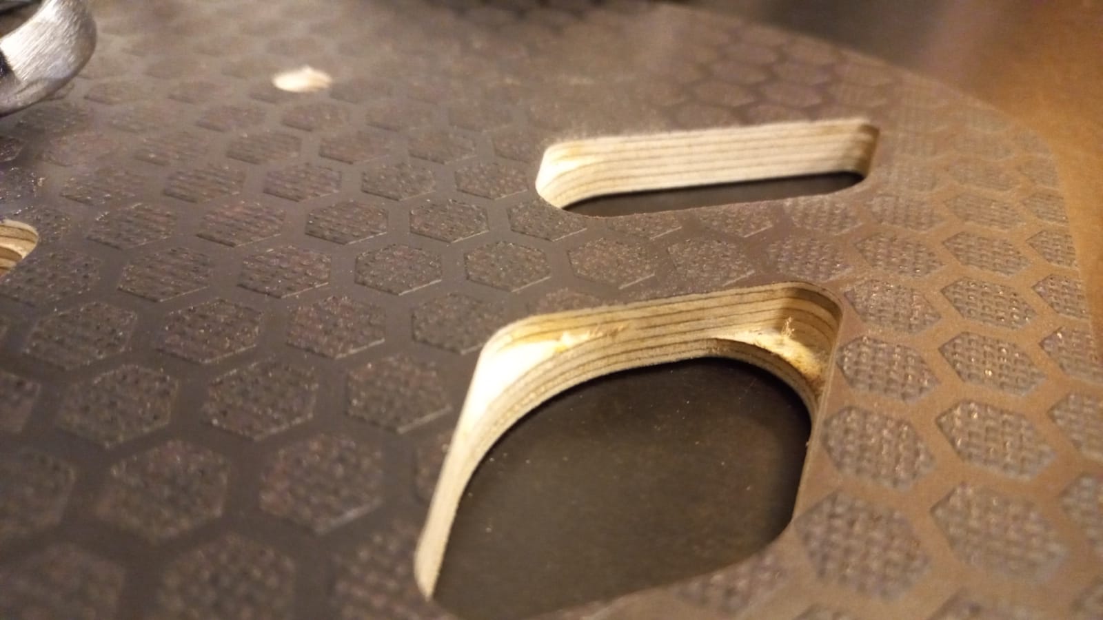

by Pauchuk
Replied by Pauchuk on topic Fusion 360 - EMC Post ?

28 Oct 2021 14:25 #224581
Replied by tommylight on topic Fusion 360 - EMC Post ?
Disable G64 path blending, set a G64 P0.1 for mm or G64 P0.004 for inch.
Oh i see you have it set, so what is the tool diameter ?

28 Oct 2021 14:52 #224586
Replied by andypugh on topic Fusion 360 - EMC Post ?
It might be worth looking through the generated code to see if it changes the G64 setting at any point.

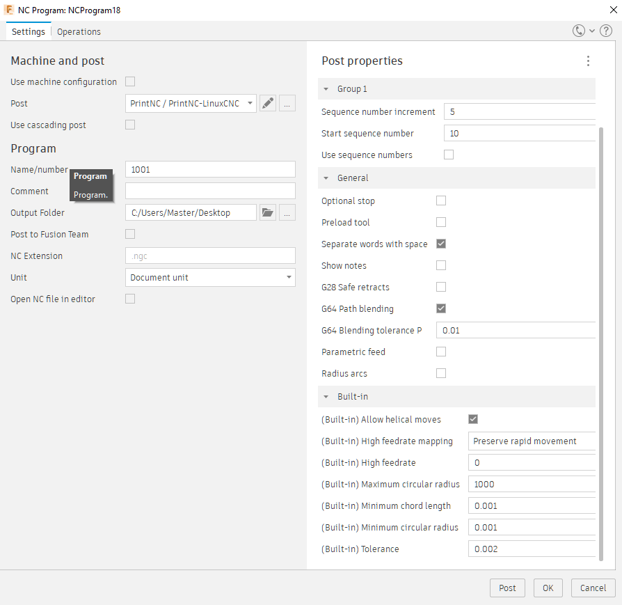

- Pauchuk
- Posts: 38
28 Oct 2021 15:52 - 28 Oct 2021 15:59 #224592
by Pauchuk
Ok, seems that on one of PC` s there is g64 option and on other one - there isnt one. How can I add it?
I thought same Fusion profiles share same settings, no matter on what PC I use Fusion.
Last edit: 28 Oct 2021 15:59 by Pauchuk.
- Posts: 19902
28 Oct 2021 18:04 #224603
Are they both set up to use exactly the same postprocessor?
- Pauchuk
- Posts: 38
28 Oct 2021 19:31 #224606
by Pauchuk
Probably no.. is there a chance to add g64 option?
- db1981
- Posts: 790
- Thank you received: 276
29 Oct 2021 06:30 #224629
by db1981
Replied by db1981 on topic Fusion 360 - EMC Post ?
Hello,
the post proccecors and setting are local in the standard settings.
You have to change to cloud-post proccesorcs, in your settings to get it the same on every pc.

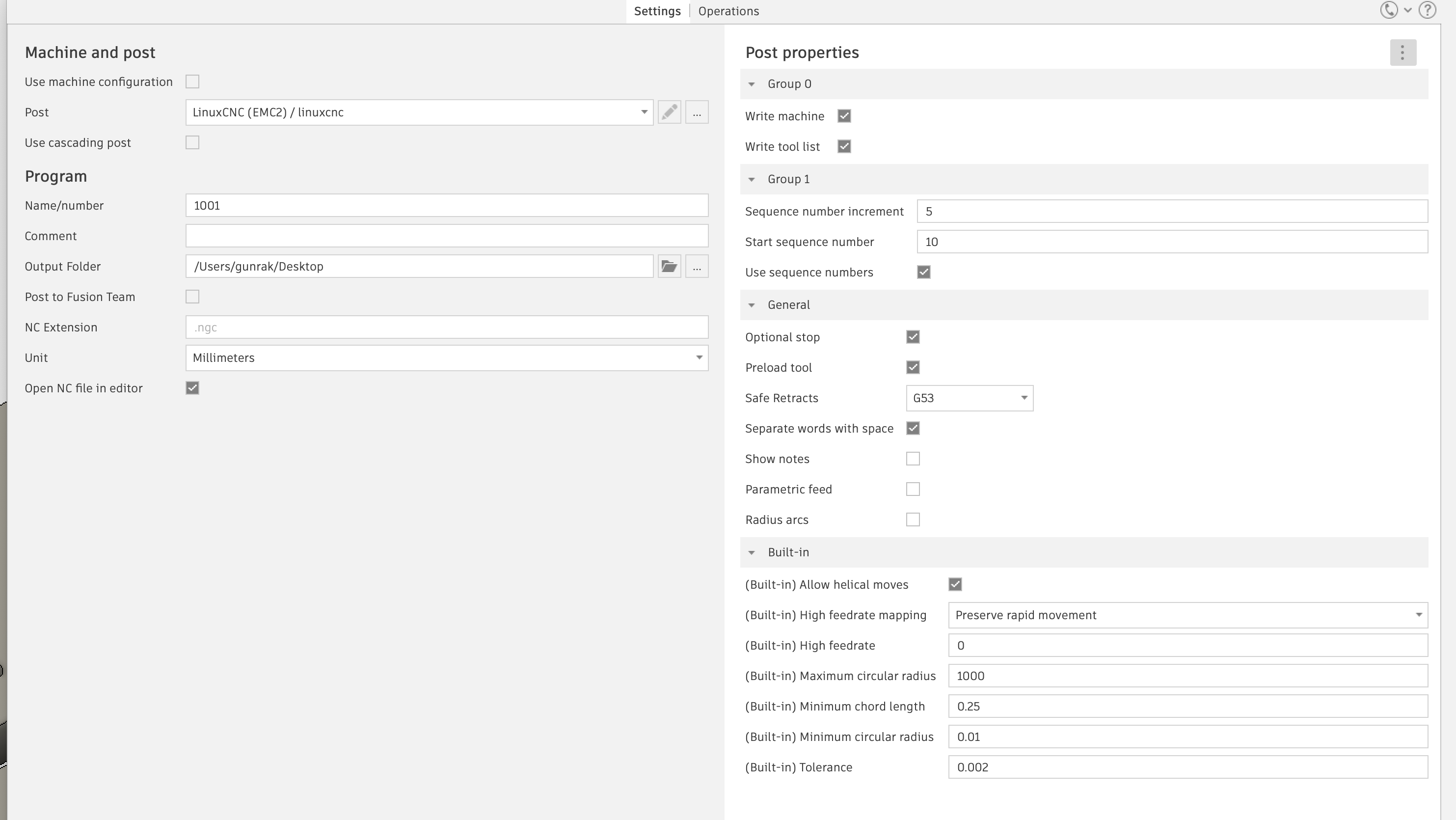

- gunrak
- Posts: 9
29 Oct 2021 19:36 #224667
by gunrak
Replied by gunrak on topic Fusion 360 - EMC Post ?
I have the very same problem as Pauchuk has, my inside corner radius is way of. I did not change anything in my workflow, neither I had similar issues before. I never paid attention to G64 in g-code.
What I can see is that Fusion recently updated UI during post processing, and today was the first time after update when I actually used post processor and router.
Like I said I did not pay attention was there G64 in greeted code before or was not, but I am sure that I can't find it now.
Could someone confirm that latest Fusion 360 Post processor works as it should?
Please see attached g code straight from post processor
- gunrak
- Posts: 9
29 Oct 2021 21:01 #224677
by gunrak
Apparently default Fusion 360 post processor never added G64. It might be coincident that only now I faced the issue. I updated latest Fusion's post processor with G64. Credits spangledboy.Please see attached file. Post processor is not tested in real life, but G code looks ok, will test it tomorrow.
