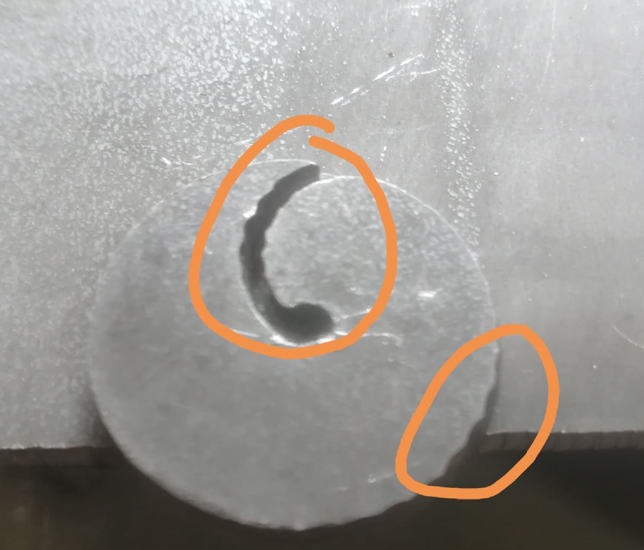

02 Oct 2021 19:13 - 02 Oct 2021 21:08 #222040
by paulsao
circle cutting test fusion was created by paulsao
Last edit: 02 Oct 2021 21:08 by paulsao.

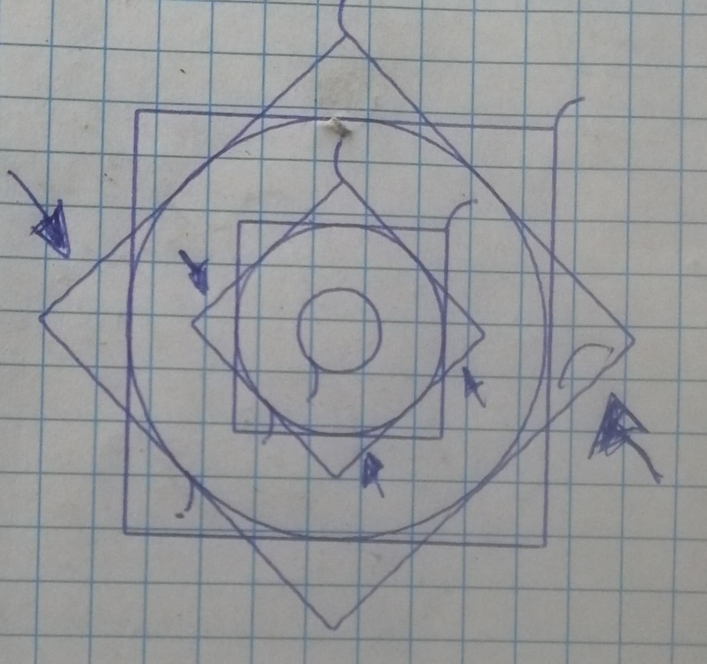

I guess you already adjust the PID many times. But finaly we have only two reason. Mechanic or PID loop. Mechanic could be not straight or parallel linear guides. And servo can not run smooth at this point.
Its almost in same area, check mechanic there. Its sporadic somewhere, decrease your P term.
I remember you plot good circles on paper. I would do it again to indentify bad areas.
bad game....
bad game....

Thanks for your help, now I am going to carry out other tests but I have some doubts before:
1) In circles the PID also enters the game? I have P = 25
2) I have carried out some tests and I see that the vibrations occur when the 2 axes come into operation at the same time but right in some corner it smells of something of the acceleration I do not know how to adjust those values.

I am using dm556 drivers with 1/64 microstep divisions, nema 23 motors, the x axis has that problem, coincidentally that axis has a nema 23 motor but different from those of the (y) axis, it consumes more current and is not very quiet, now that I check my stepper motor cable it does not have protection against electromagnetism, I think I will replace that to eliminate all possibilities, I did a test reducing the acceleration and I no longer have the oscillations, but I think it is not good for the thc anymore that it would not reach the desired speeds. I am attaching my ini file.

I managed to correct the vibration error by reducing the acceleration a bit I think it is not very good for the thc but for now I am going to leave it that way, since the only solution is to place a reduction system in the motors and bands system because I have it connected directly and that influences the vibrations, thanks for your time and help.
