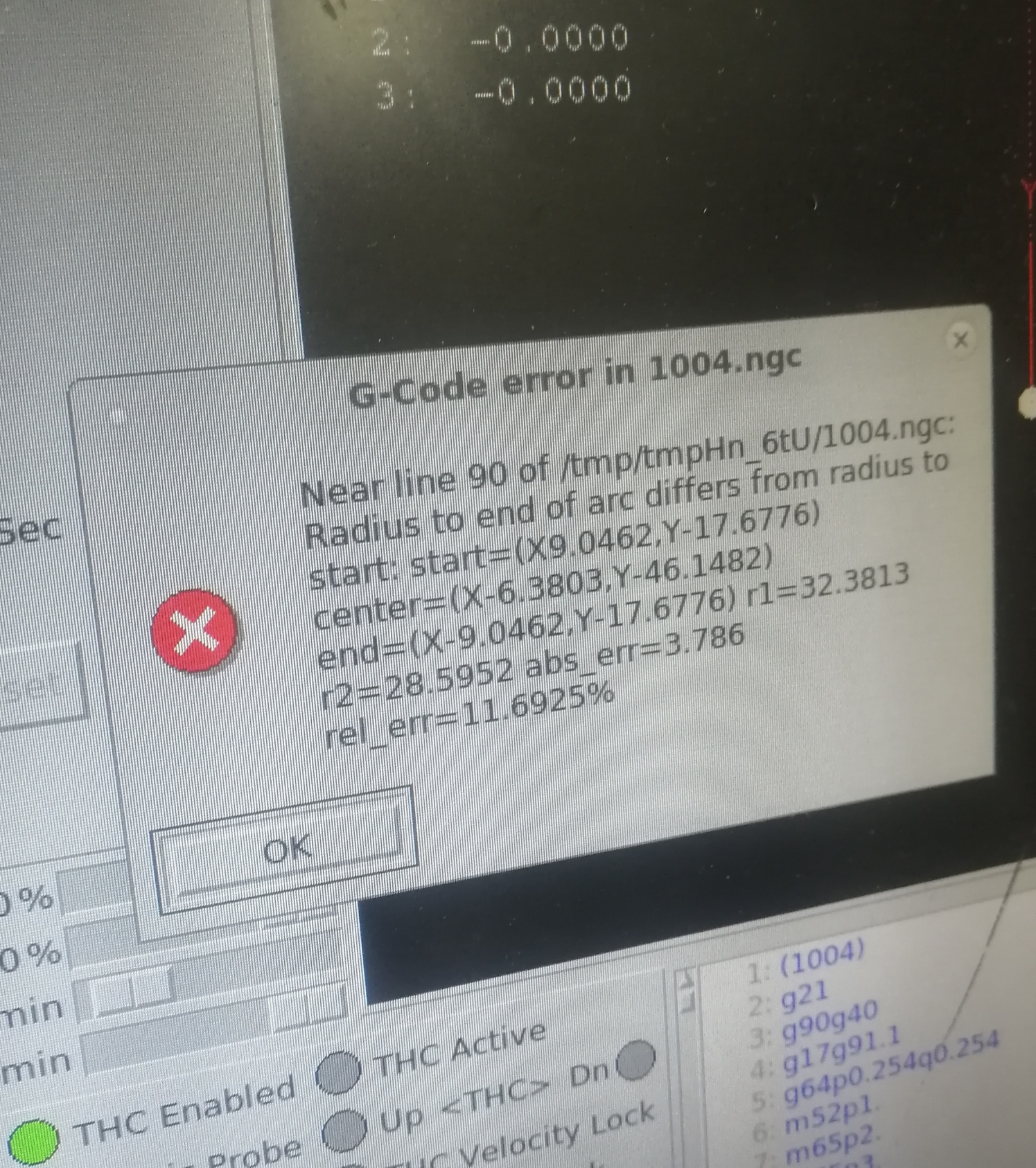

Greetings to all I am starting to test fusion 360 and the plasma table and in a test cut I have this error I read some threads but I cannot solve it, I am working in mm.

The problem occurs when I want to load the file into the plasma it cannot be displayed.

This usually means that you have an error in the GCode of the arc movement. Can you post your GCode?
Also happens if you use tool compensation with tool diameter that is too large for the arc.

THE BAD CODE IS COMENT WITH ("THE PROBLEM")

N315 G3 X-9.04615 I-15.42645 J-28.47062 ############## THE PROBLEM

I just realized this question is in the Fusion360 sub forum so you must already know that this is a problem with the CAM.

I am using Plasmac and Fusion 360, when I want to open the fusion file in Plasmac I get this error. (Attached) I also publish my G code to someone help me with this problem, I am working in mm and with a nozzle width of 1.2mm

If you enter an m2 after N140, you can read the file. Then remove all before N175, get rid off I and J only keep x y as start, the file can be loaded.
So the error in your design is from N145 to N170 to check the Arcs, endpoints

The same design works in shetcam something in the 2d profile settings is wrong, I saw that someone had a similar error in cnc milling and I solve it by removing the tools but here it is different.

Disable tool compensation in Fusion360.
Also choose a tool with 0.5 to 1mm width.
