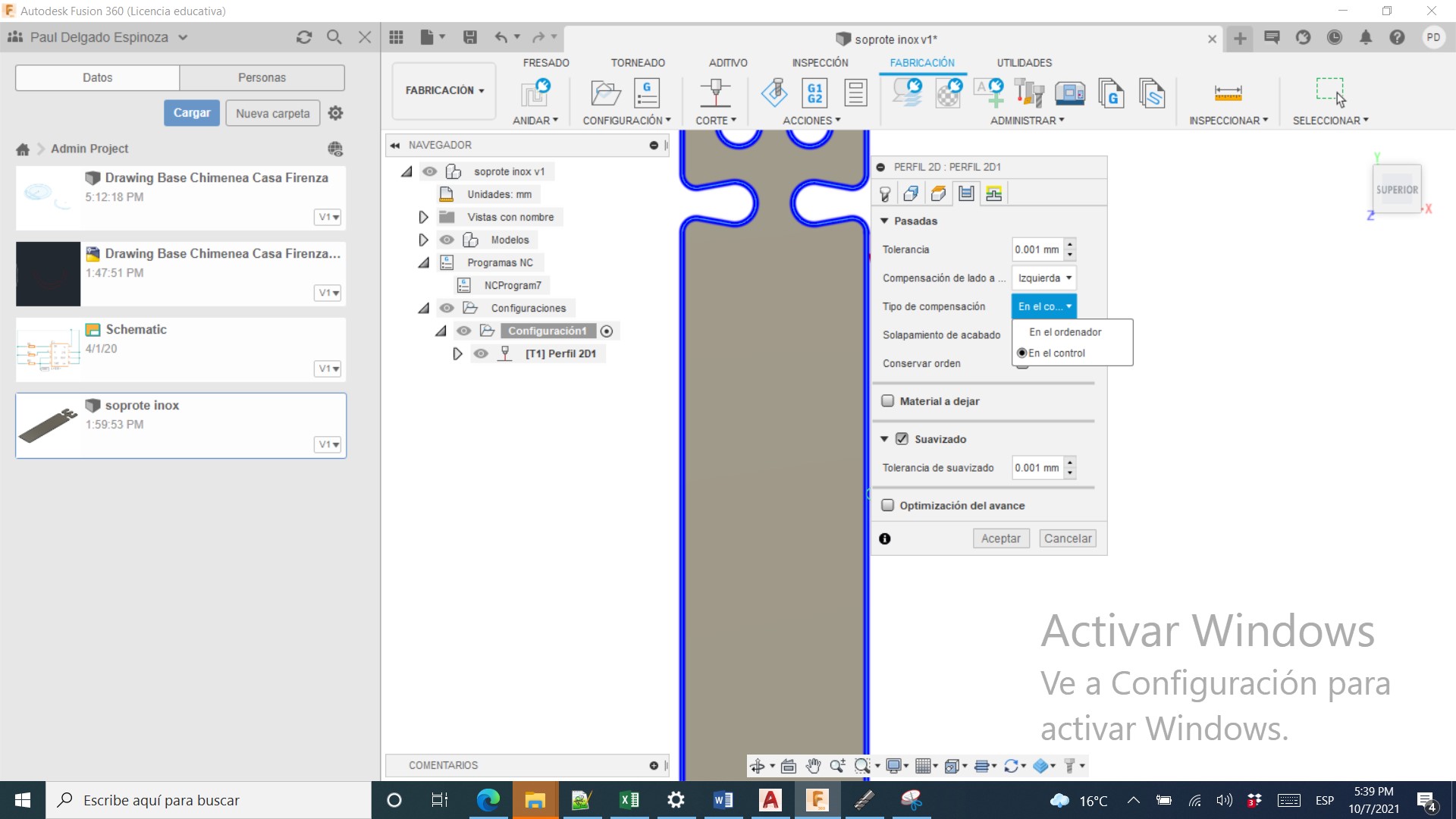

I have the same problem ...

Well, if someone had the same error, please check the final part where the nozzle inlet and outlet is configured, I had it configured in an arc shape and it is where the problems that I had with different arcs were presented, now I use straight inlets at 90 degrees for exterior profiles and I no longer have those problems, everything works fine !!!

Actually now I want to cut a letter for a sign and I have that same radius problem, I change tolerance, torch diameter in Fusion and I don't know what else to do to fix that problem.

I generated the same file in sheetcam and it works very well, but with fusion 360 I have that error, now I'm going to with inkscape but ideally everything works in Fusion
