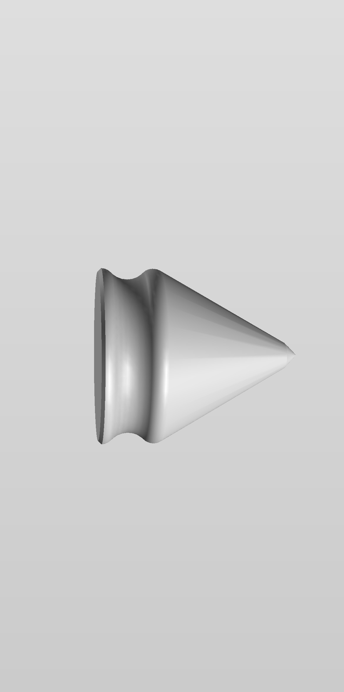

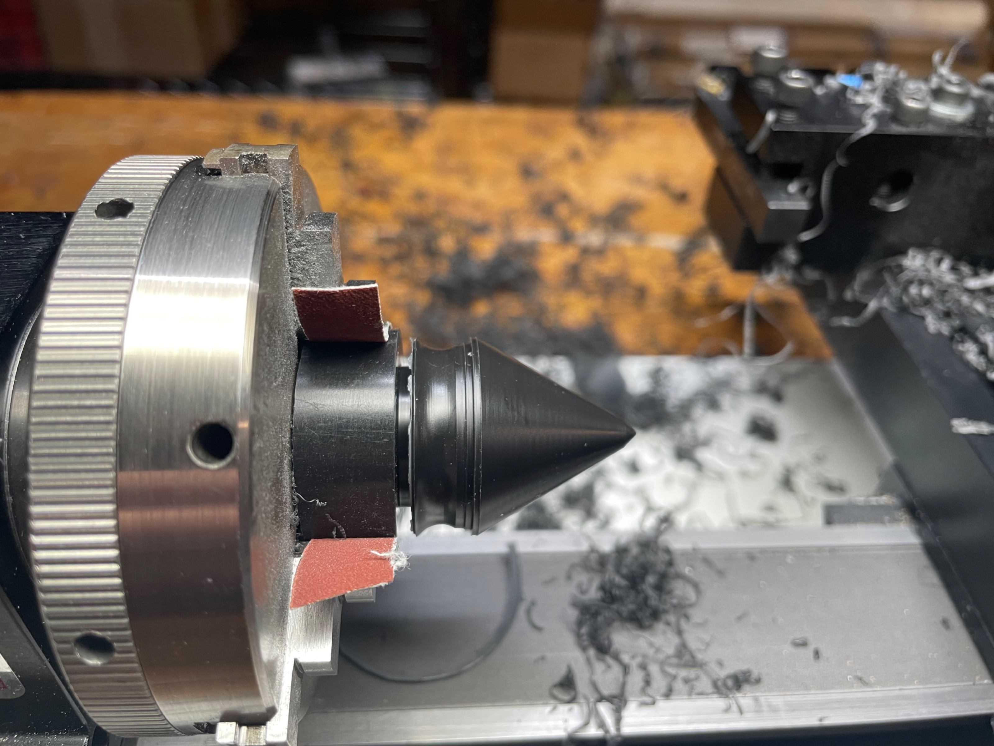

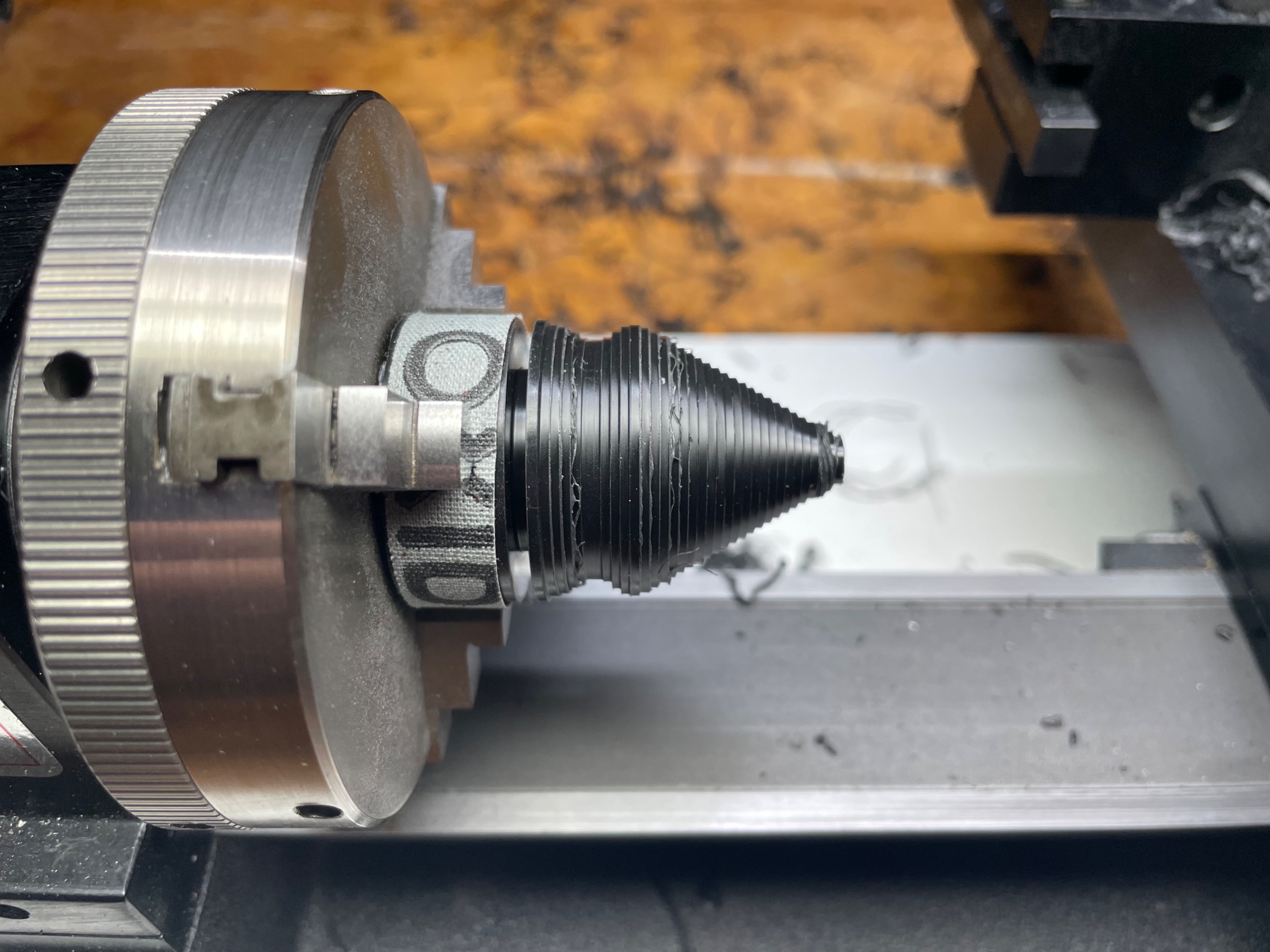

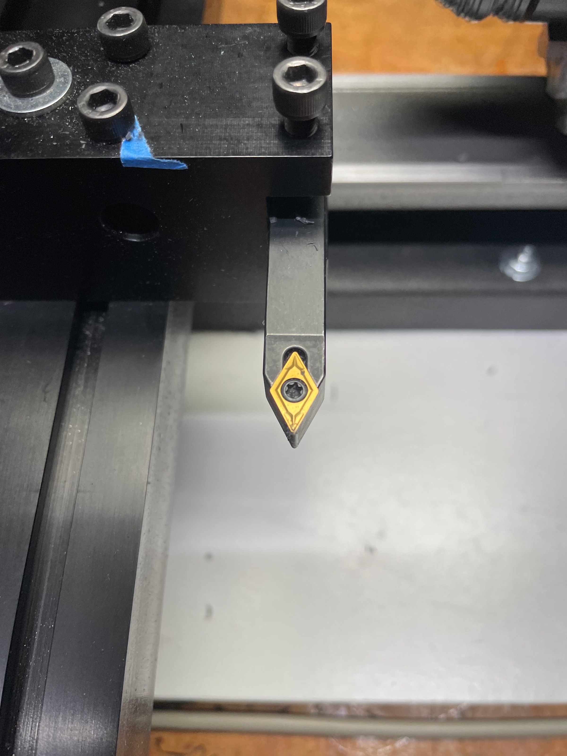

I suspect this is more likely a general machining or CNC issue. Trying to make a curve on my Sherline CNC lathe. The image in white is the Fusion model. Next image is after I do the roughing with a groover. Last image is after finishing passes. In that last image, you can see the right side of the curve hasn’t been formed and is still rough but the left side of the curve is correct. I run two finishing passes, one each direction. Any thoughts as to what might be causing the issue?

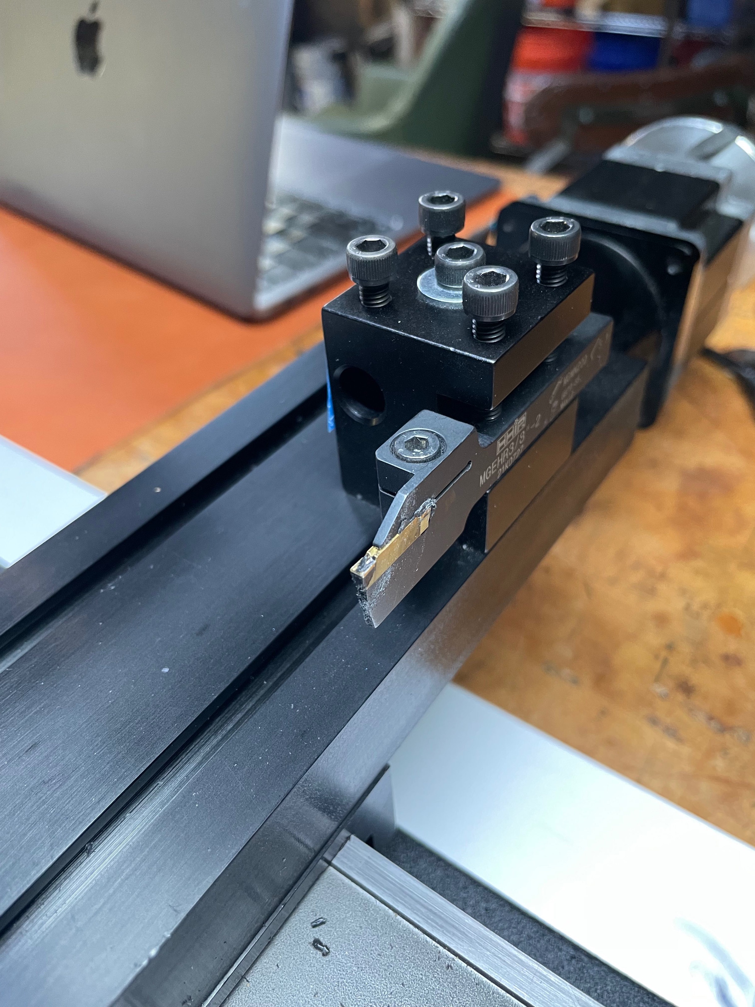

can you provide pictures of the tools used....

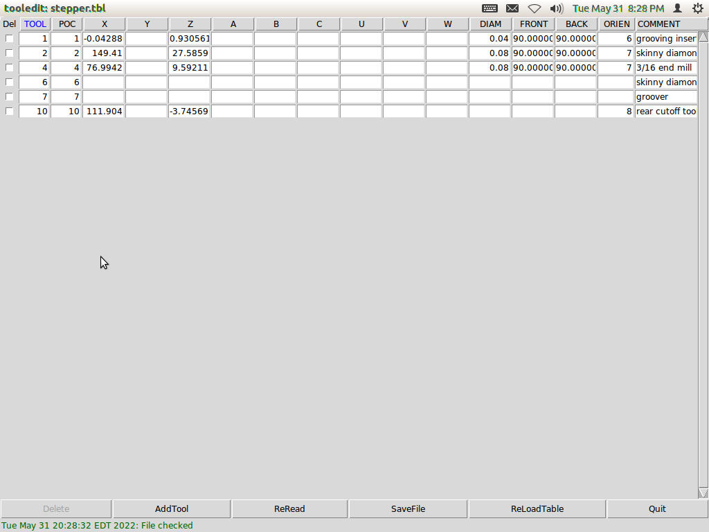

do you have a tool table set with offsets?
have you checked and tested the offsets X and Z are correct for all tools?
can you post the gcode?
my thoughts with a lack of info are
tool shape (profile) not matching that in fusiontool offset not being the same or correct following a tool change
- russjhammond
- Posts: 11
01 Jun 2022 00:50 #244330
by russjhammond
Replied by russjhammond on topic Issue with groover and finishing passes

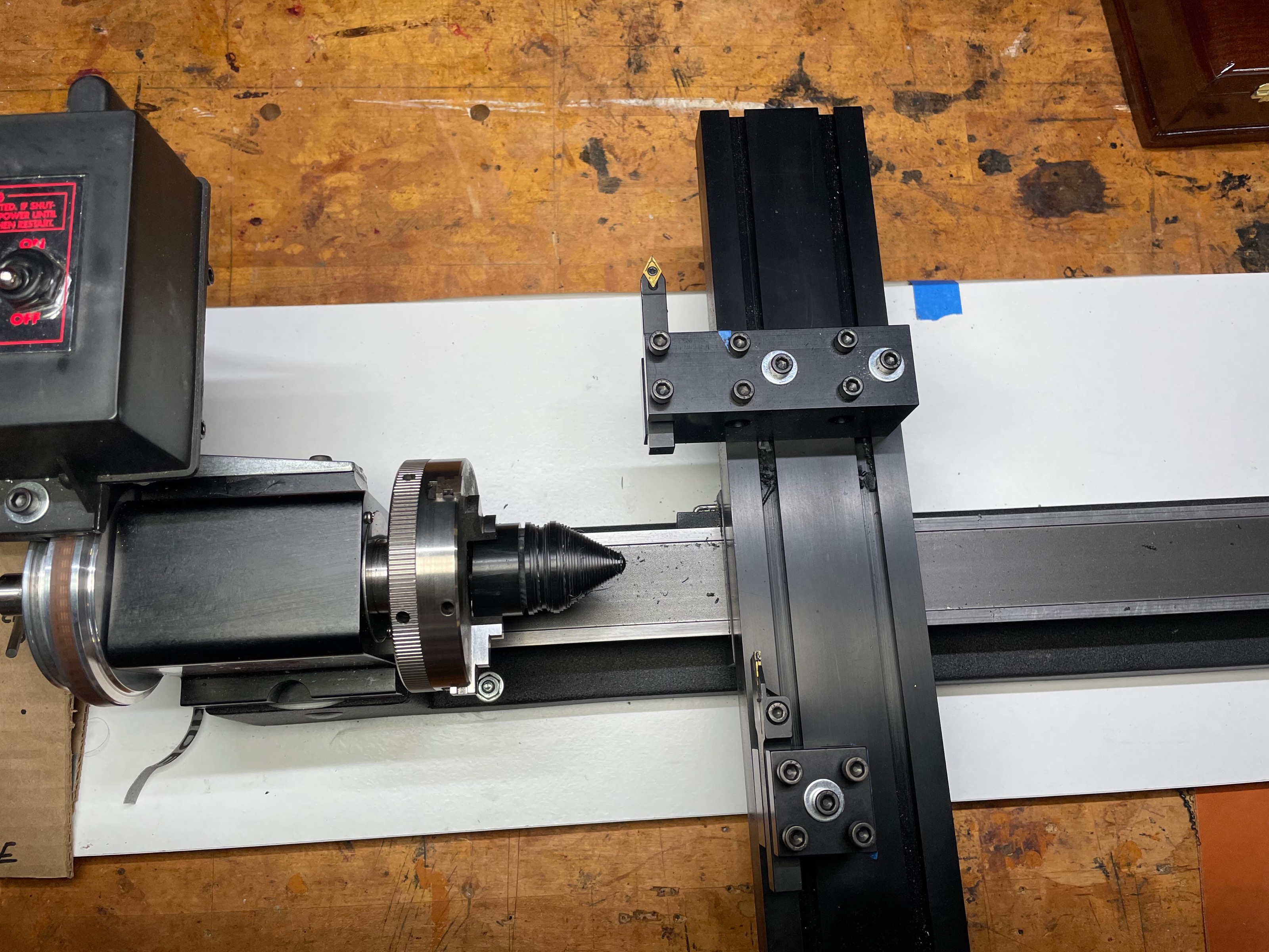

Here are pictures of the general setup, tool used for profiling, screenshot of tool table,

01 Jun 2022 03:50 #244343
by spumco
Replied by spumco on topic Issue with groover and finishing passes
Check the F360 operation... think it's under passes (last tab before linking).
Looks like you've got pass direction set front-to-back and not both directions. Check it in sim at slow speed and see if its engaged in both directions. The grooving strategy has some funny settings.
- Posts: 19902
07 Jun 2022 12:42 #244719
Replied by andypugh on topic Issue with groover and finishing passes
I wonder if Fusion "knows" that the controlled point of the groover is in the middle of the tool for orientation 6?
Is it possible that G41/G42 is turned on and the postprocessor is assuming that it is off (or vice-versa)
