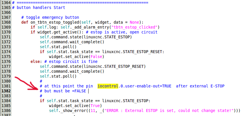

29 Nov 2014 21:53 - 30 Nov 2014 01:00 #53528
by verser
Replied by verser on topic Gmoccapy - A new screen for linuxcnc
Hi Norbert,
After external E-STOP and it reset
pin iocontrol.0.user-enable-out = TRUE,
because of which there is no movement.
Maybe do something like?:
Set iocontrol.0.user-enable-out = FALSE in this place.
For example, such replacement (line #1377) is decided
fromto
from
self.command.state(linuxcnc.STATE_ESTOP_RESET)
self.command.wait_complete() self.command.state(linuxcnc.STATE_ON)
self.command.state(linuxcnc.STATE_OFF)

30 Nov 2014 02:01 - 30 Nov 2014 02:03 #53534
by newbynobi
Replied by newbynobi on topic Gmoccapy - A new screen for linuxcnc
Hallo verser,
I do not understand, as far as I can see, all is OK.
If estop is active, machine is estoped, iocontrol.0.user-enable-out = FALSE
If estop is reseted, machine not estoped iocontrol.0.user-enable-out = TRUE
So this is like it should be.
So what is wrong?
Norbert

30 Nov 2014 15:20 #53540
by verser
thanks for the reply,
I found error in its own configuration .hal file,
there found the right way to connect an external ESTOP.
I apologize for the false alarm.
