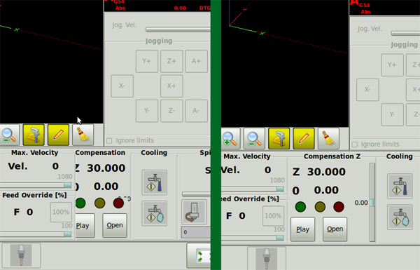

08 Mar 2014 03:33 - 08 Mar 2014 21:16 #44555 by verser
Replied by verser on topic Gmoccapy - A new screen for linuxcnc
Hi Norbert,
there is a small problem autoscale of custom panels:
solved (right figure) by adding in gmoccapy.glade for custom box (box_custom_2 in my case)
<packing>
  <property name="expand">False</property>
</packing>
but I should not touch gmoccapy.glade.
How best to resolve it?
Whether GTK+ allows access to the property of the parent from the dynamically connected child ?
Last edit: 08 Mar 2014 21:16 by verser.
08 Mar 2014 22:27 #44567 by newbynobi
Replied by newbynobi on topic Gmoccapy - A new screen for linuxcnc
Halo Verser,
as I did not find any side effects of your changes, I made them standard and just pushed the corrections.
It will work as you wished from ver. 1.0.6.2 (actual from now on)
Norbert
The following user(s) said Thank You: verser
