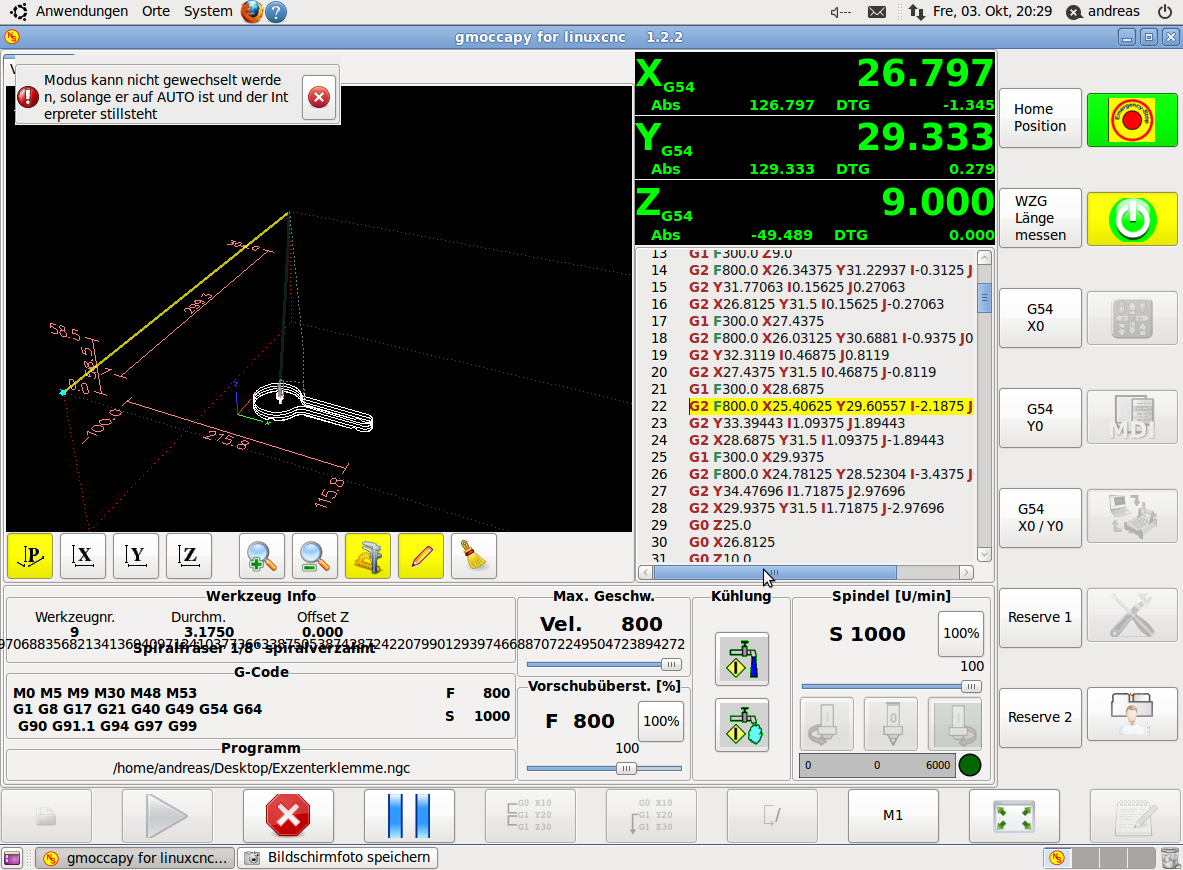

I think it's not necessary to implement a test "ready for MDI or MANUAL Mode. The same tought I had in the beginning, therefore i implementet it like this:
# Added support for F3 (manual mode) and (mdi mode)
            if keyname == "F3" and signal:
                # only change to manual mode if not in auto mode
		if self.stat.task_mode == linuxcnc.MODE_AUTO:
            	    return True
                self.command.mode(linuxcnc.MODE_MANUAL)
                return True
Then I tested it without the test for linuxcnc.MODE_AUTO. And then I also tested what happens if a ngc Programm is running. Details see screenshot.
Andreas

@Andreas,
I did know the error popup, IMHO that should not happen, thatis why i would test the mode.
Norbert

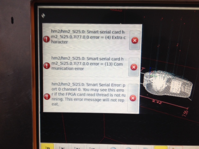

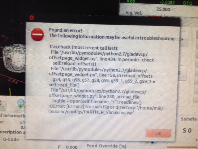

I just had these two items pop up. I'm thinking the one is why my g-code box doesn't always show the current codes. The other I've had from the beginning and not sure what it's about.
05 Oct 2014 06:04 #51791 by PCW
Replied by PCW on topic Gmoccapy - A new screen for linuxcnc
The smart serial error indicates a noise problem
Either cable from the 7I77 to 5I25 is routed next to noisy signals
(Power, motor leads, VFD signals etc) there is a ground loop somewhere,
or there are large noise sources around (contacts without arc suppression)
