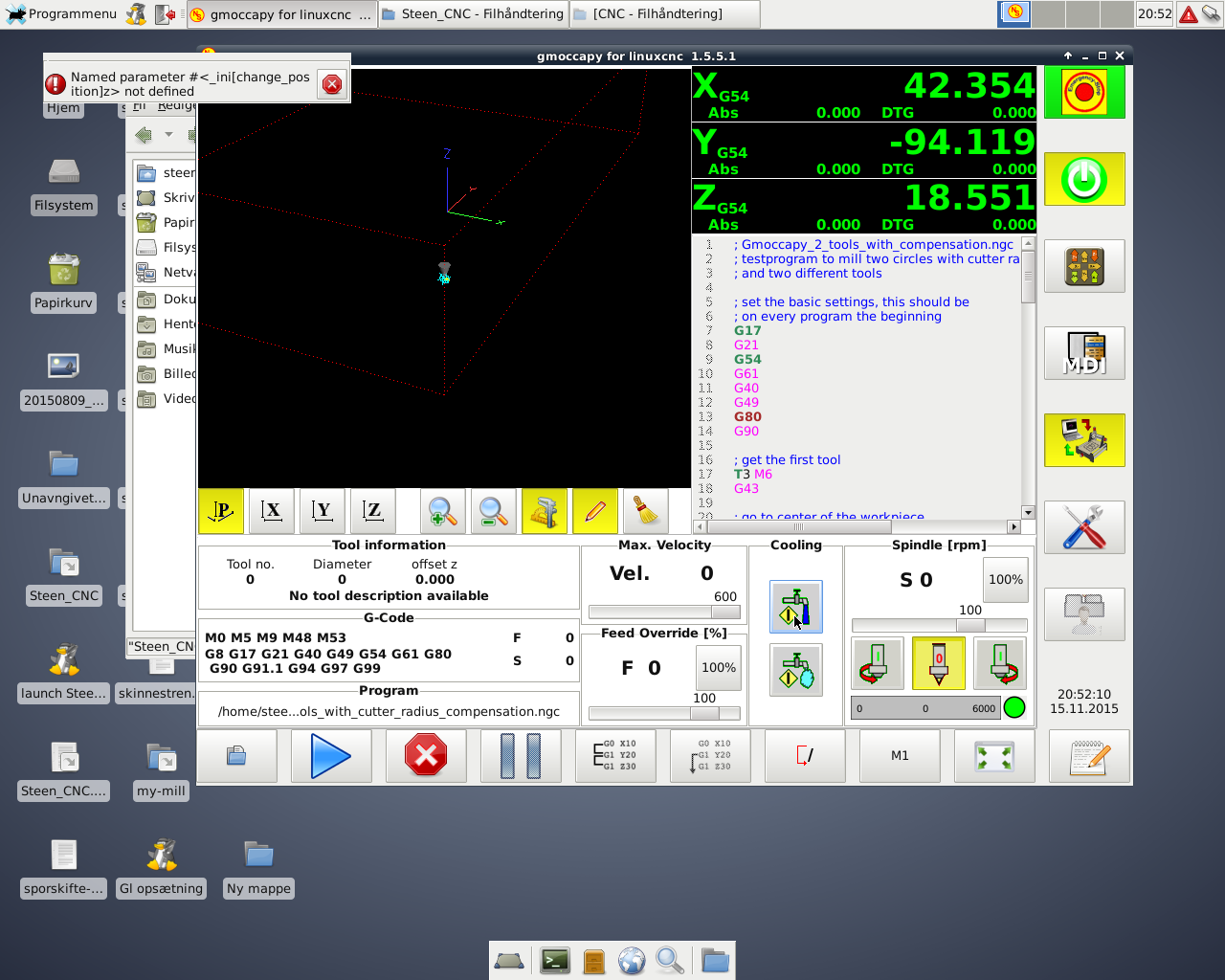

Hi
After the popup-window telling to change to tool #3 I've go an error telling something like:"Cannot change coordinatesystem with cutter radius comperations on". It must be the line 38....
No CNC-movement at all...
I do not understand that error...
Sincerly
Sincerly

Please check if G41 G42 or G43 are active?
If so execute G40 and G49 bevore starting the file.
Norbert
Norbert

Thanks for your reply, but how do I se if G41 G42 or G43 are active ?
The program, as you properly allready know, start with:
So the G40 and G49 are executed in the program....
Sincerly
Steen
; Gmoccapy_2_tools_with_compensation.ngc
; testprogram to mill two circles with cutter radius compansation
; and two different tools
; set the basic settings, this should be
; on every program the beginning
G17
G21
G54
G61
G40
G49
G80
G90
; get the first tool
T3 M6
G43
; go to center of the workpiece
G0 X50 Y50
G0 Z20So the G40 and G49 are executed in the program....

If the change window pops up, than it should be OK.
Have you excecutet G40 and G49 in the MDI window prior to start the program?
Norbert
Norbert

When running the program before duing anything it says: "Named parameter #>_ini[change_position]z> not defined"...
Sincerly
Steen
Ok- thanks.
Sincerly
Steen

like this....
