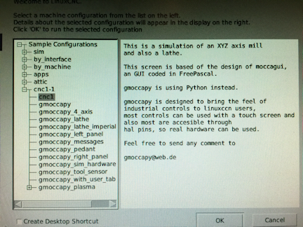

I have had some time to get everything reloaded from "linuxcnc-dev "and the "checkout gmoccapy_5_axis" from the links supplied. When I load my INI and HAL files with axis 5 items commented out it appears the load and run just fine. When I run a identical set of files with axis 5 items uncommented I get a error that there is s problem enabling axis 5 in gmoccapy.
The two sets of files are the same files I used before on the 5 axis version several weeks ago and worked fine. When gmoccapy tries to run on 5 axis it appears to get in a loop and sluggishly starts displaying its screen partially at times if I wait long enough. When it does show its screen on occasion Axis 4 and 5 dro's are side by side instead of one being below the other. One dro window is split into two parts (left being A and right being U). gmoccapy version 2.0.0 is installed.

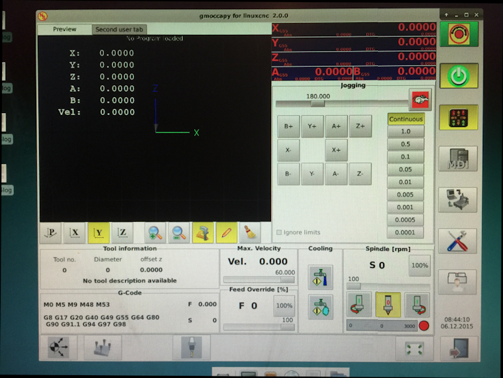

Replied by auto-mation-assist on topic Need testers for gmoccapy_5_axis

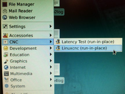

I was not really getting anywhere so I decided to remove all files associated with linuxcnc from my computer since I suspect it was potentially mixing different versions of linuxcnc and thus also gmoccapy. I down loaded the development version again using: "git clone git://git.linuxcnc.org/git/linuxcnc.git linuxcnc-dev" and linked it with "git checkout gmoccapy_5_axis". It compiled with some warnings but completed.
When the compile and rip-environment were finished I ran linuxcnc and it started and I was able the see the new tree menu and selected gmoccapy_XYZAB. It started as "v2.7" and ran but before finishing it failed. What is strange is that when I ran linuxcnc again with the cmd "linuxcnc" in the same 'linuxcnc-dev" folder it started to load as "v2.8" and changed the menu tree in debian jessie to the 2.8 version one. No gmoccapy_XYZAB being possible anymore. Presently I have version 2.8 just parked in a folder downloaded from the jepler repository as a zip file and it has not been compiled. I had removed all linuxcnc files with nautilus while it was running in su mode after its search for linuxcnc files was completed.
Some where there must be a file that is causing this. Perhaps the Debian jessie menu tree retained some info even when there was no visible cnc folder present it its tree. But why would it list a change in versions? I will try the "make install-menus " cmd from the "linuxcnc-dev/src" folder to see if that clears this problem.
Here is the first part of the log from the first start and the second start showing changes in linuxcnc versions during two closely timed program starts from the same directory. A file is attached separately for the first start that is more complete.

My last idea using "make install-menus " did nothing for me. I decided just to let my present configuration run and have it copy the "gmoccapy_tool_sensor" sim to my desk top and it ran fine from there. It only has three axis. I copied my 5 axis configure files folder into the "/home/john/linuxcnc/configs/" folder and selected it to run from the menu tree. The overall result is listed below. The mention of "Invalid on color value: Green" mentioned below is likely due to file mismatch and data going into the wrong place within gmoccapy during the process handoff due improper version of the gmocappy file that was automatically installed in /usr/bin/.

Norbert, I was able to get to get my configuration working and have attached some pictures to show the present selection menu. It does appear that the original selection menu was my biggest issue with its hidden files that retained data from its prior higher linuxcnc version that was installed before. I deleted hidden files that I found to be related to the selection menu tree that referenced linuxcnc and reinstalled the linuxcnc-dev version as per your prior post. I also removed the 4 axis version of gmoccapy that this problem installed.
I do wish that I did not have to go hunting for those files that needed to be removed but I did not feel like building the whole system from scratch again. I will clone the hard drive and continue with the tool length sensor, tool change and probing functions. The homing function in the files I posted are working properly for me on my test bed equipment.
I will try to find some probing functions files somewhere for gmocappy and will see if I can get those installed and working. The only thing that bothers me a little now is that my configuration shows up under the simulation tree. I will try o find a solution for that. I will change the joint to 6 as you mentioned for U. Right now that axis is set to B for testing. It has been a pretty steep learning curve and the end of that curve is still a long way away.
