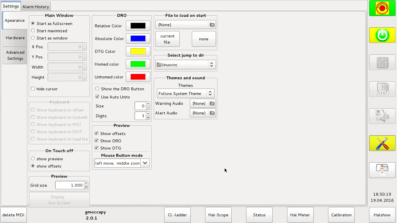

- alessandro torre
- Posts: 16
19 Apr 2016 17:01 #73605
by alessandro torre
Replied by alessandro torre on topic Need testers for gmoccapy_5_axis
I tested the 5 AXIS XYZAB configuration and it works great.
Maybe I found a bug in the display of the G54 G55 .... offsets.
I'm not very expert, so maybe I missed something in the following file "GMOCCAPY G54-G55 KO", but in the "DRO" view ( upper right black BOX ) I can't display the right G54 G55 coordinate system in "auto" mode.
Instead, in the following file "GMOCCAPY G54-G55 OK" the same system coordinates is correclty displayed.
I'm missing something or there is a bug?
Thank you in advance
Alessandro
Alessandro
The topic has been locked.
