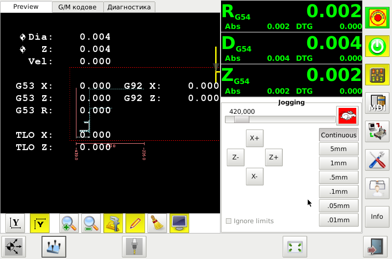

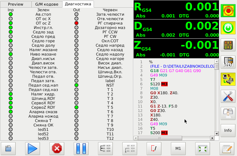

Yes, it is "manual movement" .language Bulgarian .here's displays

If you are using 2.8 you have to install glade-gtk2 and modify the gmoccapy.glade file to match the reduced screen like shown in the previous post.
If you are using 2.9, Gmoccapy has a new feature to modify the GUI by a user command file: linuxcnc.org/docs/2.9/html/gui/gmoccapy.html#_user_command_file
The advantage is that you don't have to replace that file after every update.

I player around a bit and figured out that it's more work to get the resolution down.
To get a smaller height than 660 you also have to re-order the settings pages...
What is your targeted size you'd like to achieve? 800x600?

15 Jan 2023 11:01 #262029
by probamo
Replied by probamo on topic screen resolution
800x600
