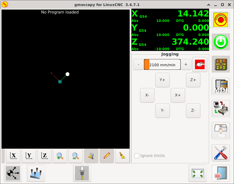

I guess you consider upgrading to LinuxCNC 2.8 or 2.9 but the not supported screen resolution would be a blocker for that? Is that right?

In fact I found Siemens industrial comps (x386) to manage CNC. Two of them have parallel ports in there therefore 2.7.15 work well there, and two machines works as a charm. The third one is new generation of the same industrial comp w/o parallel port. I have parallel port pci card and there is free slot for it. I put it there, unfortunately only kernel 4.0+ can recognize adds. 2.7.15 works with kernel 3.0+. That is why I am chasing small resolution for 2.8 which run at 4.0+ kernel.

For 2.8 I will not do such a modification. But for 2.9 I am planning to provide a sample config for that. Let me know if that would help you as well.

Tell me, this increases the size of the buttons, but not the pictures on them. How do I increase the image display size? Increasing the size of the picture from 48 * 48 to 66 * 66 does not give any result...If you are using 2.9, Gmoccapy has a new feature to modify the GUI by a user command file: linuxcnc.org/docs/2.9/html/gui/gmoccapy.html#_user_command_file
The advantage is that you don't have to replace that file after every update.

You can achieve that by adding the following code in the user command file.
Here an example for the auto mode buttons:
For the other images, see here: github.com/LinuxCNC/linuxcnc/blob/2.9/sr...py/gmoccapy.py#L4413

I created a configuration which should work for a 800x600 screen. See here: github.com/LinuxCNC/linuxcnc/pull/2837
Please test this and let me know if it works for you.
