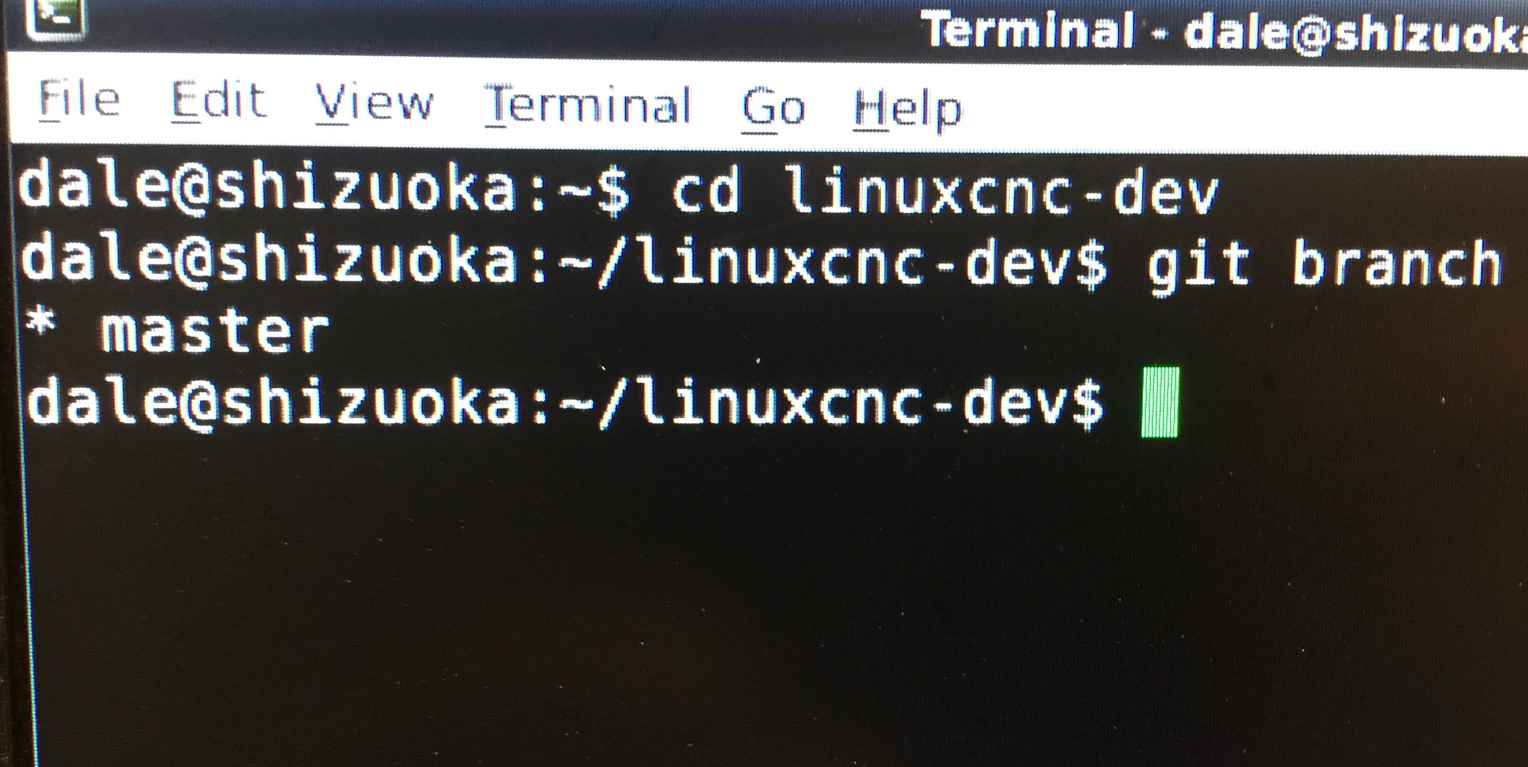

Strange. I used the same manual to compile linuxcnc from source and I got a newest version of Gmocappy.
How do you launch compiled linuxcnc?
Also you must ensure that you compile sources from the master branch
type next command in linuxcnc-dev directory:
$ git branch
You must see output:
* master
$ git branch
* master

- Dale Lusby
- Posts: 50
31 Aug 2016 20:58 #79801
by Dale Lusby
Replied by Dale Lusby on topic gmoccapy 2.1.0 has been released
Here's showing the master

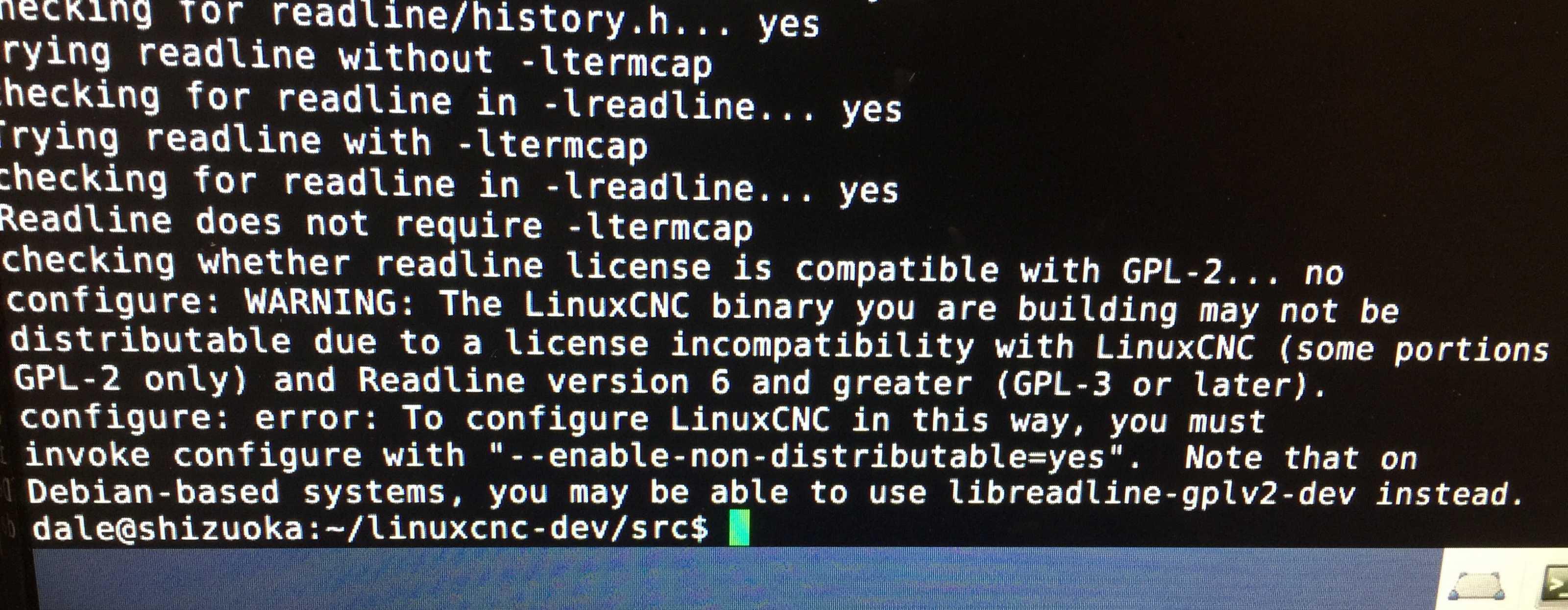

- Dale Lusby
- Posts: 50
31 Aug 2016 21:00 - 31 Aug 2016 21:05 #79802
by Dale Lusby
Here is what may be issue I'm thinking. Would I just type the enable non distributable command that is in parentheses into the Linxucnc-dev directory?

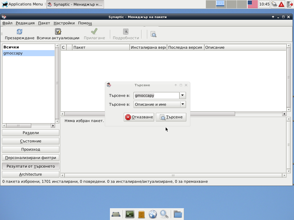

01 Sep 2016 05:04 - 01 Sep 2016 05:08 #79809
by dinkata
www.linuxcnc.org/linuxcnc-2.7-wheezy.iso
with update 2.7.6 . I use DISPLAY= gmoccapy
Please give instructions step by step how to update gmoccapy !
This does not work
wiki.linuxcnc.org/cgi-bin/wiki.pl?Gmocca...w_to_update_gmoccapy
Replied by dinkata on topic gmoccapy 2.1.0 has been released
I need help .I have installed :If you need help, we are here!
Norbert
This does not work

Well ok. You even didn't compile it correctly.
First you need to launch configure script with additional parameter as been sain in error message:
./configure --enable-non-distributable=yes
Then continue with compilation as instruction says.
After successful compilation you need to launch linuxcnc script:
~/linuxcnc-dev/scripts/linuxcnc ~/<some_location>/<your_configuration_ini_file>

- dinkata
- Posts: 101
01 Sep 2016 11:19 #79824
by dinkata
This ??
It works! I used this instruction without any problem.
This ??
3. How to update gmoccapy
3.1. For users
Just do an update using your deb package tool like synaptic.
