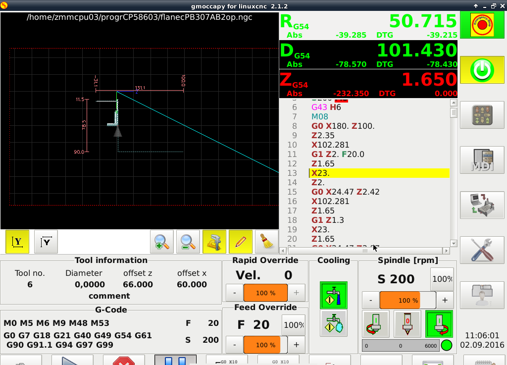

Other little issue is labels on macro buttons, and their alignment.
As you can see on the attached picture. The macro names are not full.
full names are "1_measure_and_change", "2_tool_change", "3_tool_measure"

02 Sep 2016 08:14 - 02 Sep 2016 08:16 #79892 by dinkata
Replied by dinkata on topic gmoccapy 2.1.0 has been released
Well as user you'll get new gmocappy 2.1.0 when linuxcnc 2.8.0 will be released.
I update to 2.8 gmoccapy 2.1.2 a pleasant surprise ,
please note DRO axis Z remains in red after homing ..I use sim_hardware.hal .

03 Sep 2016 08:53 #79960 by newbynobi
That is caused due to space reasons, I will check, if there is a possibility to line brake them automatically on the button.
Norbert

03 Sep 2016 09:02 #79962 by newbynobi
Replied by newbynobi on topic gmoccapy 2.1.0 has been released
If the DRO does not get green, it is not homed. I am not able to reproduce that, because I do not know the content of sim_hardware.hal.
I am convinced, that the home switch of Z is not connected, or you did not home that joint.
Please try with configs/sim/gmoccapy/gmoccapy_lathe.ini
Norbert
