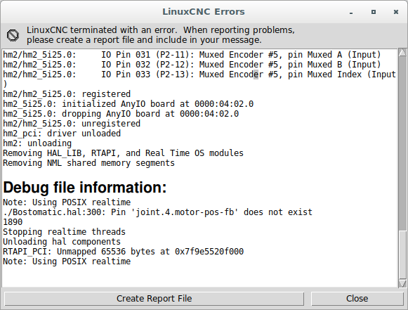

Replied by rodw on topic 5 AXIS?
You need to review this line as pid.b is not loaded.
In the next few days, I think the devs will release 2.8 which will become the distribution versions so yes, it should be much simpler soon!
loadrt pid names=pid.x,pid.y,pid.z,pid.a,pid.sIn the next few days, I think the devs will release 2.8 which will become the distribution versions so yes, it should be much simpler soon!

- eighthaxis
- Posts: 84
- Thank you received: 8

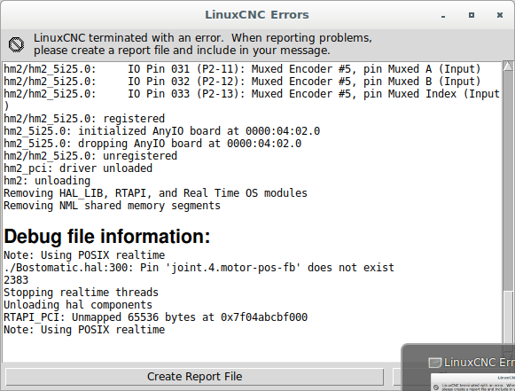

02 Aug 2020 16:14 #176901
by eighthaxis
Replied by eighthaxis on topic 5 AXIS?
Just updated HALUI Signals
Still same error but says 2380 instead of 1890
