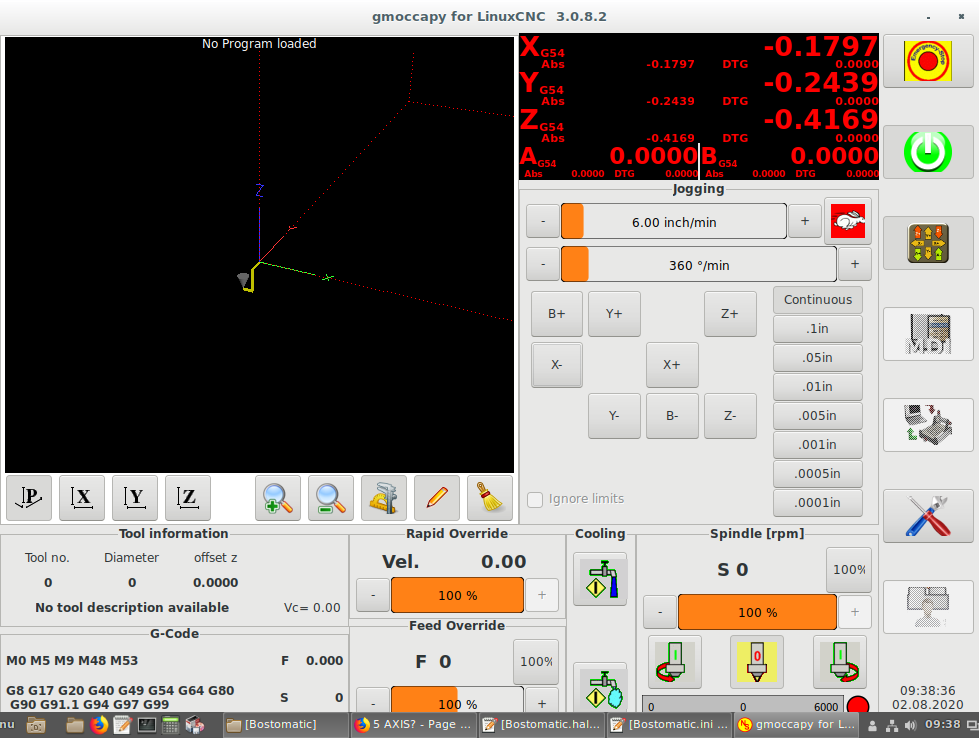

02 Aug 2020 11:37 #176905
by eighthaxis
Replied by eighthaxis on topic 5 AXIS?
Hurray!!!
I figured it out.
Here is the working HAl and INI files just in case this can help someone else.
Thanks for the help everyone.
Now for tuning more IO and Toolchanger setup.
I figured it out.

02 Aug 2020 11:43 #176906
by eighthaxis
Screenshot all 5 axis Gmoccappy

02 Aug 2020 12:47 #176916
by eighthaxis

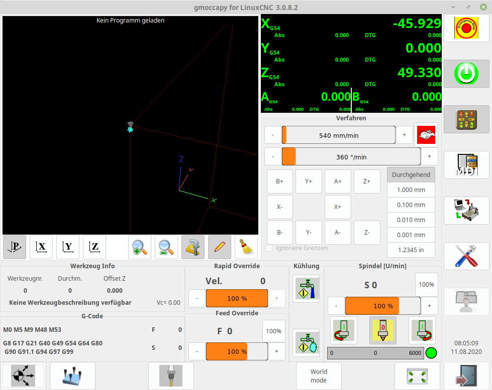

Does anyone know how to add the A- and A+ jog buttons to Gmoccapy?

11 Aug 2020 00:35 #177861
by newbynobi
Replied by newbynobi on topic 5 AXIS?
Very strange, that you did not get the A axis Buttons on the fly.
Let me check that, you may have stept over a bug.
Could you please just open a Sim config with an A axis and see if the buttons are there?
Norbert
Norbert

11 Aug 2020 00:40 #177862
Replied by cmorley on topic 5 AXIS?
The bug has been found and fixed in 2.8 +

- Posts: 7368
- Thank you received: 2181
11 Aug 2020 01:31 #177866
Ha fixing it wasn't enough ?
You change the release on every commit?
- newbynobi
- Posts: 1931
- Thank you received: 394
11 Aug 2020 13:10 #177917
by newbynobi
Yes, I change the release number after every fix or adding stuff.
you will find a relase notes file in the source directory of gmoccapy, that way I can see easy if I already fixed stuff in a later release.
I corrected your mistake;)
