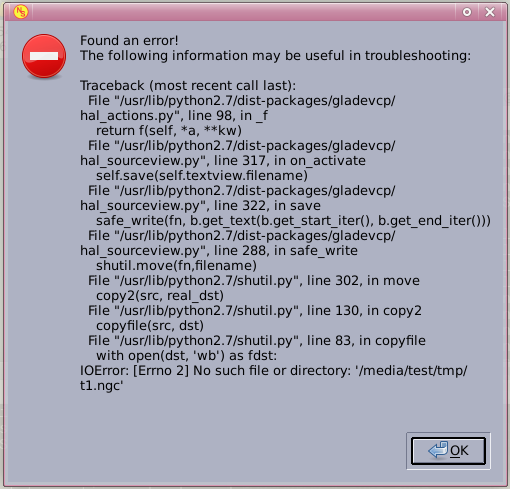

safe_write tries to create a temp file , writes to it and then renames to the desired name so the error seems to be saying that the temp file did not get ccreated.
And yet it also seems to break the hard link to the original file, which, if that's the order of operations, has me puzzled.
Have you tried using Axis or some other GUI? The safe_write function is used there as well.
Yep. No problems editing or saving through Axis at all... But I was under the impression Axis just popped a gedit window, while Gmoccapy uses something more integrated-ish?
Or perhaps look at the ngc path in the gmoccapy ini files,
If you mean PROGRAM_PREFIX, then yes, that's pointing at a directory on the share - but that doesn't (and seemingly shouldn't) matter. If I navigate to work with a local file, it's fine. Navigate to somewhere else on the share, and it breaks again.
the error mesaage is rather typically useless as it doesn't give values for the parameters.
Figures.
You might have to resort to the usual scripted language crutch of adding print statements to glade_vcp/hal_sourceview.py (linuxcnc/lib/python/gladevcp/hal_sourceview.py)
Ugh... I'm at least half a decade out from my coding days, and python was never one of my stronger languages to begin with. I may have to just give up and pop a terminal window with vi when I need to edit something.
Or maybe I'll feel braver tomorrow.
And at least I've got somewhere to start poking.
Thanks,
-Bats

So here's the function in question (thanks for giving me the needed kick in the bats to go looking at it, gerritv - it was more straightforward than I feared):
def safe_write(filename, data, mode=0o644):
    import os, tempfile
    fd, fn = tempfile.mkstemp(dir=os.path.dirname(filename), prefix=os.path.basename(filename))
    try:
        os.write(fd, data)
        os.close(fd)
        fd = None
        os.rename(fn, filename)
        os.chmod(filename, mode)
    finally:
        if fd is not None:
            os.close(fd)
        if os.path.isfile(fn):
            os.unlink(fn)
( from /usr/lib/python2.7/dist-packages/gladevcp/hal_sourceview.py )
It looks like the problem has nothing to do with creating the file... it's the chmod that kills it. Trying to chmod a file on a root-owned smb share as a non-root user gives "Operation not permitted" (and just silently fails when root tries it).
The question is, where do I go from here?
Just commenting out the chmod seems to make things work (the only apparent difference being that the files in local - permission-aware - filesystems end up as rw/-/- instead of rw/r/r), but that sets me up for trouble if an update comes along & breaks my "fix", and does nothing to resolve the issue for anyone else who finds themselves in the same mess.
Would it possible (or advisable) to just silently fail if the chmod fails, instead of throwing a tantrum? Does python allow nested try/catch blocks like that?
And should there be more checking done before unlinking (potentially deleting) the original file at the end, if this is going to be called "safe_write()"?
Any thoughts?
Or is there someone more qualified (read: even slightly qualified) that I can pass this off to?
-Bats

01 Jul 2020 01:51 - 01 Jul 2020 02:03 #173270 by Bats
Replied by Bats on topic Can't save file to samba share
So it looks like I could get the share to mount as user:user by adding ,uid=1000,gid=1000 to the fstab line. While this is a good thing in itself, it looks like it only half-solves (or half-works-around) the saving problem.
Saving a new file to a share mounted this way (at least as long as the share owner is the same user linuxcnc is running as - I haven't tried any other scenarios) works without an error (yay!)... but trying to save to the existing file still complains - although this time it's the os.rename() that it dies on, instead of os.chmod(), and I'm not sure why.
Still digging.
-Bats

01 Jul 2020 02:43 #173285 by Bats
Last update for the night... when entered line by line in the python interpreter, everything seems to work fine (at least with the new user-owned share - the root-owned one still borks on chown)... so I'm at a complete loss for why it's breaking when the application tries it.
Also, I'd made some incorrect assumptions earlier about what the os.unlink was unlinking (and some possibly disparaging & probably unwarranted remarks about the "safety" of safe_write). It looks like that's just a cleanup of the temp file - so something else apparently causes the delinking of the original file. I don't understand that bit, either.
-Bats

01 Jul 2020 21:39 - 01 Jul 2020 21:55 #173343 by Bats
[edit: it should be noted that bats are not known for their burrowing prowess
www.batcon.org/resources/media-education...zine/bat_article/228
That's uncle Henry. Should've known someone would bring up his branch of the family. We don't discuss them. Nesting in rotten logs? Filthy! And that whole "walking" thing is just plain undignified.
But, while we're talking about digging anyhow... On a whim/following a lead, I decided to try replacing os.rename() with shutil.move(), annnnd...
...that didn't work either.
One possible workaround - although I couldn't find anything in the docs... I know Axis is supposed to be able to use vi - Is there any way to use an alternative editor with Gmoccapy?
This time it looks like it's specifically the destination file that it's having trouble finding - suggesting the removal of the hard link had already happened by the time the rename rolls around.
There's definitely something ugly happening between the rename process(es) and the samba share, but I'll be damned if I can figure out what it is. After spending the day struggling with this, I've pretty much hit a wall. I just don't know that I understand python or linux well enough at this point to make much progress. I'd already been forced to resort to trial and error, and now I've pretty much run out of errors to try.
Any other suggestions, ideas, or sheer random guessing?
[ edit: One possible workaround - although I couldn't find anything in the docs... I know Axis is supposed to be able to use vi - Is there any way to use an alternative editor with Gmoccapy? ]
-Bats
(not the digging kind, more's the pity)
