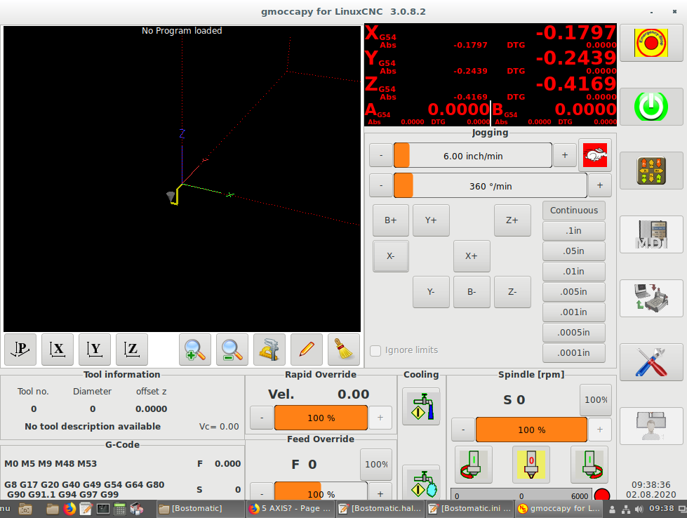

Does anyone know how to add the A- and A+ jog buttons to Gmoccapy?

In the INI:
[TRAJ]
COORDINATES = XYZA
[TRAJ]
COORDINATES = XYZA

Thanks for the input guys but Ithink I have Trajectory section correct.
Here are the files:
Here are the files:

looks like it might be a bug in Gmoccapy - the sample config XYZAB doesn't show A

Replied by cmorley on topic Edit Jog Buttons
What version of linuxcnc are you using?
I found the bug.
I found the bug.

Are you using 2.7, 2.8 or master version of linuxcnc?
Pushed the fix to 2.8 and master.
