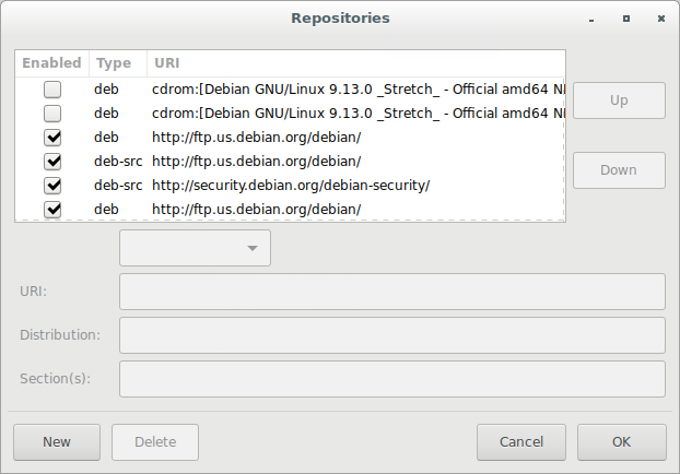

Please post a Screenshot from your repository from synaptic
Can you access pages in the internet, as it might be also a network probelm.
What about:
ping www.google.de
Norbert
What about:
ping www.google.de
Norbert

18 May 2021 11:48 #209361
by eighthaxis
Replied by eighthaxis on topic Edit Jog Buttons
OK Tommy I tried your suggestion here are the results:
- eighthaxis
- Posts: 84
- Thank you received: 8

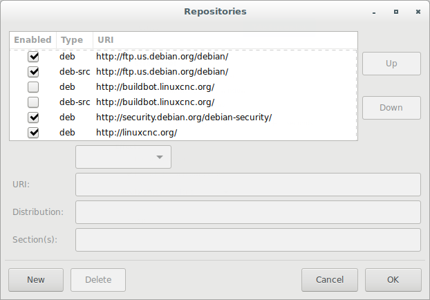

18 May 2021 12:04 #209365
by eighthaxis
Here are the screenshots.
- eighthaxis
- Posts: 84
18 May 2021 12:45 #209369
by eighthaxis
I was able to get it to update with this to find the missing GPG Key:
sudo apt update 2>&1 1>/dev/null | sed -ne 's/.*NO_PUBKEY //p' | while read key; do if ! ${keys[*]} =~ "$key"; then sudo apt-key adv --keyserver hkp://pool.sks-keyservers.net:80 --recv-keys "$key"; keys+=("$key"); fi; done
It update to 2.8.1
But GMOCCAPY only updated to 3.0.9.1
How do I get it to update to 3.1.3.XX ?
It update to 2.8.1
- newbynobi
- Posts: 1931
- Thank you received: 394
18 May 2021 13:24 #209372
by newbynobi
Replied by newbynobi on topic Edit Jog Buttons
Your problem not seeing some jog buttons has been fixed with 3.0.8.2, so you should be fine for now.
As soon as a new build has been made from LinuxCNC repository, you will get automatically the updates.
Norbert
Norbert
