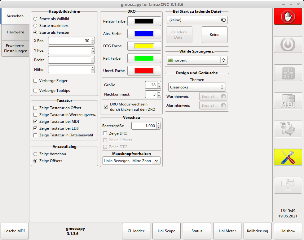

I think they are in the config screen.
Replied by bevins on topic Edit Jog Buttons
I do have the A jog buttons now and they work.
Is there any way to use Show HAL, HALScope, HALconfig while using GMOCCAPY or are the only usable from AXIS?
The following user(s) said Thank You: eighthaxis

19 May 2021 09:15 #209513
by newbynobi
Replied by newbynobi on topic Edit Jog Buttons

19 May 2021 23:33 #209611
by newbynobi
It's includes,
Second button from the right in the image of my previous post.
