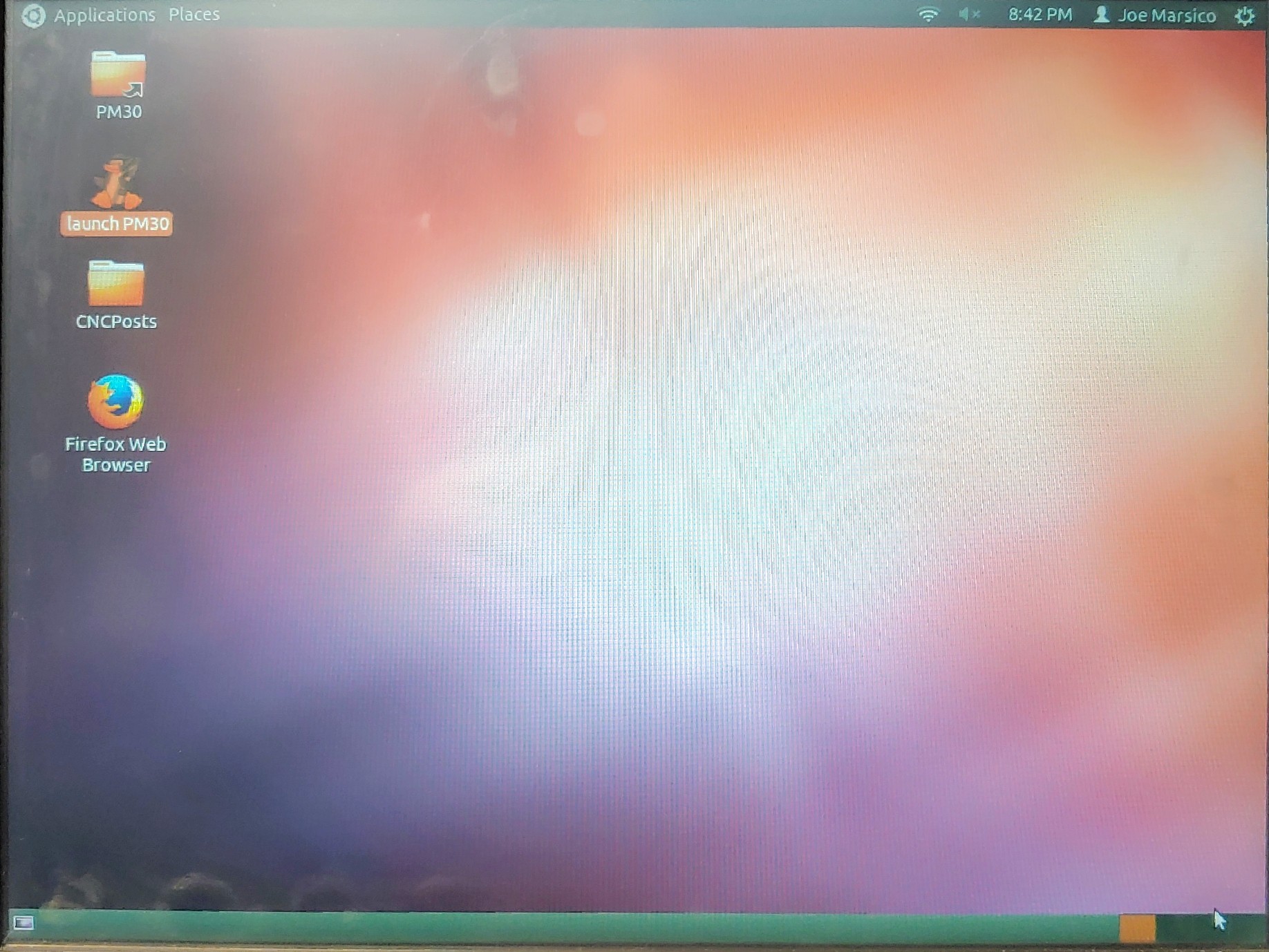

With window manager I meesn do you use XFCE or Mate or Chinamon or... as Desktop envionment. If you do not know that, just post a Screenshot of the desktop, I should see then witch one you use. I need this information, because the error reports an X11 error.
It will also be helpful to know if you use a propiatary grafice driver as Nvidia or an AMD one.

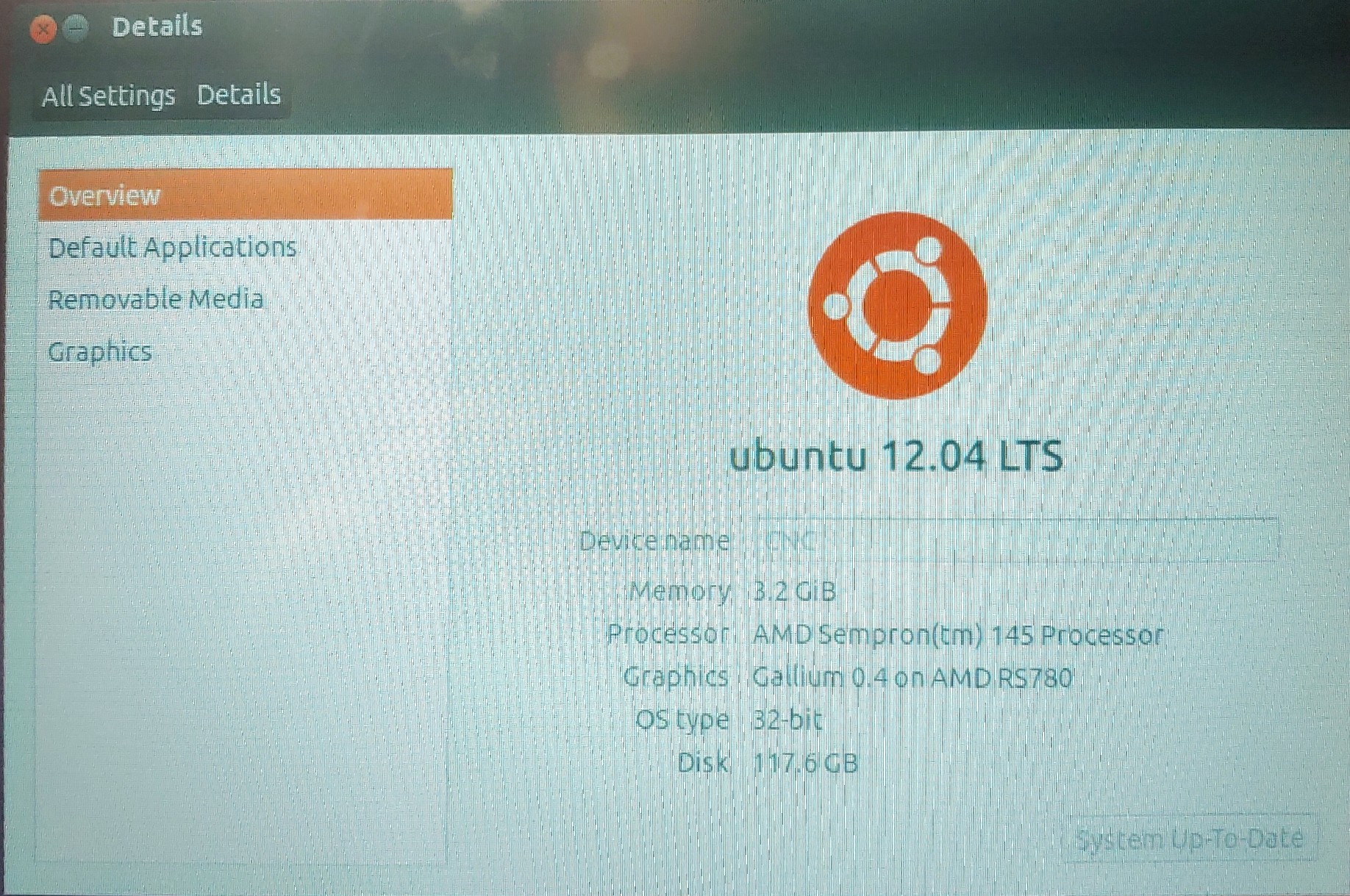

I really hope we can work together to get it working! Gmoccapy is absolutely my favorite GUI for LinuxCNC and I would love to get 3.0 working because it has a lot of features that I really enjoy over the past version. I have run plenty of programs now to be confident that the rest of the functionality of the program is working perfectly, it's just the issue with the buttons crashing Linux that I have now and I don't have a quick way to avoid it because I really can't do anything without touching those buttons.
As for the sim configuration, I ran it tonight as you suggested and got the exact same crash I have been experiencing in my system. Separately, something I have noticed now is that I seem to be possibly having latency issues in the crash report? When I run the latency test, I am still getting good numbers all under 10k ns for both base and servo thread even with the system loaded. But with LinuxCNC open, I will sometimes get a latency warning in the control which I never have before and the crash report is saying that there are high latency points detected. So far, it hasn't effected the machine running but I am worried that it could and I never experienced it before.

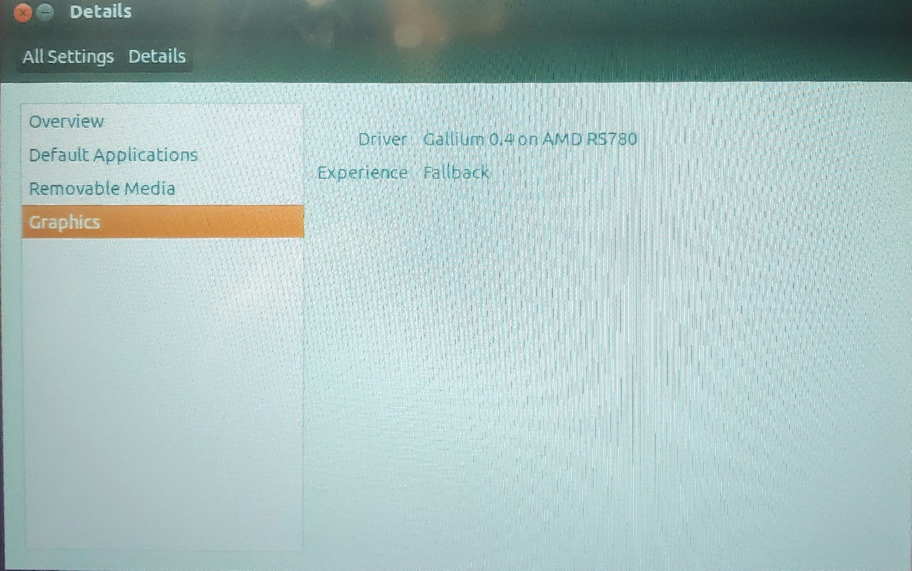

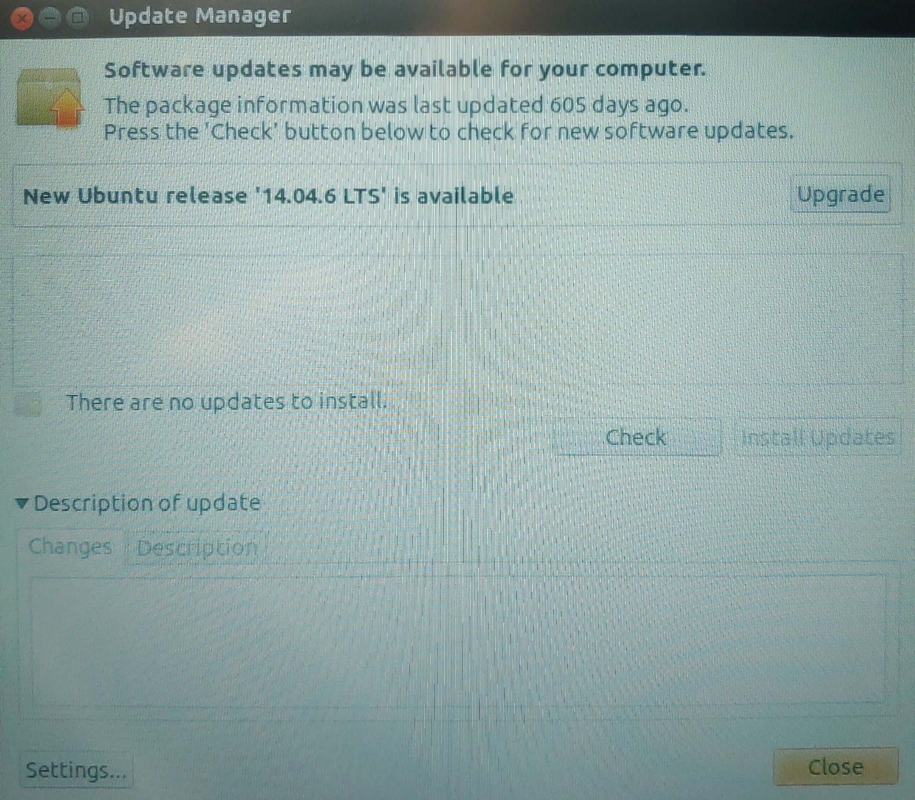

Attached I added some pictures (quicker for me than screenshots so I hope they are ok). Shows a bit more details of my hardware as well as software. I am still using Ubuntu 12.04 rather than the upgraded 14 version simply because I am worried that if I upgrade, I will have system issues (the same reason I was worried about upgrading LinuxCNC). I am very new at Linux and fear that if I have software issues I may not be able to solve them so I try to stick to what works. Do you think the out of date version of Ubuntu could be the reason? If you recommend upgrading, do you think it will cause any issues for me?
As for drivers, I believe the one picture gives that information. I originally had a separate GPU in the system but was getting extremely bad latency. I removed the GPU and have been using on board graphics since with no issue until now so I am not sure if that has anything to do with it.
I really hope to get it back up and working soon, this is my main CNC machine and with this issue I basically can no longer use the machine as it crashes so often when trying to set WCS and changing jog speeds/incriments so until I can get this fixed I am in some trouble getting work done. I understand you are busy and you definitely don't owe me anything but I really appreciate all of your help you are giving me.

Ubunt Precice : End of Support April 28, 2017 and you use 32 bit!
I tried to reproduce with DEBIAN and MINT releases witch are named to support LinuxCNC release 2.8 and have not been able to reproduce any crash of the GUI. So I have to assume, that your error is related to the very old OS you use. One mayor matter could be, that you use a 32 bit release! LinuxCNC with actual releases do only support 64 bit OS !!
Are you able to mount a new HDD in your PC and install a modern release? I would recommend a buildbot or ISO Image, as that ones do most of the configs for you. And check if your com do support 64 bit, if not, you will need to buy a new one.
Norbert

Thought I would provide a final update on this in case anyone else ever finds themselves having this issue in the future and stumble on this thread.
As Norbert suggested above, it seems to be entirely driven by my extremely old and outdated version of Linux. I attempted to upgrade to Debian 10 and it definitely fixed the issue with Gmoccapy, however, I was getting latency numbers in the 30k range which is unacceptable for my system using a parallel port. If you're using a hardware stepgen, I'm sure this would work just fine.
In the end, I went with Debian 9 RTAI and then upgraded back to LinuxCNC 2.8 after the install and all of my problems are solved! Little note on that, XCFE also gave me slightly worse latency in the 15k range so I stuck with Xsession and I'm back down to the max Latency range of about 3k.
No issues at all with any of the functionality of Gmoccapy and I'm back up and running. Debian is all new to me so I'm having some trouble sharing files on my network like I was doing with Precise, but I'm sure I'll come through that. I also had the machine freeze up on me once during a manual tool change in the middle of a program and had to restart the computer to recover it. Not sure why that happened and it has been running fine since.
Thanks again Norbert for all of your help!
