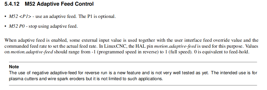

I didn't know about this "reverse-run" so I collected the information I found:
This is from the changelog:
* Reverse-Run: Negative feed-override will now run the G-code path in
reverse.
Then I found this on motion docs:
motion.adaptive−feed IN FLOAT
When adaptive feed is enabled with M52 P1, the commanded velocity is multiplied by this value. This effect is multiplicative with the NML-level feed override value and motion.feed−hold. Negative values are valid and will run the G−code path in reverse.
Then this in the main docs:
Last edit: 12 Oct 2020 02:26 by Aciera.
