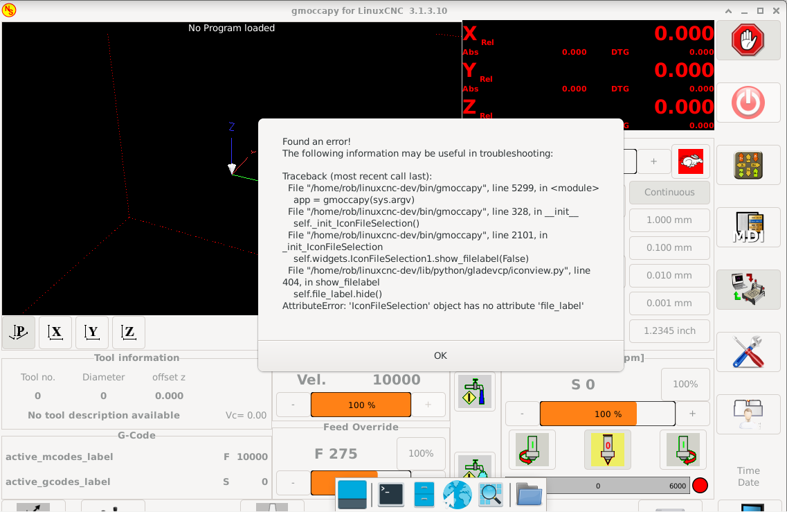

first failure was OpenGL (no module named).
so I've installed Python3-opengl
and it starts ...... sort of..... as it halts with a message on the screen.
(attached are all of the logs).

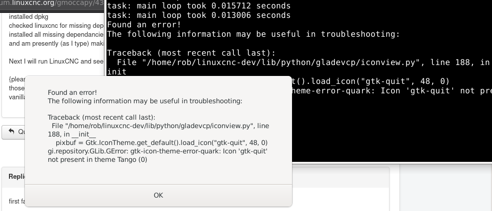

The problem is that it cannot seem to locate some standard GTK icons from within the Tango theme (which it appears to be the default theme installed as part of the Bullseye XFCE desktop install).

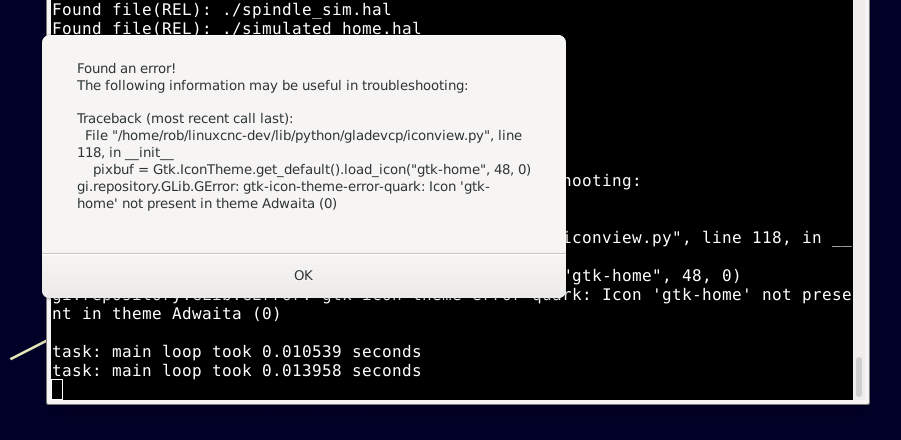

Interesting..... but baffling (to me!)
I changed the theme to Adwaita (via the appearance app (settings >>> appearance >> Icons)
And gmoccapy threw a slightly different error message..... different icon missing as the first error thrown.
"gtk-home" not present.
The way i "fixed" this yesterday was I installed a load of themes..... and somehow it seemed to sort it's self out..... thing is I did not learn what the problem is / was or what the actual fix is....

I ran a find / -name gtk*.png and came up with the following list of gtk icons
- robertspark
- Posts: 915
- Thank you received: 216
31 Aug 2021 21:42 #219291
by robertspark
Replied by robertspark on topic Gmoccapy Theme?
Figured it out......
I installed gnome-icon-theme and it added the missing icons.....
attached the linuxcnc terminal output of the successful load.
And attached an updated find gtk*.png to show the additional png icons added that gmoccapy must have been looking for.
