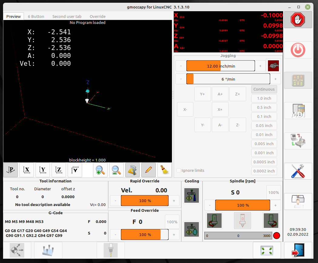

I have been updating a older computer in the past several days that runs gmoccapy for its UI. Its running on Linux Mint Cinnamon version 21 and Linux cnc-1 5.19.6-rt10 #2 SMP PREEMPT_RT Thu Sep 1 10:37:18 AKDT 2022 x86_64 x86_64 x86_64 GNU/Linux.
Gmoccapy version is 3.13.10 and running in place with development master.
It is mostly working from what I can tell but I noticed is that the angles show in the preview were all in MM while the DRO's were all indicating in inch. This difference remained until I clicked on the  make the preview as large as possible button near the lower right of the UI. The preview display then showed the angles in inches when returning back to the normal size of the preview window.
While trouble shooting this I also noticed that there is a duplicate line in gmoccapy at 2258, self.widgets.btn_jump_to.set_sensitive(self.widgets.IconFileSelection1.btn_jump_to.get_sensitive())

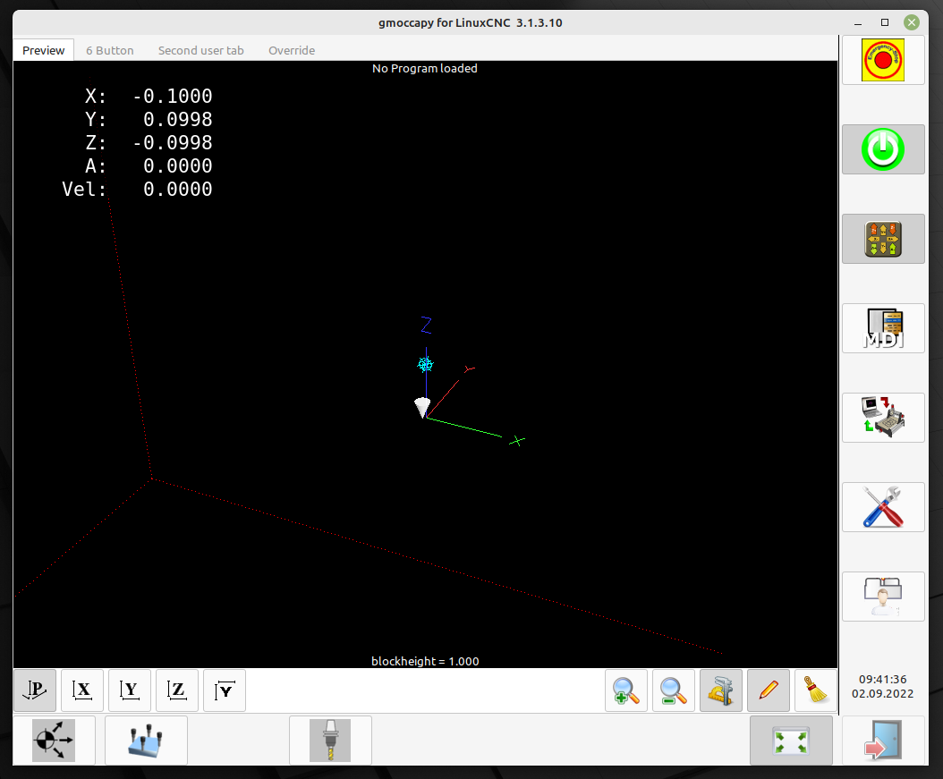

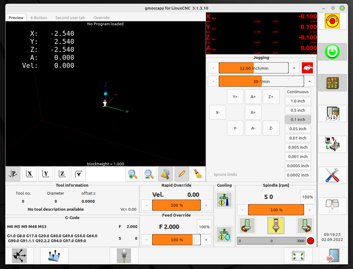

Here is a picture showing difference between DRO's and Preview. But switching to fill preview screen and back did not fix this and only drifted the positions slightly. Stopping and restarting linuxcnc was required after that.
Initial screen
After restart
And selecting full display screen
