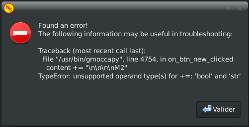

Error when creating new program

21 Sep 2022 08:23 #252486
by HansU
Replied by HansU on topic Error when creating new program
Can you post your config or does this also appear on a sample config for you?
I cannot reproduce this.

21 Sep 2022 17:15 - 21 Sep 2022 17:17 #252527
by HansU
You found a little bug in Gmoccapy.
This happens if you don't have an entry for "RS274NGC_STARTUP_CODE" in the INI file.
You can avoid this by providing some startup code like
or just a comment
[RS274NGC]
RS274NGC_STARTUP_CODE = G90[RS274NGC]
RS274NGC_STARTUP_CODE = (a comment)
Last edit: 21 Sep 2022 17:17 by HansU.
The following user(s) said Thank You: macsddau@linuxcnc

21 Sep 2022 19:04 #252531
by macsddau@linuxcnc
Replied by macsddau@linuxcnc on topic Error when creating new program
Added the required line with some G codes. Works fine.
Thank you HansU
