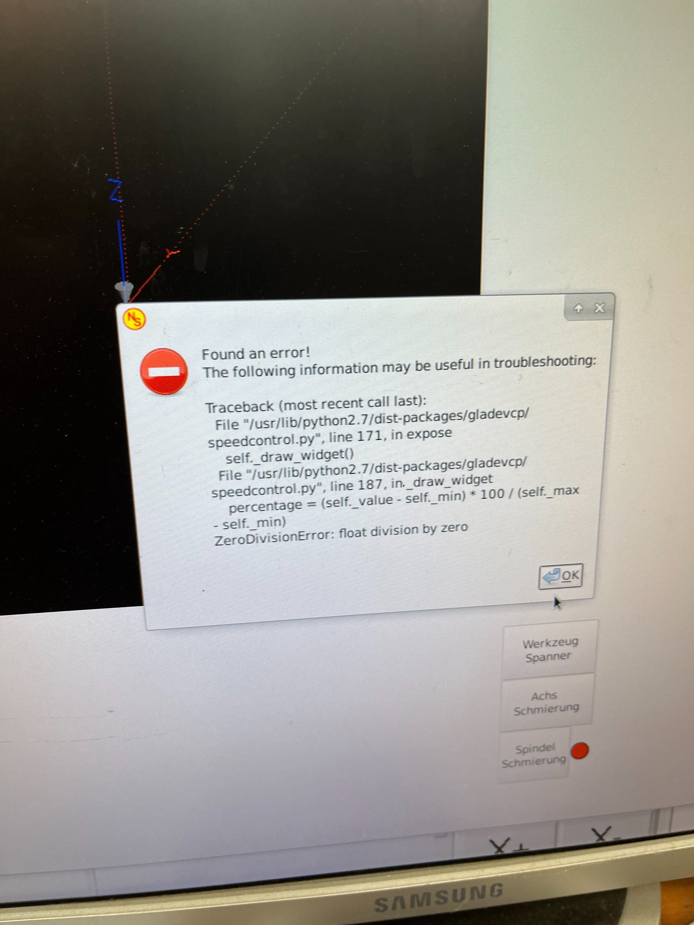

When starting Linux CNC I get an Error message not the usual one like when missing a letter in a variable or so, but a different one, that seems to come directly from gmocapy. It gives me the following debugging Information:
Found an error!
The following Information may be usefull in troubleshooting:
 File "/usr/lib/python2.7/dist-packages/gladevcp/speedcontrol.py”,line171, in expose self.draw widget()File "/usr/lib/python2.7/dist-packages/gladevcp/speedcontrol.py”,line187, in_draw_widgetPercentage = (self._value-self._min)*100/(self._max-self._min)ZeroDivisionError: float division by zero

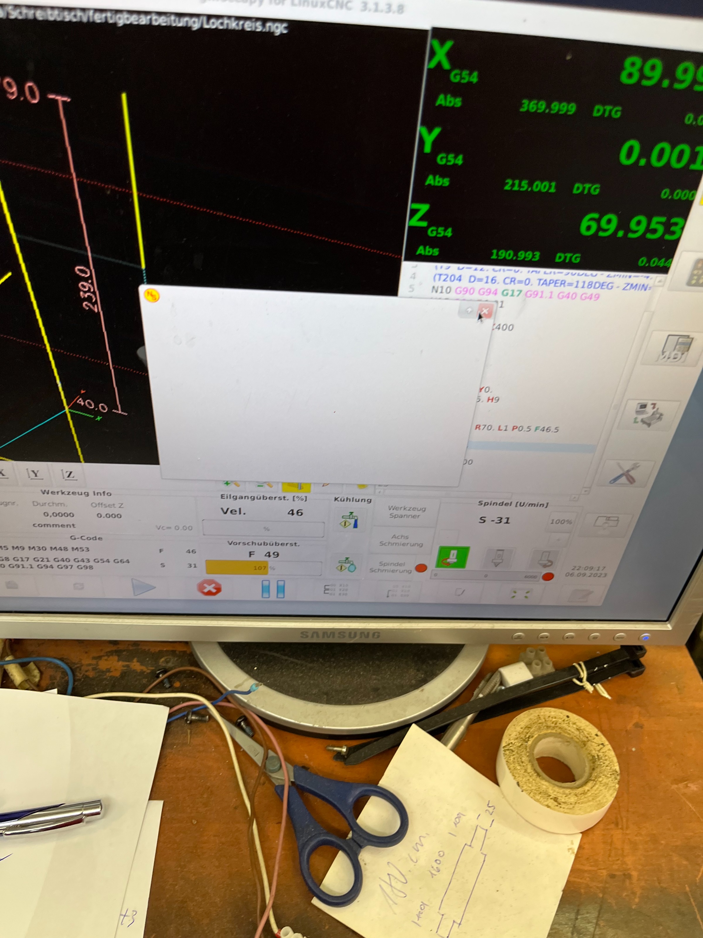

When gmocapy is working then I get random popups that are empty. They show up when turning the machine on a couple of times when running a program… and the screen freezes completely when they open but the machine keeps working.
So I dug a little into that stuff looked at the files and so on and I found out that this behavior is somehow related to the Spindle override min max value. I had set those both to 1 since I don’t want any override because this can initiate a gear change while the machine is running or even milling however when the machine switches gear first thing it does is stop the spindle so doing it while milling is does not end well.For tests I went ahead and set the min to 0.5 and the max to 1.5 in the ini file. This changed the behavior, Linux cnc would not start up any more and I had to abort it were I got the following error message:
Debug file information:Note: Using POSIX realtime (classicladder:5161): Gtk-CRITICAL **: 01:44:34.414: IA__gtk_widget_get_parent: assertion 'GTK_IS_WIDGET (widget)' failed/usr/bin/gmoccapy:312: GtkWarning: Invalid icon size 48   self.widgets.window1.show() (gmoccapy:5171): GtkSourceView-CRITICAL **: 01:44:36.012: gtk_source_language_manager_set_search_path: assertion 'lm->priv->ids == NULL' failedWaiting for component 'py_wechsler' to become ready......................................................................................Traceback (most recent call last):  File "./python/py_wechsler.py", line 225, in <module>    hal.set_p("toolchanger.hal_led_arm_draussen","0")RuntimeError: pin not found/usr/bin/linuxcnc: Zeile 896:  5171 Getötet                $EMCDISPLAY -ini "$INIFILE" $EMCDISPLAYARGS $EXTRA_ARGS51365168Stopping realtime threadsUnloading hal componentsRTAPI_PCI: Unmapped 65536 bytes at 0x7f656aa4a000Note: Using POSIX realtime
 It seems something is screwed up with the widget size but I don’t know why and how to fix it. However this seems to stop the loading of gmocapy, because of the loading of gmocapy being stopped the embedded glade panels do not get loaded  and therefore the embedded python script py_wechsler (that is for the toolchanger) cant set the LED pin that is created by the embedded glade panel when it gets loaded. In my embedded python scripts I have a delay at the beginning to make sure ale the bins are there when the script starts working and I set that to 10s on the py_wechsler for troubleshooting but It does not seem to change anything.After that I read the documentation and tried the values 0.5 and 1.2 that were given there and this caused the same behavior than 0.5 and 1.5. Next I commented out the lines in the ini completely and everything worked and the spindle override was from 10 to 100 percent as described in the documentation as default. So now I need to find a way to disable the spindle override or modify something so that min1 and max1 works.  Maybe this caused a problem in 2.7 already, but the error messages are new? When gmocapy starts with the min and max being 1 it does not show the override slider in 2.8 and I can not remember if it did in 2.7.I will try to attach everything I think is needed to follow my problem If you need something else please let me know.

13 Sep 2023 04:44 #280591 by newbynobi
Replied by newbynobi on topic Spindle override problems after update to 2.7
Hallo Peter,
This is Norbert also from Germany (31171 Nordstemmen ) and we'll come to this lovely community.
First never et Min and Max to the same values, neverthereless you have opened a bug with your comment, as the "Division by zero" should not ocur.
I had a quick look at the files you posted.
First  think I noticed is that you load your glade files in the INI file without any added parameter. That causes very often race conditions, that could leas to the errors you are seeing.
Load the glade panel with the documented parameters, like:
gladevcp -c gladevcp -u hitcounter.py -H manual-example.hal manual-example.ui
- c = name of the component
- u = the related python scribt to add additional behavior as pins adding, theme loading etc,
- H = the Hal file to be loaded after the panel has been realized, so all Hal connections to the panel belong here!
Norbert
