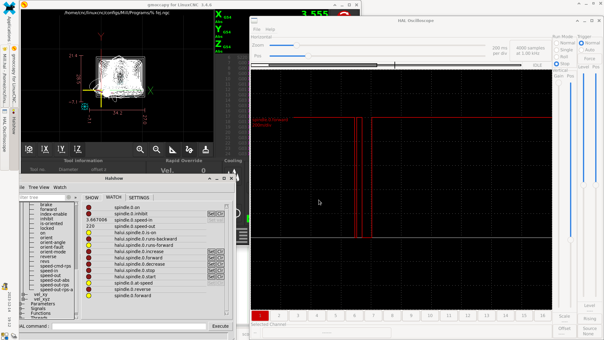

Hello,
I found a weird problem in the newest Linuxcnc (v2.9.1) with gmoccapy gui (3.4.6). The problem is with spindle signals. When a running program stops with Program Stop button from gmoccapy, or with halui.program.stop signal, the spindle does not stop (in the previous versions, on program stop, the spindle is stopped too). Better say, as you can -see on screenshot- the spindle stops a short time, and sets back again. I tested it on my own configs, and in simulations too, and in both cases the behavior is the same. If i press 5x-10x the physical button linked to halui.program.stop, 1x-2x stops the spindle, and does not restart it. If the spindle stopped, and press the Program Stop button again (phisical button -> halui.program.stop) the spindle started. It is very dangerous!!!

Yes, I can reproduce this in a sim config, I've had other issues with gmoccapy and qtdragon on some computers lately like this one:
github.com/LinuxCNC/linuxcnc/issues/2753
The problems seem to depend on the hardware and look like race conditions between the realtime and the non-realtime (ie gui) parts of linuxcnc. Axis Gui still seems to be solid.
Rather unsettling and difficult to troubleshoot I'm afraid.

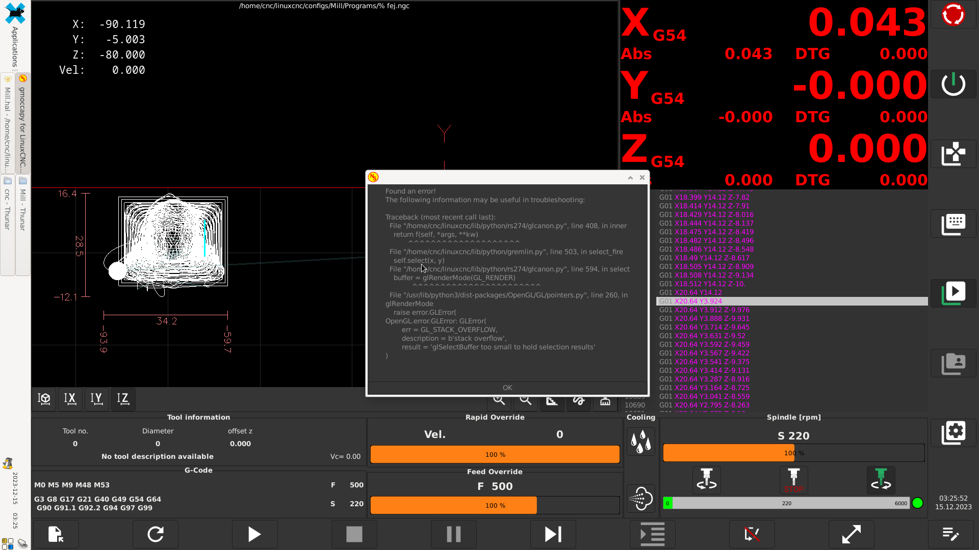

Is it same bug?
github.com/LinuxCNC/linuxcnc/issues/2631

Current content is:
As we only want to select a single line it seems wrong to keep increasing the buffer size.
Code:
try:
buffer = glRenderMode(GL_RENDER)
except OverflowError:
self.select_buffer_size *= 2
continue
break

Also
does not seem to catch the error in the first place.
Code:

I have created a pull request:
github.com/LinuxCNC/linuxcnc/pull/2792/files
