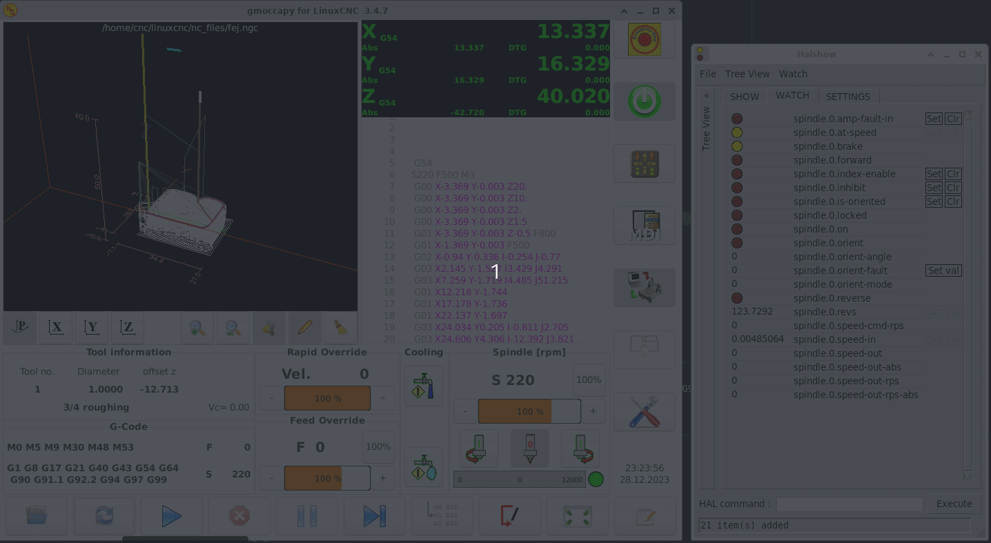

I am trying now in v2.9.1, gmoccapy sim.
If i open arcspiral.ngc, or 3dchips.ngc from nc_files, i can't reproduce the problem, but if i open my gcode file (%fej.ngc - attached) the spindle is restarts after i press the program stop gui button.
I will try to find which g code in the file causes this behavior.
Please try to run and stop the attached file.

I think the problem was in the length of the file.
My original gcode file (fej.ngc) has about 12k lines.
I deleted 1k lines from the end of the file (M30 remains on the end of file) while the bug remains.
The Spindle restart bug disappeared if I deleted ~10k lines from the program.
When the file has 3k lines, the spindle restarts after the program stop button is pressed, a file with 2k lines not - works how it needs to.
I think with this method you can reproduce the bug.

I assume this is the same issue:
2.10.0-pre0-3740-g5ec17ac2b8
The only way I've been able to reproduce it consistently is by starting and then stopping immediately, but when I recorded this video it happened without fail.
I think it's related to how the state is restored from a state tag after an abort(?).
If I comment out emcTaskStateRestore(); at line 2078 in emctaskmain.cc the spindle doesn't restart.
