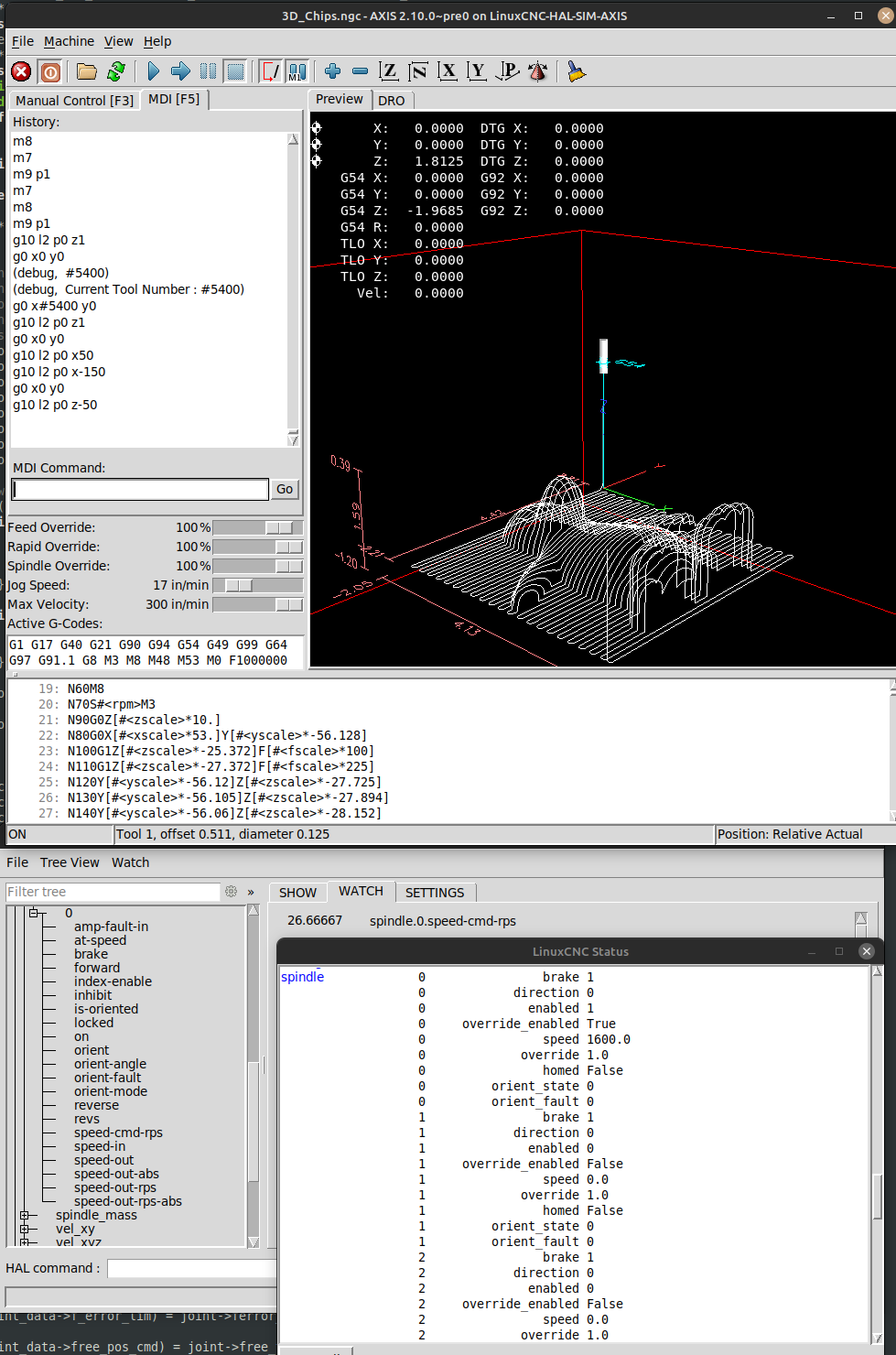

24 Oct 2024 05:16 - 24 Oct 2024 05:19 #313046 by MennilTossFlykune
Replied by MennilTossFlykune on topic Gmoccapy - spindle restarts at program stop
Yes. I have a real machine with QtDragon where this has been happening for some time now but I thought it was caused by something else until I noticed it happening in a simulation as well. I did some more experimenting and I discovered that if I have a G64 with a large P value, like 1 for example, the spindle doesn't restart. The smaller the P value is the further into a program it has to run before the spindle doesn't restart after an abort.With a G61 the spindle always restarts. I've only used 3D_Chips.ngc to test it.
I think this is related to what's happening:
github.com/LinuxCNC/linuxcnc/issues/579#issuecomment-640557582
This sure does sound related to #865 and #882, where readahead segments aren't dropped during task abort, and get flushed into the queue by commands following the abort: the ON_ABORT_COMMAND in this case, and the restored state tag in the case of #865.
However, in my quick test, I couldn't tickle the bug in the 2.8 branch by adding the ON_ABORT_COMMAND from @sheetcam's config. Anyway, if it is the same problem, hopefully #882 will fix it.

24 Oct 2024 07:15 #313065 by MennilTossFlykune
Yes. I tested it now on 2.10 RIP and it seems to behave like how I described.
24 Oct 2024 07:47 #313070 by Aciera
Replied by Aciera on topic Gmoccapy - spindle restarts at program stop
Yes, I can reproduce this as well (took me a few tries but eventually I also got the spindle to still run when the program stopped):

24 Oct 2024 07:49 #313071 by Aciera
Has this been filed as an issue on github yet?

24 Oct 2024 09:01 #313087 by MennilTossFlykune
I'm still not sure exactly how to describe this issue, I can only demonstrate it.
You can see here how G61/G64 are related to this:
The larger the P value the further into the program the interpreter will be able to read.
If the interpreter has reached a queuebuster when the program is aborted, the interpreter state and machine state will be synched properly(?)

24 Oct 2024 10:41 - 24 Oct 2024 10:43 #313101 by Aciera
Looks like this might be limited to spindle speed and direction pins not consistently reacting to a program stop as 'spindle.0.on' seems to always clear.
