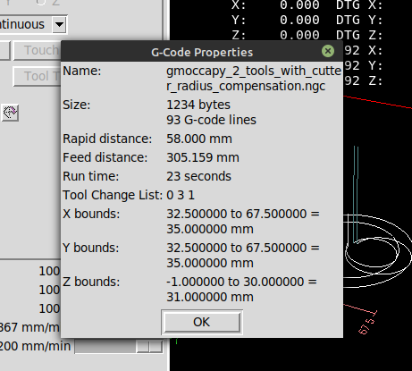

I would expect it to list all the tools from the program. Do you have more T in the program? T5, T4, T100 ....
Just uncomment the print statement in gmoccapy.py:4011 of my dev branch: github.com/hansu/linuxcnc/tree/gmoccapy-3-5-0
Yes I used a program with some different T commands...
12 Jan 2025 20:05 #318820 by Aciera
Replied by Aciera on topic Gmoccapy 3.5.0 - opinions needed
Seems to work on axis (2.10):

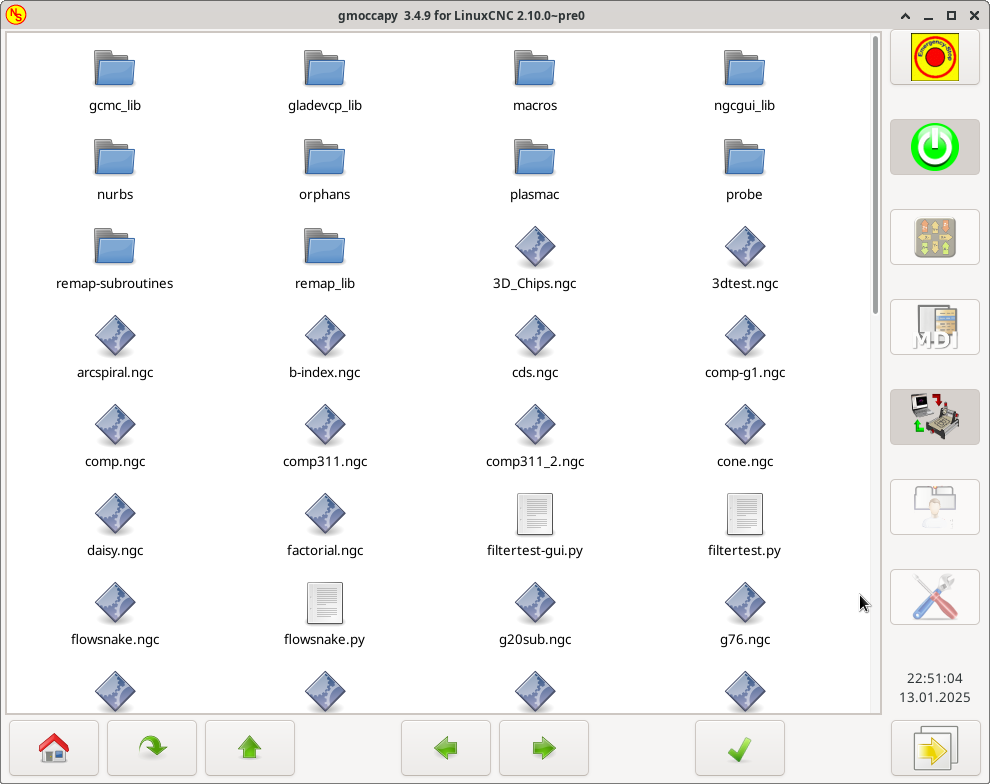

Hallo Hans,
I do like your modifications. I prefer the progress bar under the g-code.
About the Icon it's just a matter of taste IMHO, I do not like the black and white icon, but I also see the need to reorder the button to reduce mouse movement.
G-code Properties is a nice feature, witch I would like to see ;-)
Even knowing that the values shown are not correct in most cases. But they do give a first impresion!
About the File Chooser widget, I was thinking for long time about a Widget designed like the Midnight Commander but unfortunately I have not even started to write the first line of code .
Norbert

13 Jan 2025 22:01 - 13 Jan 2025 22:04 #318889 by HansU
Replied by HansU on topic Gmoccapy 3.5.0 - opinions needed
This file gives me this. Still an emtpy tool list:
G-code properties: {'name': 'gmoccapy_2_tools_with_cutter_radius_compensation.ngc', 'size': '1234 bytes\n93 gcode lines', 'g0': '58.000 mm', 'g1': '327.121 mm', 'run': '25 Seconds', 'toollist': [], 'x': '31.000 to 69.000 = 38.000 mm', 'x_zero_rxy': '31.000 to 69.000 = 38.000 mm', 'y': '31.000 to 69.000 = 38.000 mm', 'y_zero_rxy': '31.000 to 69.000 = 38.000 mm', 'z': '-252.287 to -221.287 = 31.000 mm', 'z_zero_rxy': '-252.287 to -221.287 = 31.000 mm', 'machine_unit_sys': 'Metric', 'gcode_units': 'mm'}
Also a bit weird that it has the tools 0, 3, 1 in the list in Axis, but there is only T3 and T1 in that file.
We can also have this icon in yellow, no problem ;-)
You mean that one that looks like the Norton Commander, so text based only?

Midnight Commander / Norton Commander:
Yes I was thinking about a two parted window where you may select in each window a different content and with the bottom button it should be possible to copy, rename, move ore load the content of the selected file.
Norbert
14 Jan 2025 07:14 - 14 Jan 2025 07:22 #318927 by Aciera
How are you accessing those properties, through the gstat-module?
Last edit: 14 Jan 2025 07:22 by Aciera.
Hmm I think a split view is not so suitable here as this is only to load files. i think for copy or move operations you should use the systems file manager. But renaming could be supported.
Yes: github.com/LinuxCNC/linuxcnc/commit/5838...f0ddf6aa125c0885dcde
14 Jan 2025 09:05 #318931 by Aciera
Maybe a bug in gstat then. It seems to work in QtDragon but I have no idea if that uses the same module. Chris would likely be the one to ask.
