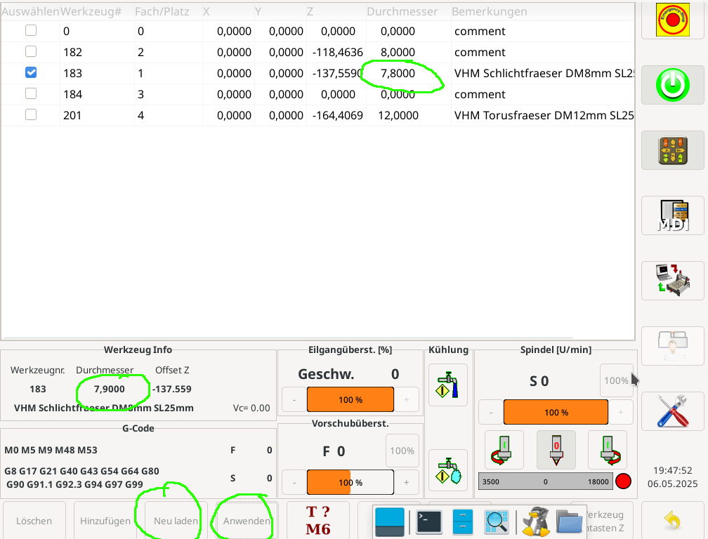

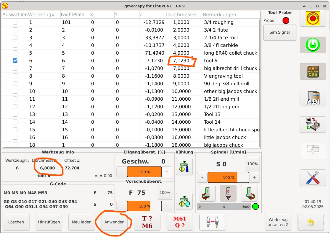

Hello everyone,
I have a problem where, after changing the diameter or Z offset in the tool table for an active and loaded tool, the values aren't immediately applied. Even if I click the "Apply" button.
I have to explicitly unload the tool and reload it with M6.
Unfortunately, I can't figure out how the Apply button works.
Maybe someone here can help me. Thank you very much.

If you edit the tool table, save the changes, re-load the tool table in the GUI and then issue a G43 in MDI then the tool diameter really should change.
Maybe it's the "reload tool table" step that is missing?

The tool is in the spindle - no program is running --> Tool changed in the tool table --> Confirmed with Enter --> Clicked Apply --> Clicked Reload --> Then tried in MDI G43 - the diameter doesn't change in the tool info box.

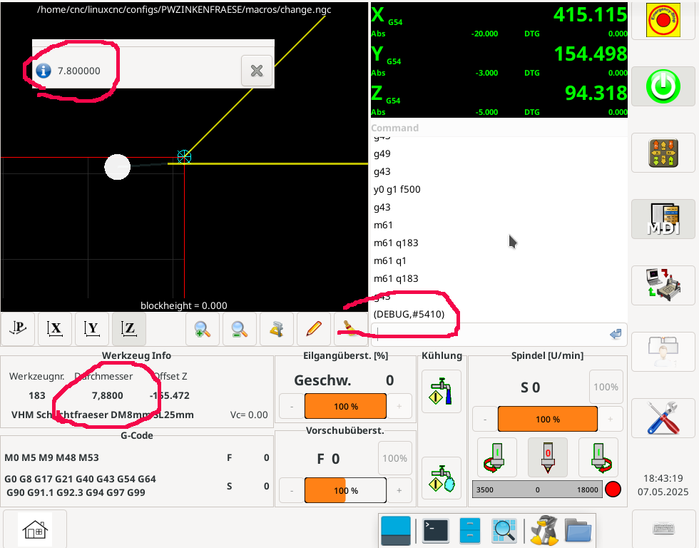

Can you enter in MDI
(debug,#5410)
to see what diameter linuxcnc use in gcode

Thanks for your answer. Attached the result.Linuxcnc works with the changed value. But the GUI doesn't recognize the change.
