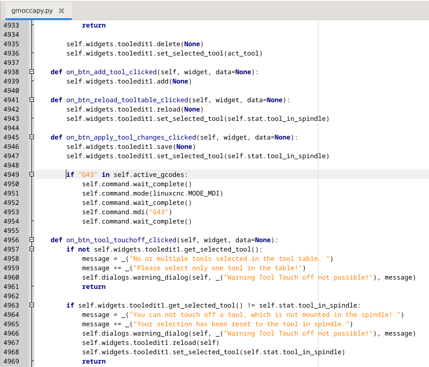

09 May 2025 19:29 #328099 by zz912
You can easy change it.
Add this code to gmoccapy.py file to "def on_btn_apply_tool_changes_clicked"
        if "G43" in self.active_gcodes:
            self.command.wait_complete()
            self.command.mode(linuxcnc.MODE_MDI)
            self.command.mdi("G43")
like this:
1) G43 must be activated
2) after input new value in cell you MUST confirm it for example by key ENTER, then you can click on Apply
3) after click on Apply button you will see right correction value

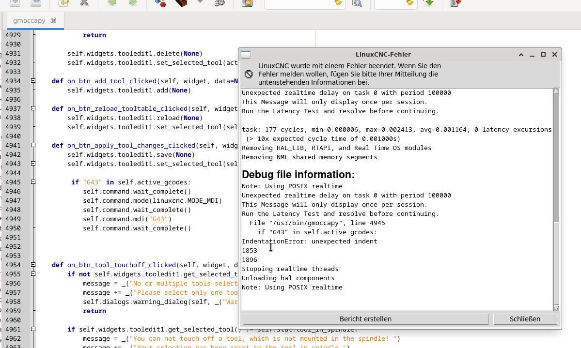

10 May 2025 03:23 #328121 by hermann1976
Replied by hermann1976 on topic Change Tool Offsets after editing the Tool Table
Thanks for your answer.
But Linuxcnc will coming up with an error:
10 May 2025 04:48 #328124 by zz912
You probably have tabs on that line instead of spaces.
10 May 2025 05:04 #328125 by zz912
It's a good idea to set this permanently in Geany:
stackoverflow.com/questions/5287849/how-...e-in-geany-on-ubuntu
I tested the code yesterday and found that it's a good idea to go back to MANUAL_MODE:
            self.command.mode(linuxcnc.MODE_MANUAL)
