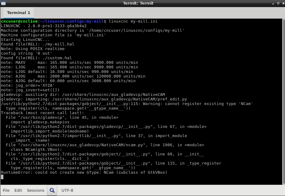

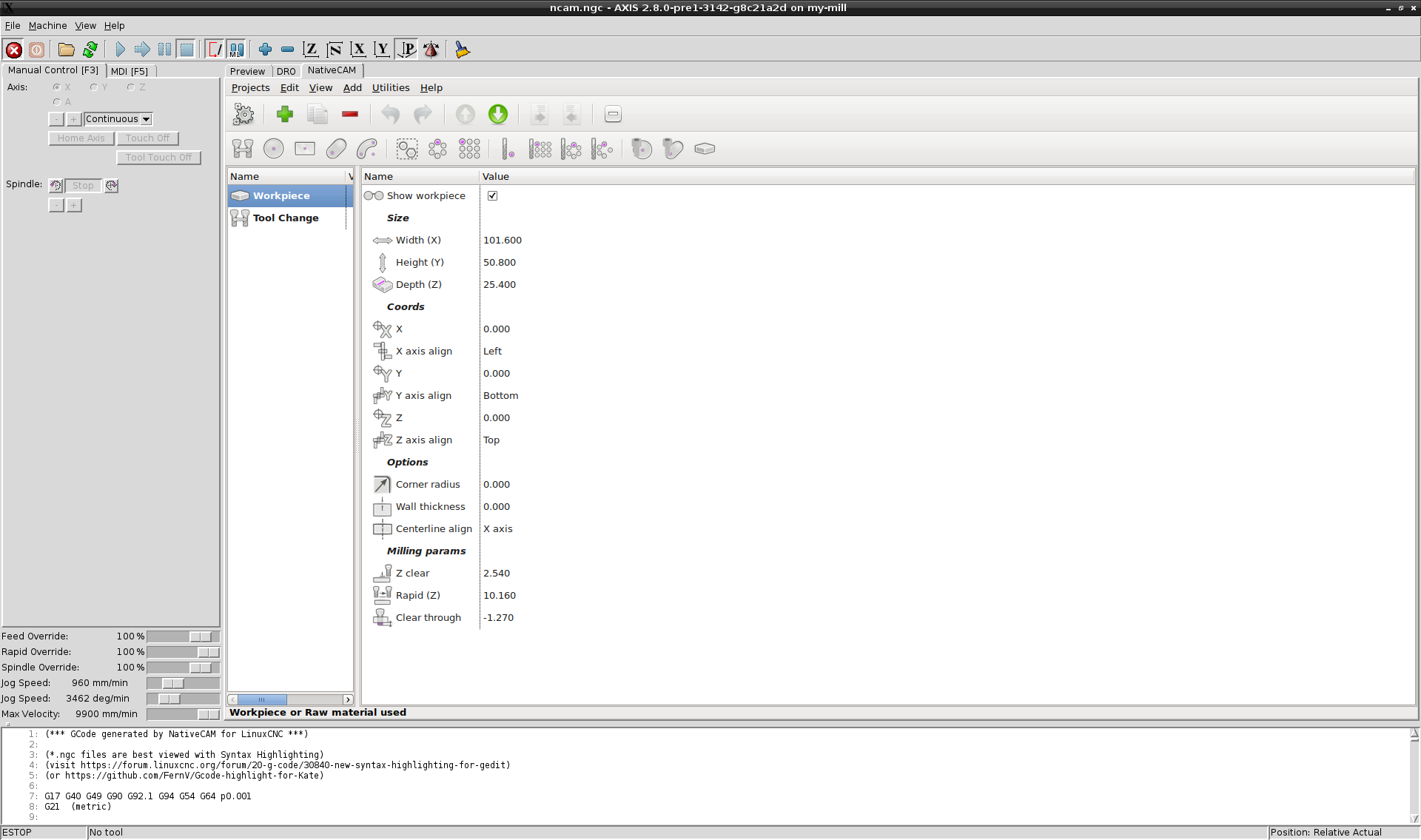

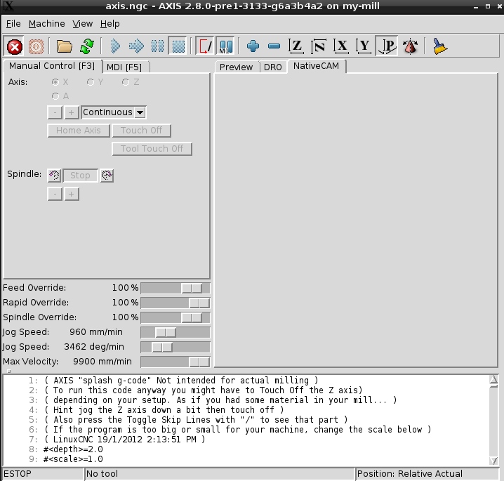

A fresh install of complete system, latest cloned NativeCam, created a new my-mill.ini, followed instructions in readme.md.
I now have the same blank Nativecam tab that I already had.
Nativecam works fine in stand alone but will not be seen in axis tab, I couldn't do it before and I still can't now, I know it must be me doing something wrong but I am buggered if I know what?
Thanks for persevering with me but I am sure you would like to iron out any glitches before putting it in the distro.

Thanks for posting your terminal output, I think I see your problem now...
I will do some testing and find the solution to this and let you know when fixed.
Fern

Well it does seem to me that it is distro dependant unless Fern has cracked it.
I have installed kde-full on my lappy this am. Updated kernel to latest PREEMT. Cloned the lcnc from git, cloned NativeCam and 'Voila'.
Of course this doesn't help with the other install of LXDE-core but at least I know it's not me cocking it up.

Your previous version of linuxcnc was : 2.8.0-pre1-3133
your new version is : 2.8.0-pre1-3142
Glad it works with this version
Fern
