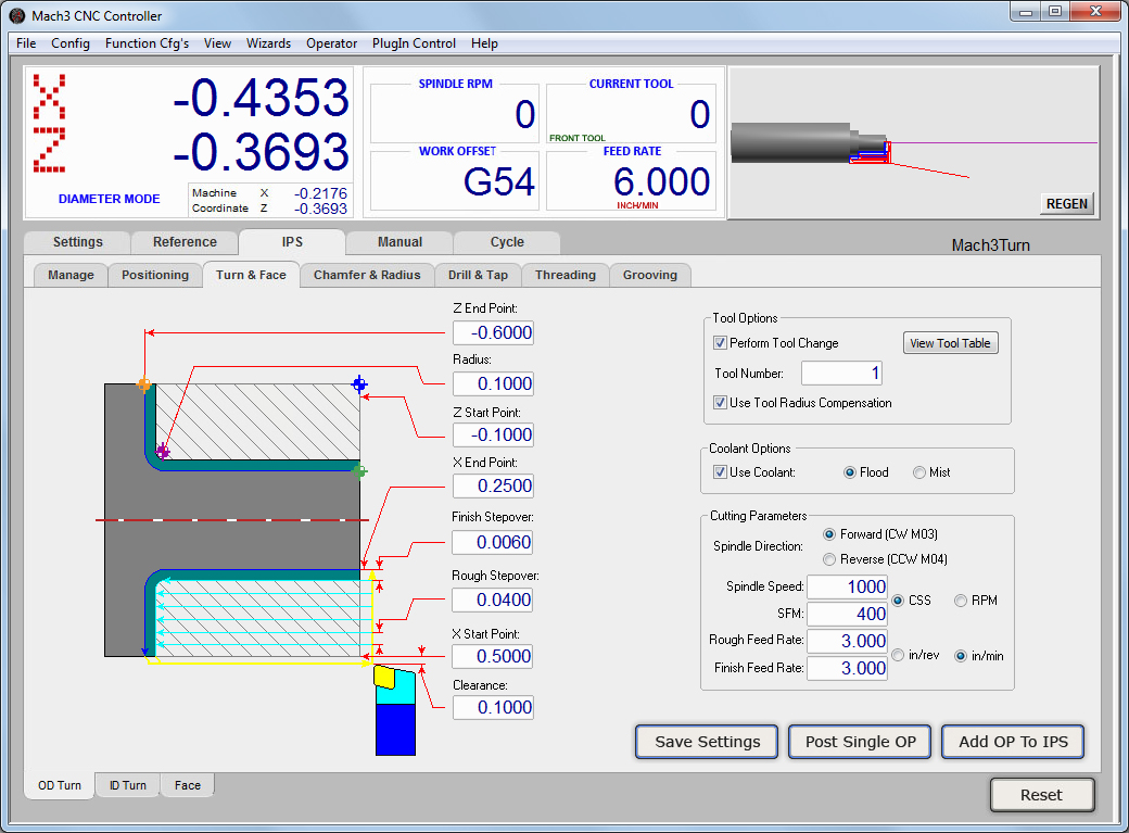

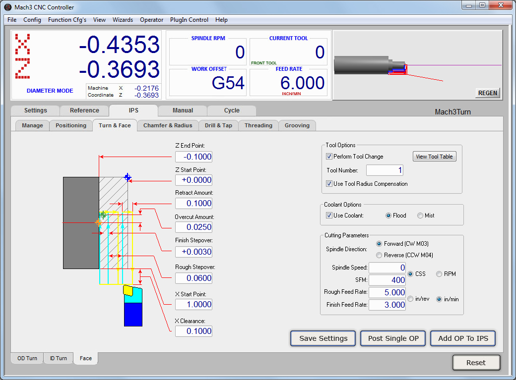

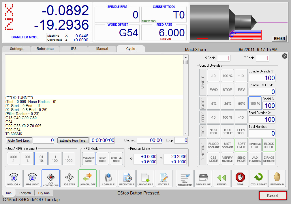

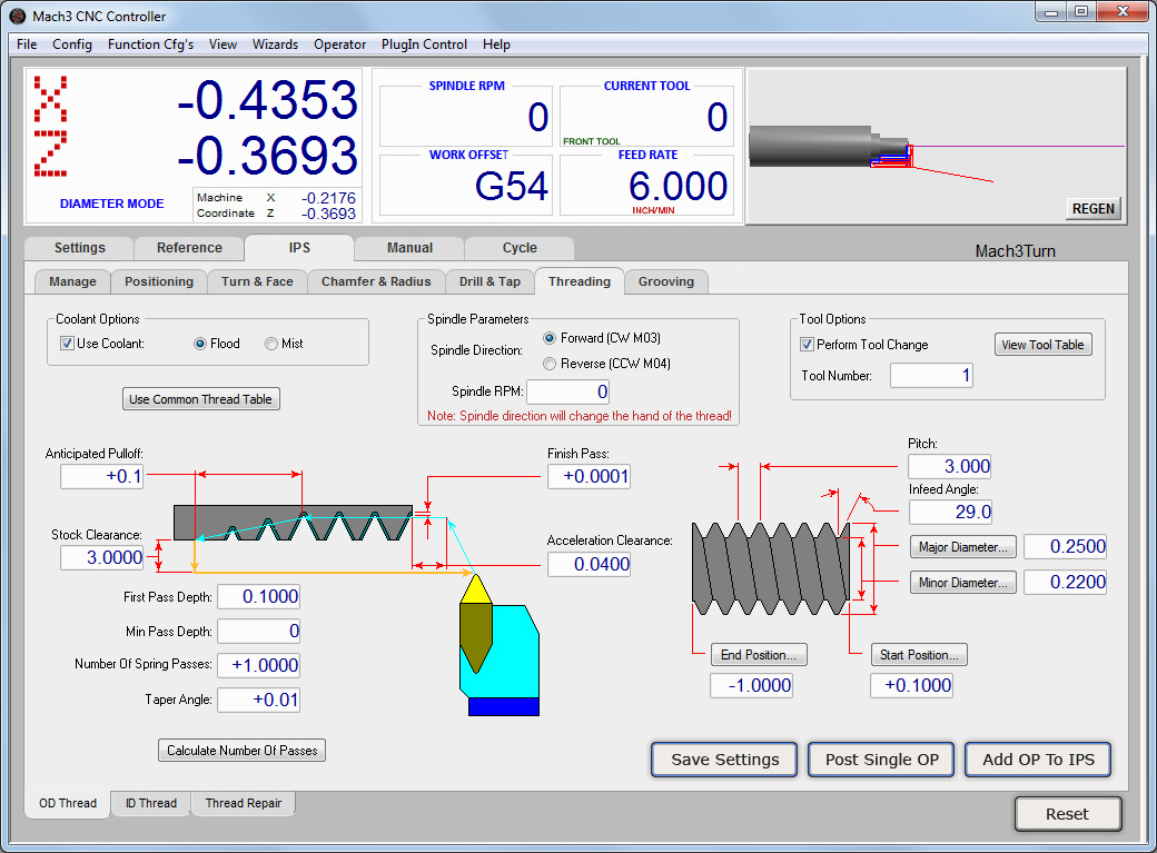

Right now I am building a full new interface based on this with a larger screen resolution. I am converting based on a screen set I created years ago for Mach 3...
