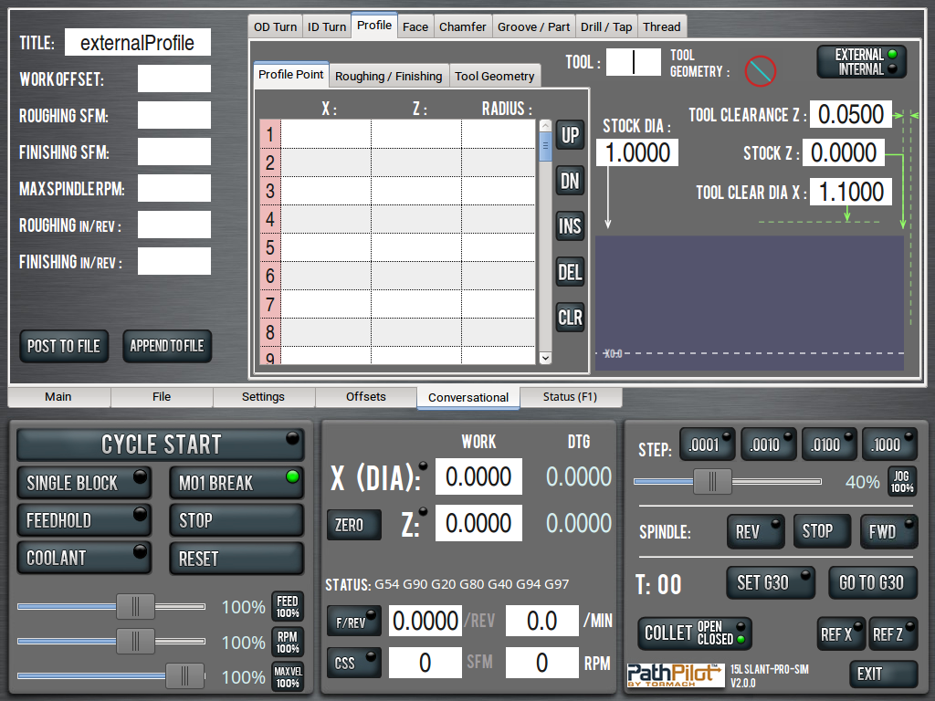

sharmstr I would love to know what version of linuxcnc they are using? I would love to see some screenshots of the conversational side of lathe. I hear they added profiling. I also remember them saying they were adding lathe canned cycles such as G71. Love to see it that was done.Any other changes that seem worthy of conversation that were not listed in the release notes would also be welcome. I am sure tons under the hood has changed.

Thank you so much for posting that. That is worth the $25 fee for sure! That profiling sure looks promising
I also love the sliders. Much better for a touch screen.
