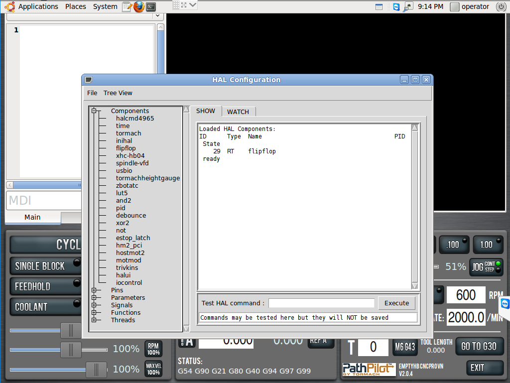

I am desperately needing to add the missing rtlib files to pathpilot 2.0.2 such as classic ladder, mux16 etc. I am unable to build or find the correct ones. I even tried installing Linuxcnc 2.8.0-pre1-3696-gcb7d6bc onto the pathpilot mint OS to steal the files from that install. They don't work. Can anyone help me to figure this out? I had everything working under 1.9 but I would like to upgrade to 2.0.

I think it need source code to build

Yes, I've build usercomp from 2.8 pre, load component into PP2 and it say: Shmem error. So i'm go back to 1.9

use the file command on one of the rtlib files
file filename
I'm at work so dont' have access to PP but should like something like this
file libgmpxx.so.4.4.0
libgmpxx.so.4.4.0: ELF 32-bit LSB shared object, Intel 80386, version 1 (SYSV), dynamically linked, BuildID[sha1]=b3b9f223f9680bb10b538432d3f0ecc37334b647, stripped
see if the rtlib file is 32 or 64 bit. you could have a mismatch in that.
you also have to be built for the same kernel so be sure your modules are built for the kernel PP is running
you'd want to build linuxcnc from source with the same realtime component that PP uses. if not that's another mismatch.
I do have a request into tormach about the source code. will see what they say

@smgvbest, here is what I get for the 2 files...
Original PP 2.0.2 file:
LinuxCNC 2.8 pre 1 file:
abs.so: ELF 64-bit LSB shared object, x86-64, version 1 (SYSV), dynamically linked, BuildID[sha1]=1b9d23bdae9856a0afeb8576ed9fc5b4807e938c, not strippedLinuxCNC 2.8 pre 1 file:
abs.so: ELF 64-bit LSB shared object, x86-64, version 1 (SYSV), dynamically linked, BuildID[sha1]=0aee5c9eb9968602144454c50ee6f44d2a6e0888, strippedPlease Log in or Create an account to join the conversation.

I looked at the source of the old 1.9 version of PP and the source of the current LinuxCNC and do not see any changes made to the .comp files source. I am not sure whats required to compile these on the kernel that PP 2.x runs on. Is the rest of the source for PP2.x required to compile these? I am kinda lost at this point
