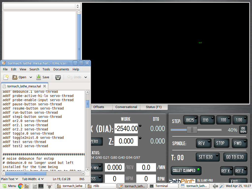

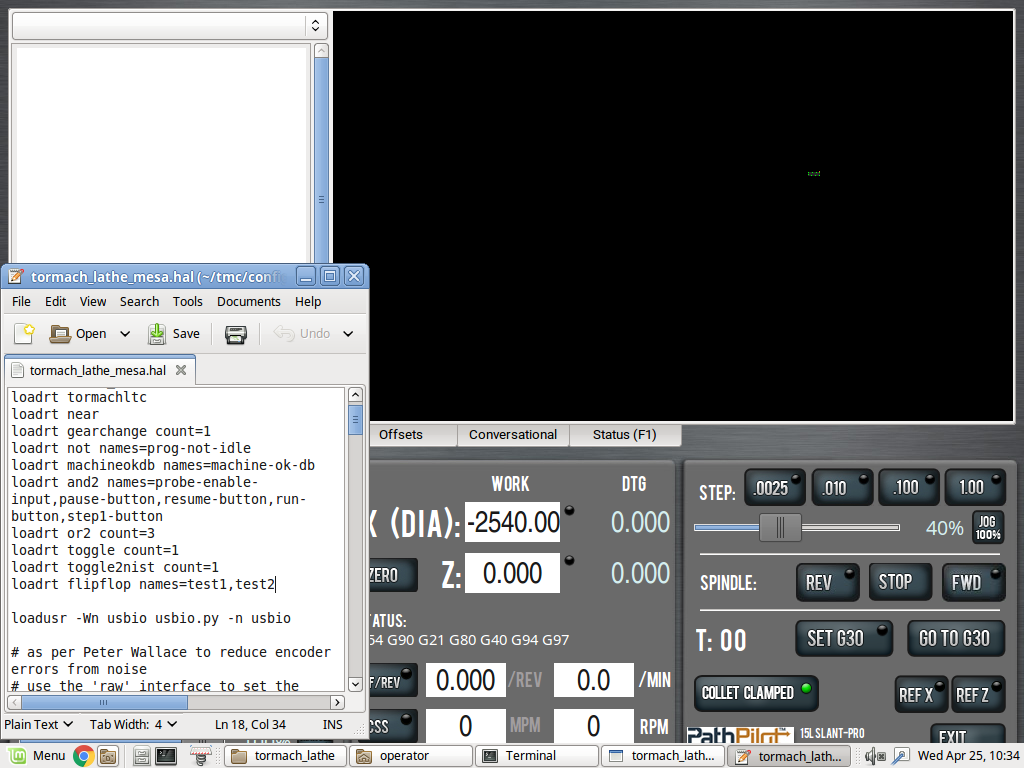

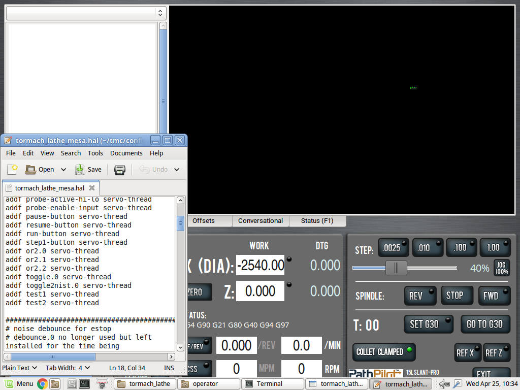

So does adding two instances of a component.
Replied by Stigoe on topic PathPilot 2.0.2 adding rtlib's

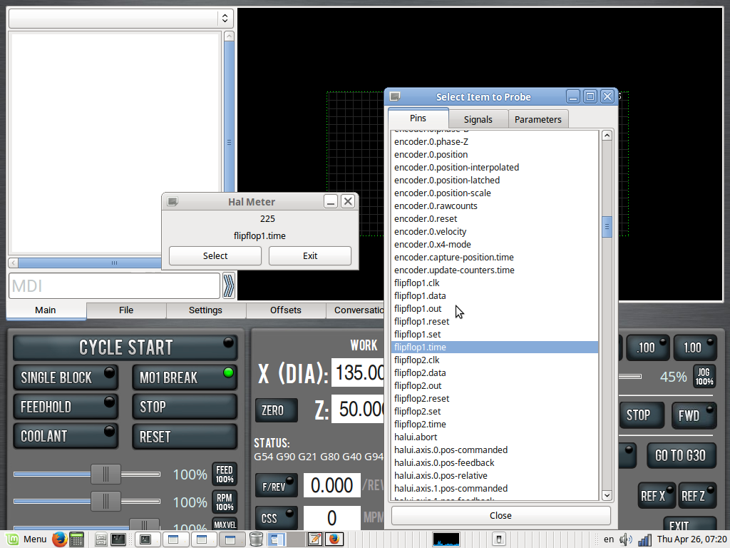

Works for me.Can you try with flipflop? I can confirm all rtlibs can load with "count=n" parameter but if using "names", addf function will not work after.
Last edit: 25 Apr 2018 15:38 by Stigoe. Reason: Adding another example

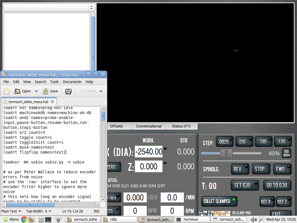

Here's all step i'm doing:
1. Make folders in home directory by structure:2. Clone linuxcnc3. Build linuxcnc4. After build completed, copies missing rtlibs from linuxcnc/rtlibs to ~/tmc/rtlibs
repos/tormach_linuxcnc $:cd repos/tormach_linuxcnc/
$:git clone git://github.com/linuxcnc/linuxcnc.git linuxcnc $:cd linuxcnc/src
$:./autogen.sh
$:./configure --with-realtime=uspace
$:make
Last edit: 25 Apr 2018 18:23 by emptyhb.

I'm switch back to 2.7.12 version
Then repeat all steps again, but nothing different.
But, i found: if i comple .comp file with "halcompile --install" the file size of rtlib (compiled comp) it different with default linuxcnc build.
How do you use halcompile? or you are using default linuxcnc compiled files?
$ git fetch origin 2.7
$ git checkout 2.7But, i found: if i comple .comp file with "halcompile --install" the file size of rtlib (compiled comp) it different with default linuxcnc build.
