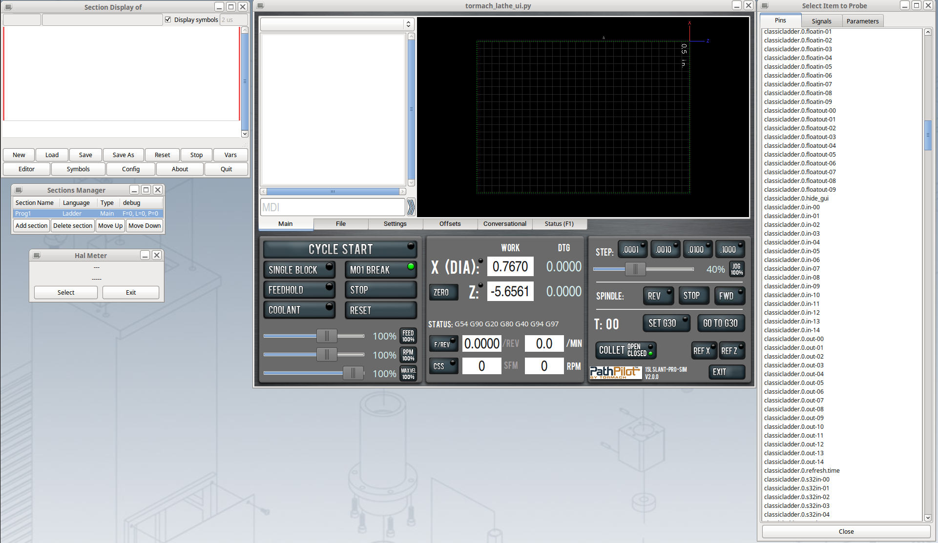

Since I can't edit my post: One thing I forgot to mention, to prevent the creation of debug-versions of the kernel, which takes a lot longer and uses a lot more space:
- Before running "make" to compile the kernel, run "scripts/configure --disable DEBUG_INFO".

Please say, does it work XHC-HB04 in PathPilot 2.0 ?
What it takes to work ?

Should be the same as linuxcnc. Just add this module to the "rtlib" folder in your current install version number and edit the config file in the "configs" folder

Pretty happy camper

@dinkata: can you confirm this method working normal?
example rtlib toggle2nist is addedthe code above not work
but it work if using
All missing rtlibs from pathpilot have issues with "names" parameter
loadrt toggle2nist names=tgn1,tgn2
addf tgn1 servo-thread
addf tgn2 servo-threadbut it work if using
loadrt toggle2nist count=2
addf toggle2nist.0 servo-thread
addf toggle2nist.1 servo-threadAll missing rtlibs from pathpilot have issues with "names" parameter

unfortunately I do not have this component !
I have extra :
classicladder => work ok
charge_pump => work ok
Replied by dinkata on topic PathPilot 2.0.2 adding rtlib's
you want me to try?can you confirm this method working normal?
I have extra :

Can you try with flipflop? I can confirm all rtlibs can load with "count=n" parameter but if using "names", addf function will not work after.
